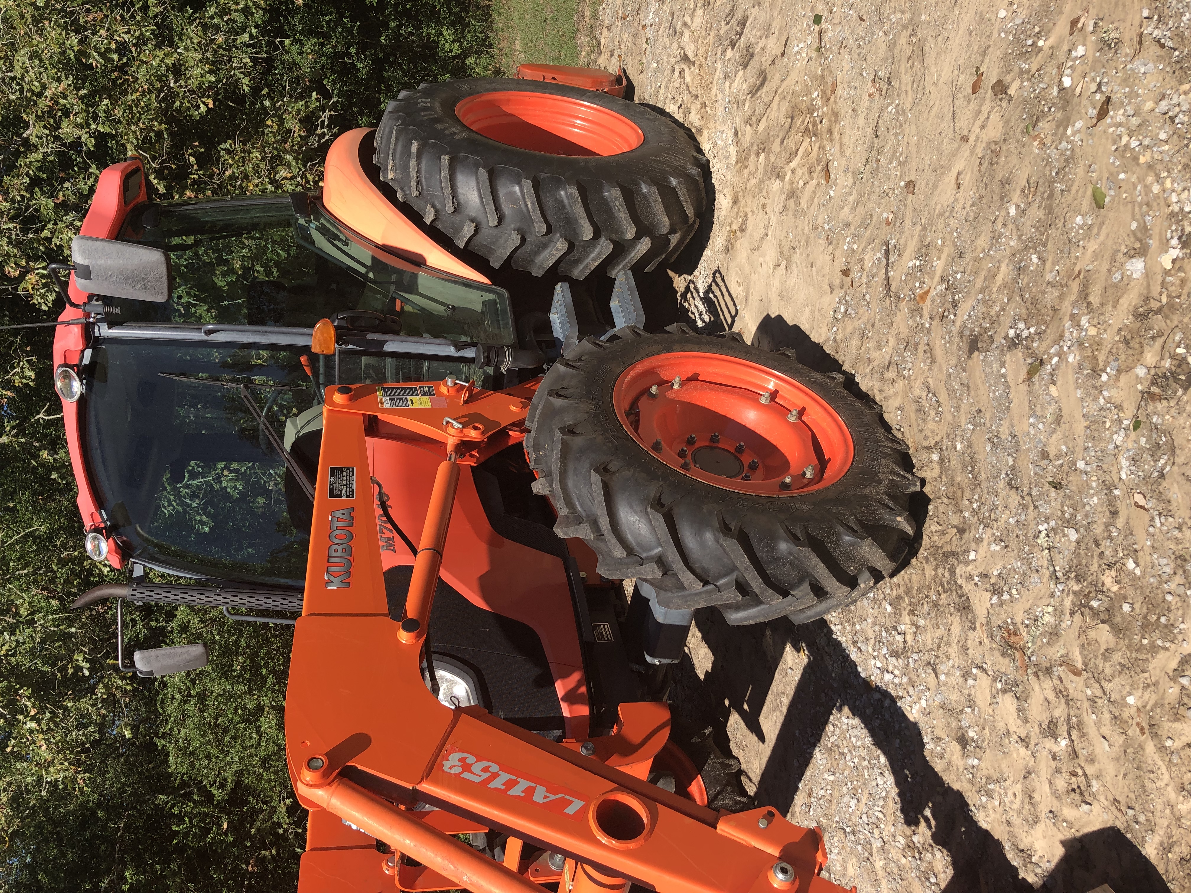

Just wondering if anyone has anymore updated information on whether they have swapped to the larger front tires on a 7040 or 7060 and if they have had any problems?
Thanks
   / New7040 tire option
#60
6E7C77EA-2B34-4B8F-AA9B-908574F4A766.jpeg just bought new set fronts. It’s been around 8yrs and 1400+hrs, no issues to date.
