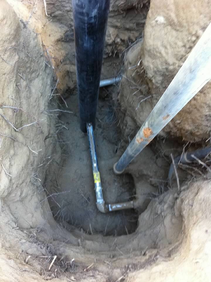

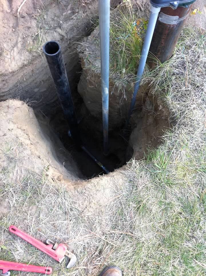

Yes, it’s fine to connect at the well end. I was fortunate to find an unused end of a T fitting to tap my shop line to. It was 3 ft deep. The thicker black pvc pipe on the left was notched at the bottom and fitted over a street valve. The top end of the pipe was glued to a female fitting with a screwed cap. The bottom & sides at the base is all gravel. This setup allows me to unscrew the cap and lower the shutoff tool should I need to cut off the shop line.

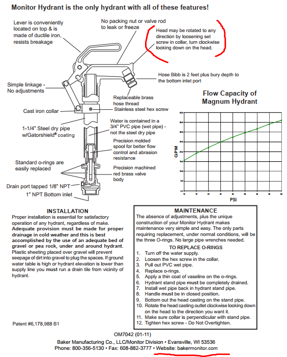

One more consideration to installing a freeze proof hydrant.
If you have heavy soil that doesn’t perk well be sure to provide plenty of opportunity for the back wash to drain away when the hydrant is opened and closed in freezing weather. I usually drop a 10’ long piece of perforated drain tile capped on the outboard end and covered with a foot or so of pea stone as a sump to absorb the water running back down the stand pipe when the valve is closed.
