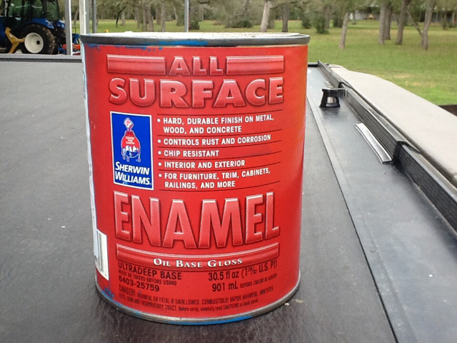

Cataclysm, can you share any pics/wisdom from your skid plate construction and installation? I've read a few posts concerning damaged filters and other misc things underneath. Seems like a very beneficial modification.
   / New XR4155HC on its way! #68
Cataclysm; Now if it was just LS Blue.......[/QUOTE said:
Here you go ...
#69
Yes, I will be happy to share. I will be taking it off soon for paint and will get pics and dimensions to post up.
I have already tested it out with the bush hog and it works perfect. Zero damage to the skid or undercarriage.
