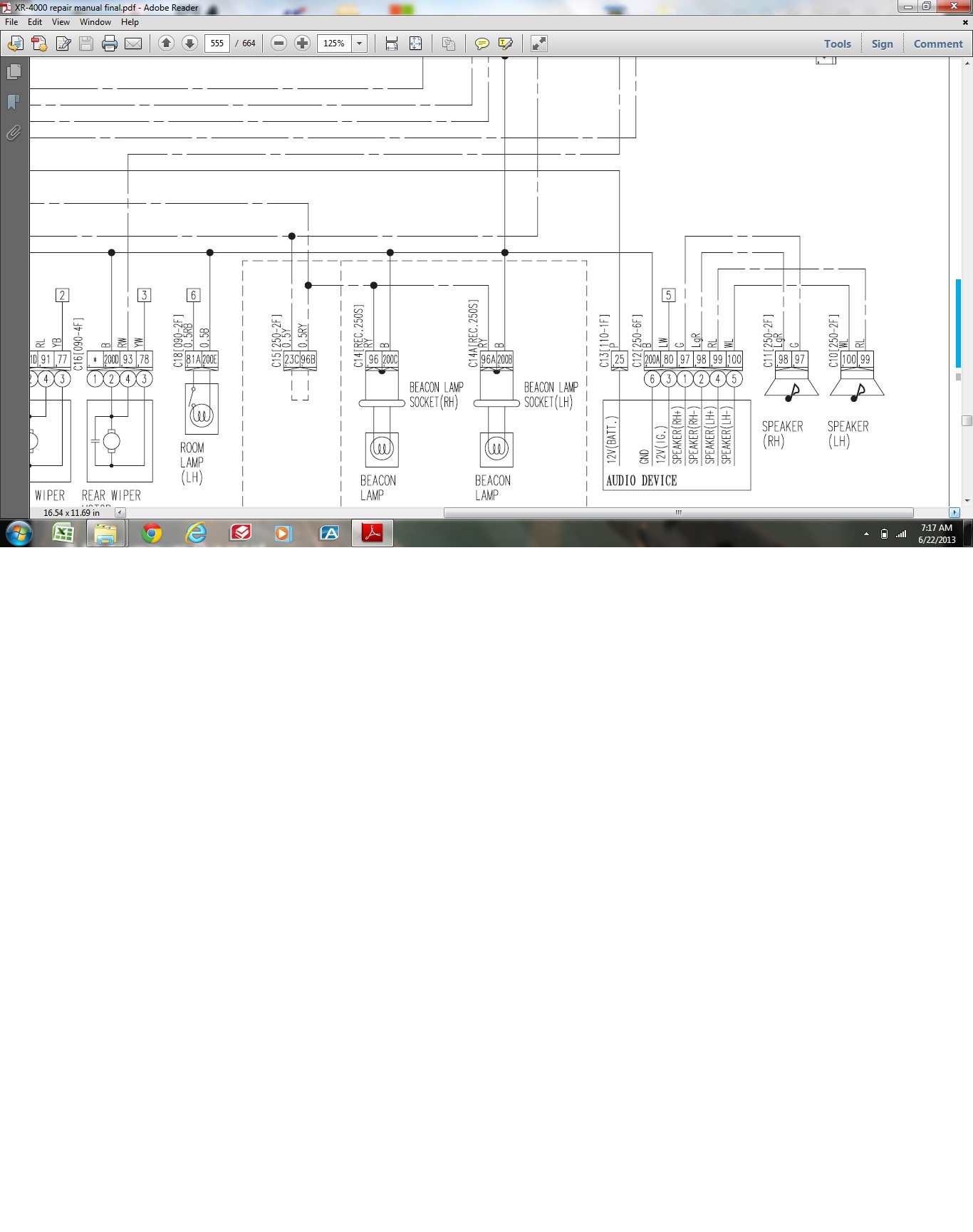

Got new xr 4046h with cab,so far so good,not sure about getting parts or filters ect here in Alberta Canada.havnt had much luck finding filter numbers yet,still waiting for a stereo plug adapter and havnt been able to find a switch for work light yet,my dealer is a couple hrs away but might have to contact them.everything else has been good.love the cab

I have the same tractor, I had the same problem, they sent me the filters from the factory, and I had to wire the the stereo from a schematic.
   / New xr4046,where to get parts in canada #4
here is the diagram that I got. it worked ok. View attachment 361534
I found the radio harness in the cab roof on mine when I had the roof tipped up to run my flashing strobe wiring. I just installed my radio today. It wasn't too bad to figure out. Just traced the color coded speaker wires back to the plug. Used a test light to determine the battery plus (to retain memory) and ignition on wires and the ground.
