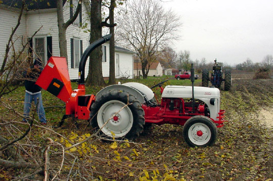

Just picked up a used Wallenstein BX40 chipper to use with my B3200. I tested it out before purchase and it works very well with freshly installed blades!
The previous owner has an 8N (nice old tractor) and cautioned me I would need an overrun clutch and threw an old one in with the purchase. This does not fit my tractor as I do not have a hole for the roll pin....
Reading around on here I suspect that I do not need one for my live PTO but thought the folks on here could coach this newbie.
Thanks
Craig
   / New woodchipper for B3200 - do I need an overrun clutch? #2
Don't know how your tractor is setup, but if you can engage and disengage the chipper smoothly, no over-run needed.
   / New woodchipper for B3200 - do I need an overrun clutch? #4
As long as your transmission is in neutral, which it will be when using a pto chipper, you do not need an orc, not even on an 8N. Philip.

   / New woodchipper for B3200 - do I need an overrun clutch? #5
You don't need it on your tractor.
   / New woodchipper for B3200 - do I need an overrun clutch? #6
your good with out it.
Seems like a unanimous opinion that I am good to go!
Thanks all for the reassurance, time to start cleaning up the brush!
