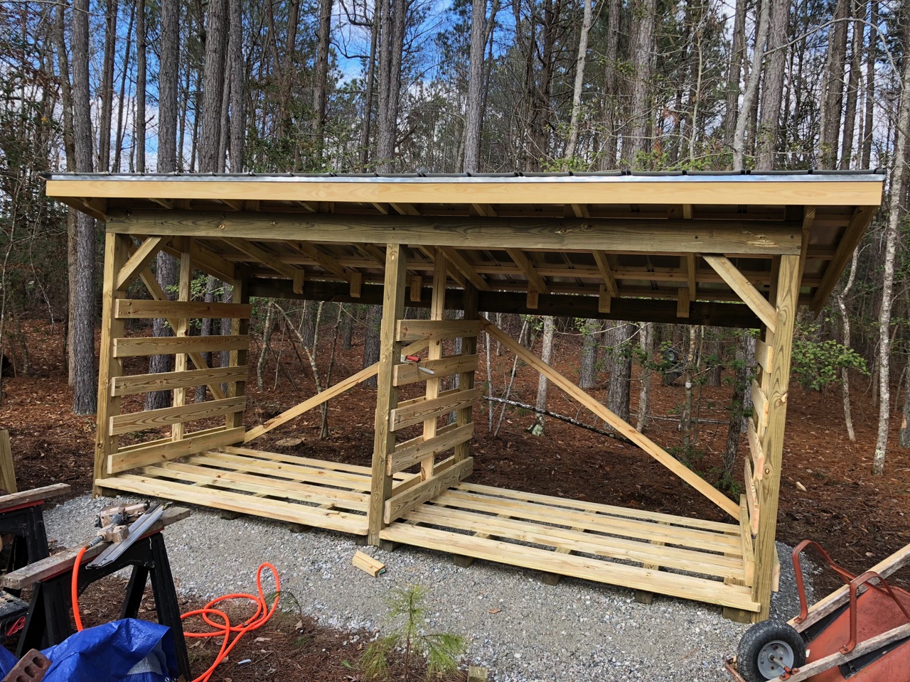

After Christmas, I got to looking at all my firewood stacks and decided to build a wood shed to try and consolidate and neaten things up in the future. I did a lot of research on the internet looking at designs and what other folks had done, and ended up going with a pole barn structure. All the designs I saw that integrated a raised floor into the structure had issues with sagging, and trying to support the weight of the firewood on the footings of the poles was really not practical anyhow (the weight of the wood far exceeded snow loads we normally design footings for). So I ended up doing a pallet-style floor that sits inside the pole barn structure but floats independent of it. It's supported by a base of compacted crushed gravel. I doubt it will settle, but if it does it won't impact the pole barn.

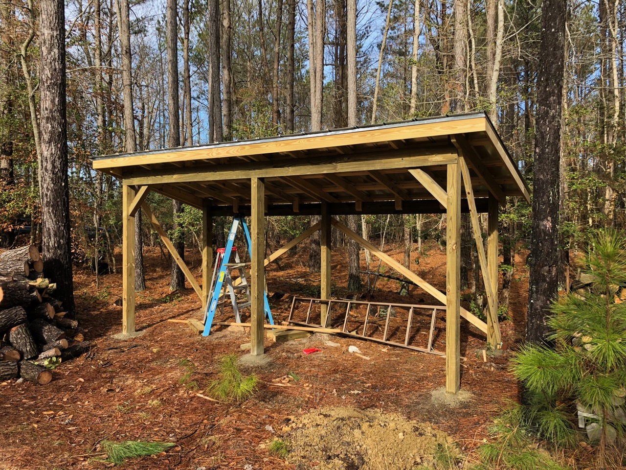

I made the structure 6' x 16' with 12" overhang all around (so roof is 8' x 18'). The roof has a 3:12 pitch and uses 5V metal. I can put three stacks of wood in the 6' depth with about 5-6" air space between the stacks. All together, this will hold about 2.5-3 cords of wood. If the shed works out well, I will build another one next year and another the year after, eventually replacing my separate stacks with three sheds.

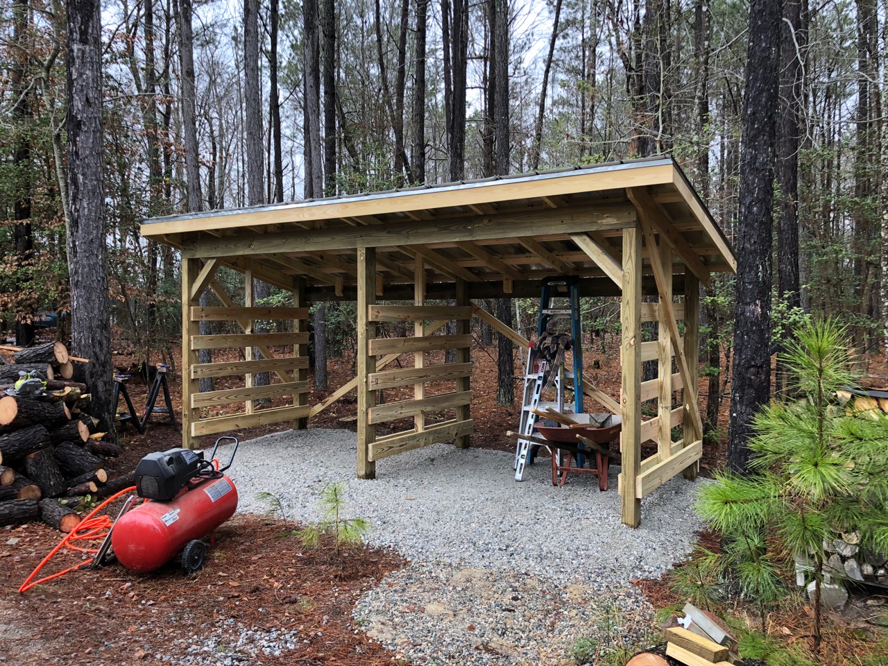

Here's the basic pole barn structure:
Then gravel base added, as well as side slats:
Finally, with pallet-style floor (floats independent of the poles):

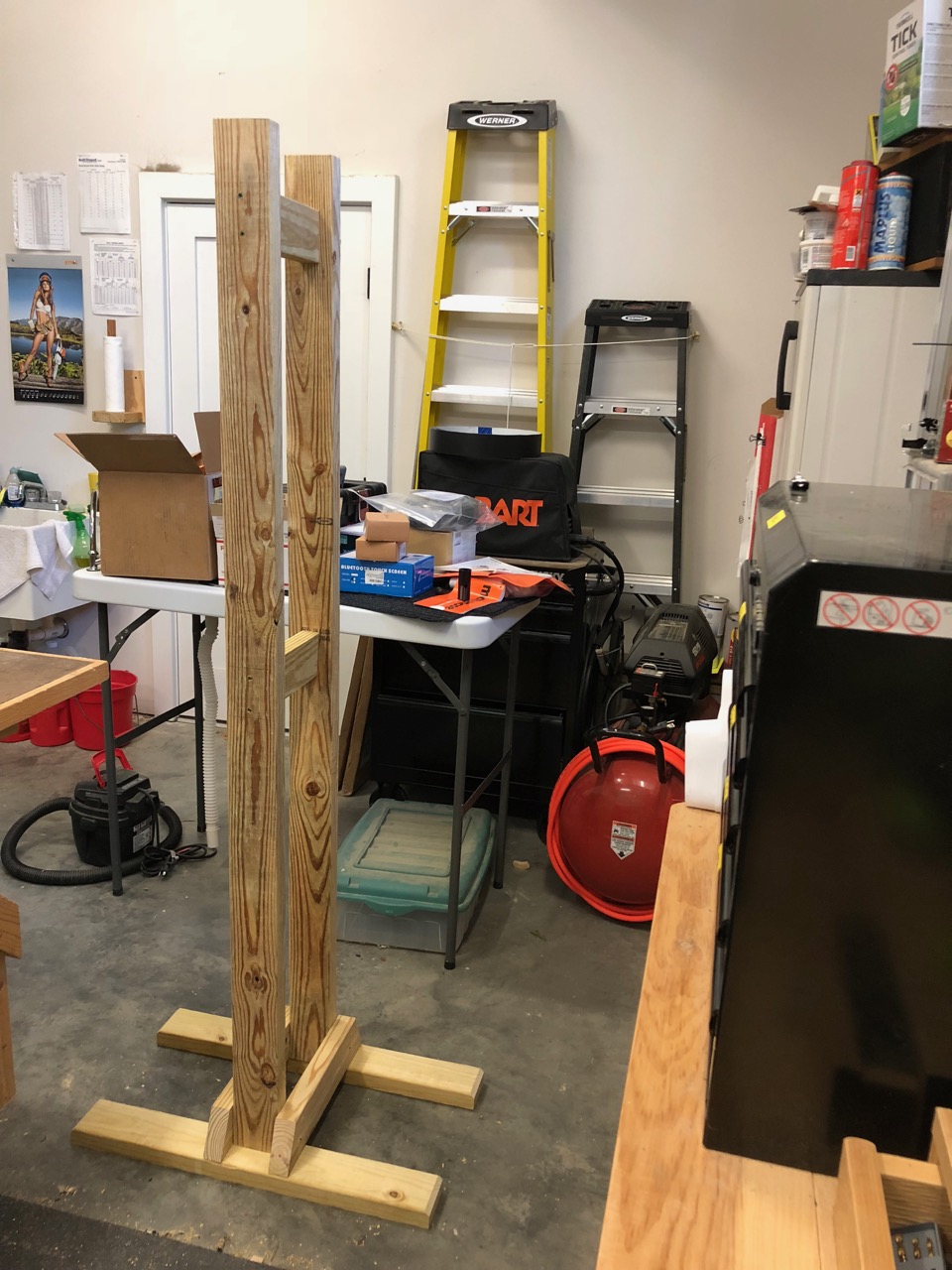

One thing I fussed over was how to divide the wood storage up so that I could work into a stack front to back and free up space for reloading. I season my wood for two years. Typically, we begin burning firewood in November, when I transfer seasoned wood to our front porch 1/3 cord at a time. Then I start reloading the newly-empty stacks with green wood (for use two years later) in January and February. So in the November-January timeframe, I want to start freeing up stacks for reloading.
What I ended up doing is making several "book end" style dividers that I can put in the wood shed and use to divide up a stack into 4' wide sections. With a divider on each stack, I can clear out a 4' section, front to back, and make it available for reloading. Not sure this is the best solution, but time will tell. Since the dividers are not fixed in place, I can move them out of the way when working front to back and only set them in place as needed to reload.

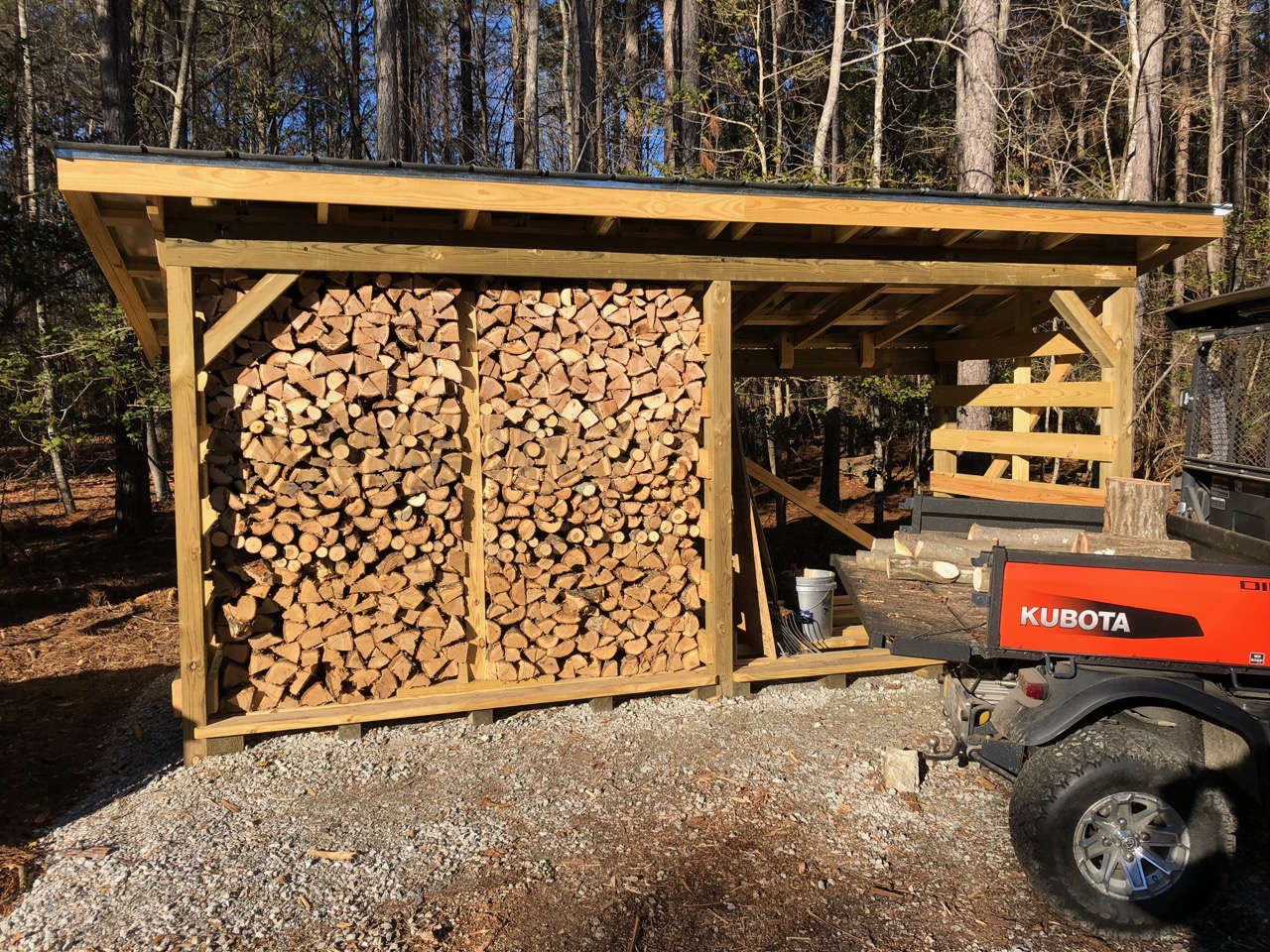

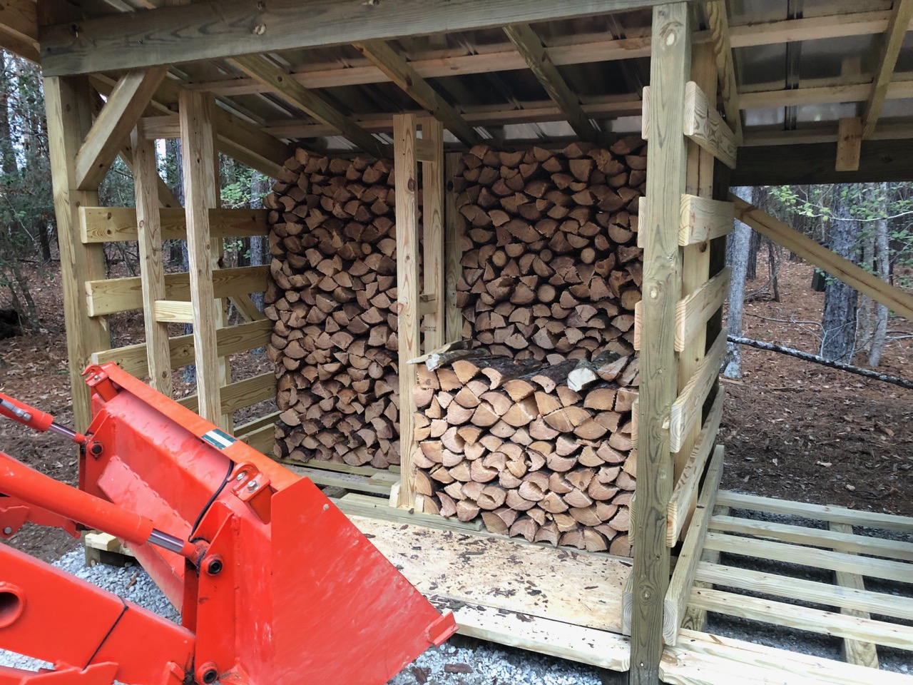

Finally got the first side filled up today, that's about 1.3-1.5 cords.
Already, I am wishing I made this a three-bay shed, which might have helped me manage inventory and reloading better on a two year seasoning schedule. With three bays, I could have a bay for this year (burn now), next year (burn in 1 year), and green wood (burn in 2 years) and not have to fiddle with freeing up space to reload wood. That would leave one of the bays empty over the summer, but I'm sure I could find a use for that.
Anyhow, that brings me to my question -- those of you with wood sheds, how do you manage seasoned wood and green wood and rotate your supply? I am so used to working with single 1/3 cord stacks out in the open that I am left scratching my head at the best way to rotate supply in a shed where you're stacking several rows deep.
Arrange your stacking so you can always use the first in/first out principle. If there is only one access point you will probably lose some space to circulation. Two opening ends solves that.
