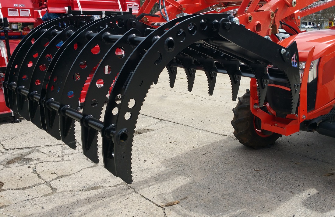

The new Wicked 60 has finally made it's way onto a tractor!! First stop is our Kubota L6060, but Ted will be testing it on something a bit larger!
Check out that full 40" opening.
Travis

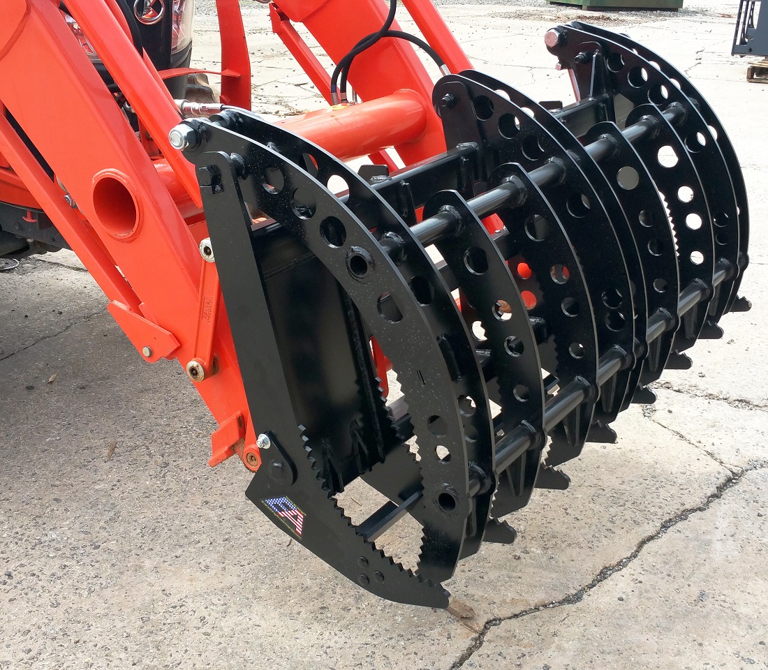

A little about the material used in this Beast. The serrated upper and lower tines you see are laser cut 3/8" thick AR400. We don't just use regular pipe to join the tines and form the hinges. The round material is actually DOM tubing, which has a higher tensile strength and yield strength than regular pipe. Things like this cost more $$, but money is far from the first thing we consider when designing our grapples for you guys!!
Travis

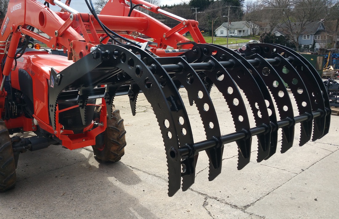

A few more shots of the Wicked 60 on the L6060!!
Travis
