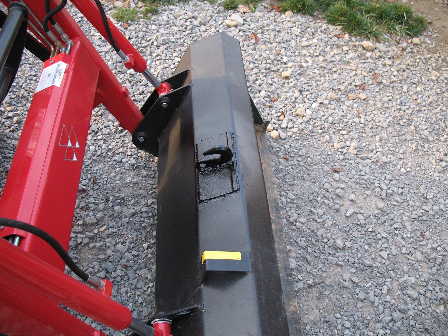

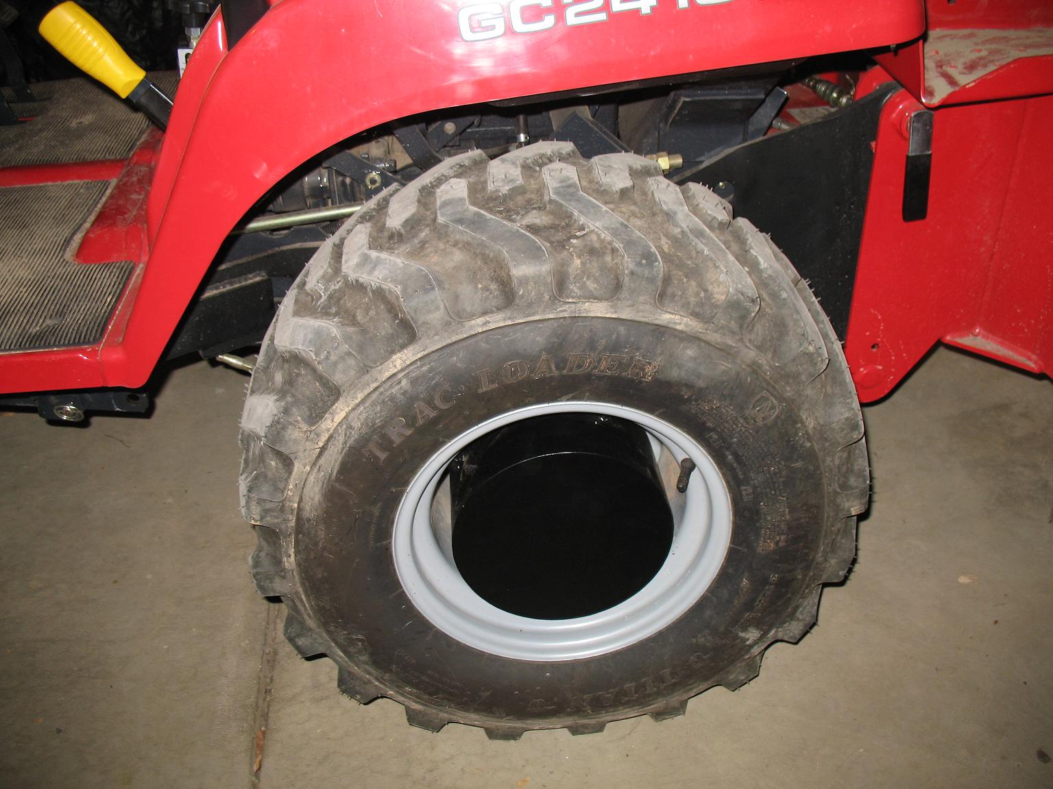

Here are some pictures of the new homemade wheel weights and the hook I welded on the bucket of the GC2410.
I'll post a few more pictures of the wheel weights in the customization forum.

Good Mornin Johnny,
Nice job on the weights, any idea how much they weigh?

So Johny, how did you make those? That is one big chunk of steel. Why did you opt for wheel weights rather than filling your tires?

The hooks are great, i have 1 on each side, and 1 in the middle. Soo usefull

   / new wheel weights and and hook on the bucket
Good Mornin Johnny,
Right around 74 pounds (based on my calculations):
diameter (inch) = 8.5, length (inch) = 4.6, area (sq in) = 56.745, volume (cu in) = 261.027, density of low grade steel (lb/cu in) = 0.283 -------> mass (lb) = 73.870.
My Father (God rest his soul...passed away this past January) had all kinds of "stuff" around his garage, so I got the bolts and solid steel cylinders for free. I was actually planning on filling the tires with washer fluid, but for the price of a few cans of primer and paint and a handful of welding rods, the price was right for the steel weights.
