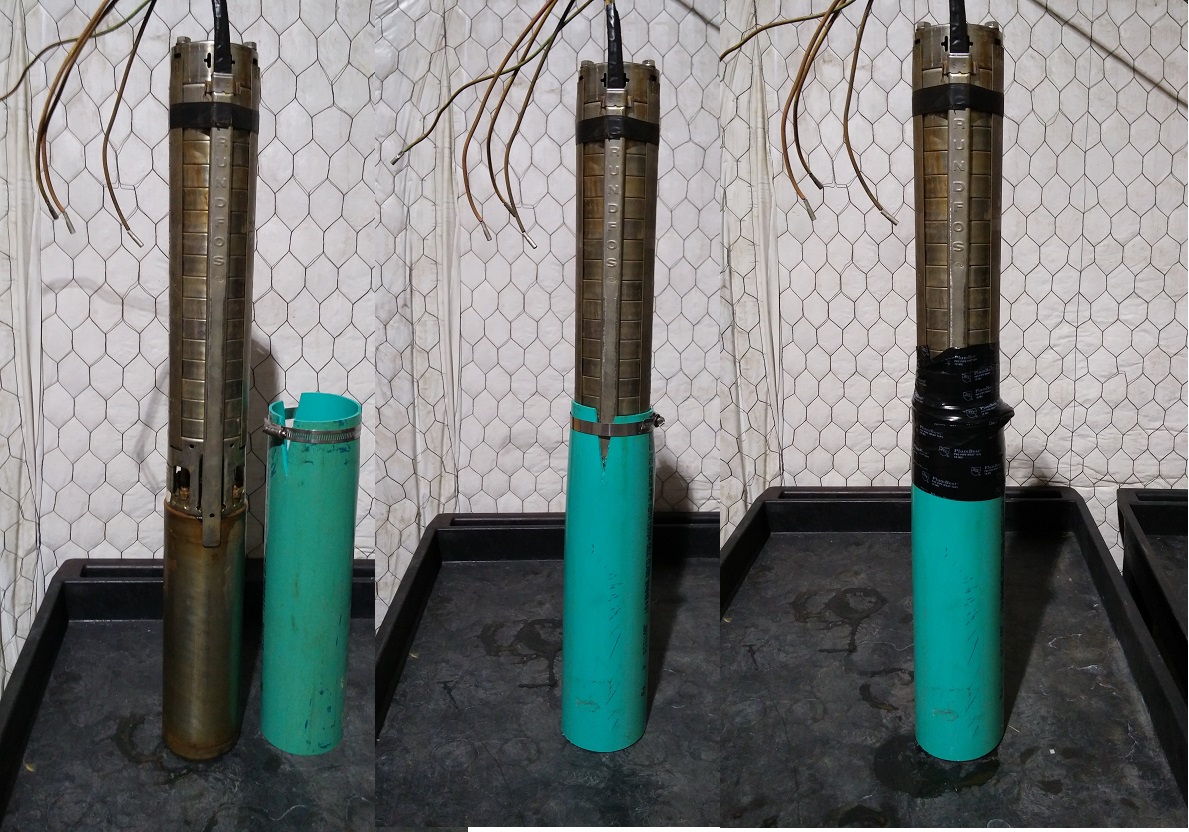

Hopefully the driller has done this a few times and knows the best way. Everybody else is just guessing, even though they maybe good guesses. PVC won't rust out or rust up the perforations like steel. But some wells require steel because of the depth or problems with the formation. Use as large a casing as needed to put in a regular 4" pump because the little 3" pumps cost more and don't last as long. I like 5" PVC so I can put a 4" flow inducer shroud on the pump, as the shroud will make the pump last longer.
