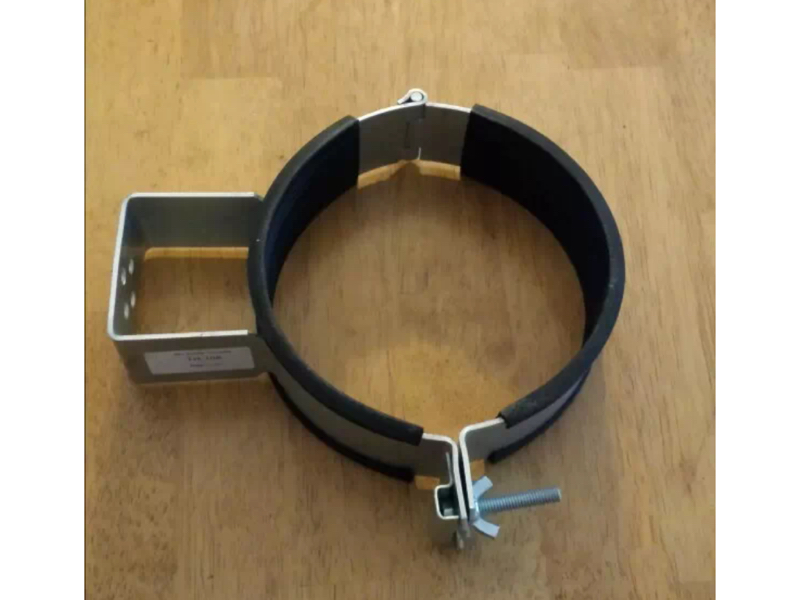

And one of these to secure the bottle. If you do you may want to add a backing plate on the inside wall of your cabinet where you bolt it on.
Terry
Terry - can you post a link on where to get that band clamp? Hopefully it's not one of those "you can only get it in Canada" items. :)
THANKS!!
/ New welding cart (sort of) #26
Terry - can you post a link on where to get that band clamp? Hopefully it's not one of those "you can only get it in Canada" items. :) THANKS!!
Here you go, Mark. They are available in different diameters. Not available in Canada as far as I could see.
I modified propane bottle brackets with the over centre clamp mechaniism on my carts. I will take pics when later.
Hope this helps. 4B's Bracket Bu Th-112 Tank Holder (344-TH-112) Category: Cylinder Carts and Trucks - Gas Welding Equipment - Amazon.com

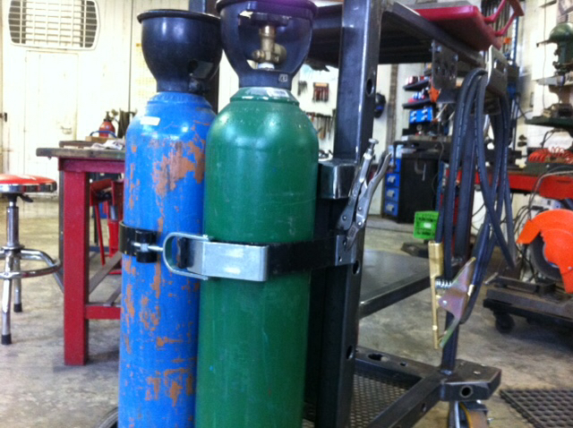

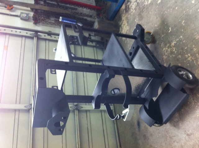

Mark here are photos of a cart I built last year utilizing the propane tank clamps. image-2984715877.jpg image-3283092375.jpg image-3061567809.jpg Terry
Edit: no idea what's up with two sideways photos. :(
/ New welding cart (sort of) #28
Another welder cart and oxy/acet cart. I really don't like tanks rattling around. Terry
