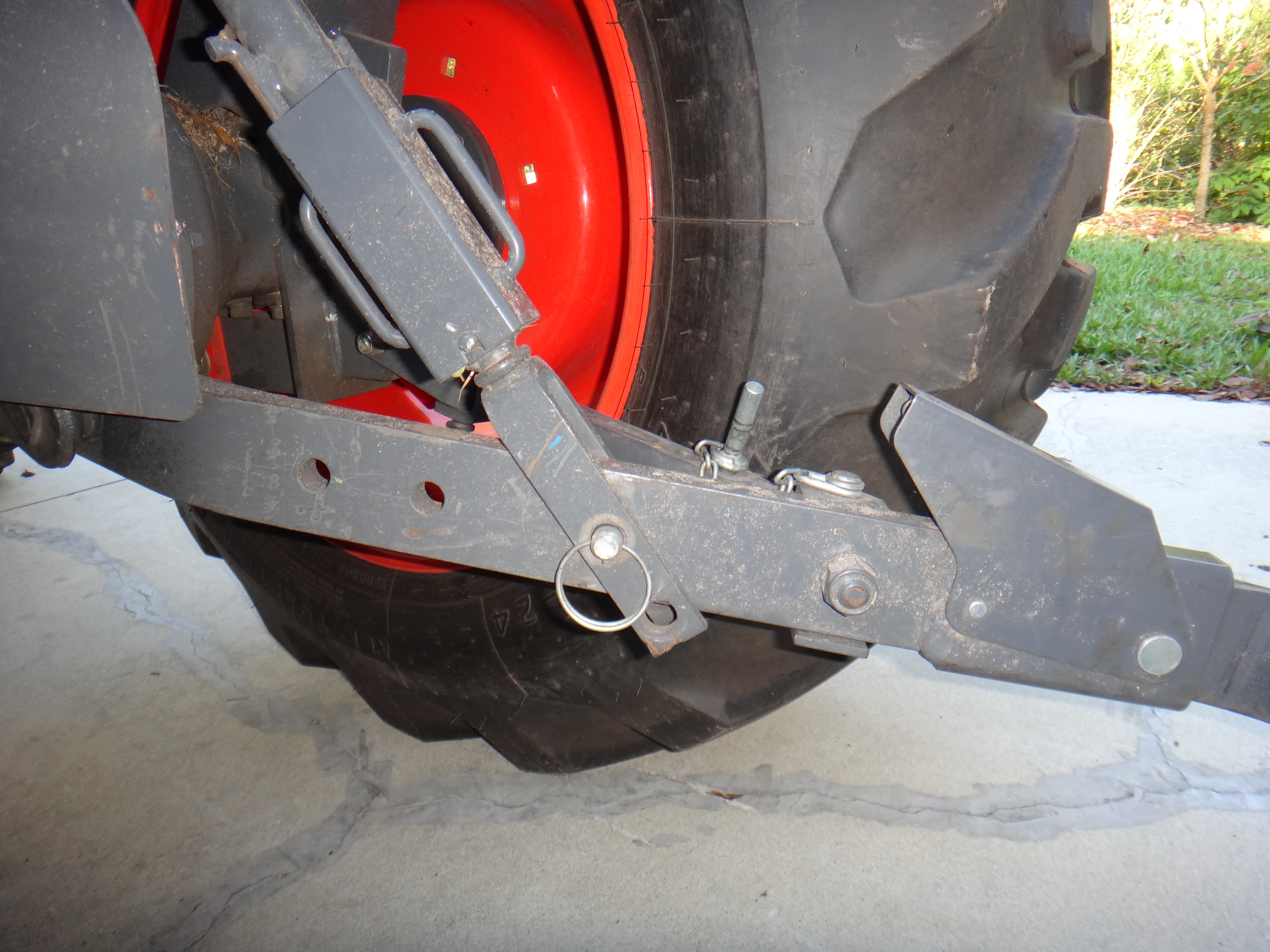

/ New Wallenstein BX42 owner #6
You can change the pin adjustment which connects the right and left Lifting Roads to the right and left Lower Links from the higher pin hole to the lower pin hole. Your chipper will set about 5" lower.
I am of the opinion Wallenstein has designed chippers this way so it is more difficult to plow with them when reversing the tractor.
Photo #1 - Top hole - default adjustment.
Photo #2 - Lower hole. Note lower angle of Lower Link.
