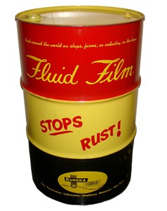

Another vote for sheep lanolin.
I've a place in very rural Mississippi. 40 years ago yards around here were often littered with old washing machines, old vehicles, etc., slowly rusting and returning iron to the soil.
Since I started moving down here 10 years ago I've adopted the practice of always having a spray can of Fluid Film handy. I spray my tractors when I see an uncovered spot, I work on a piece of equipment I'll give it a quick shot at the end. I spray my saw tables. I spray locks and hinges often.
I've gallons of it to underspray my vehicles.
They've come out with a thicker variation for vehicles, called Wool Wax.
Sure beats running over sheep to undercoat your truck.
