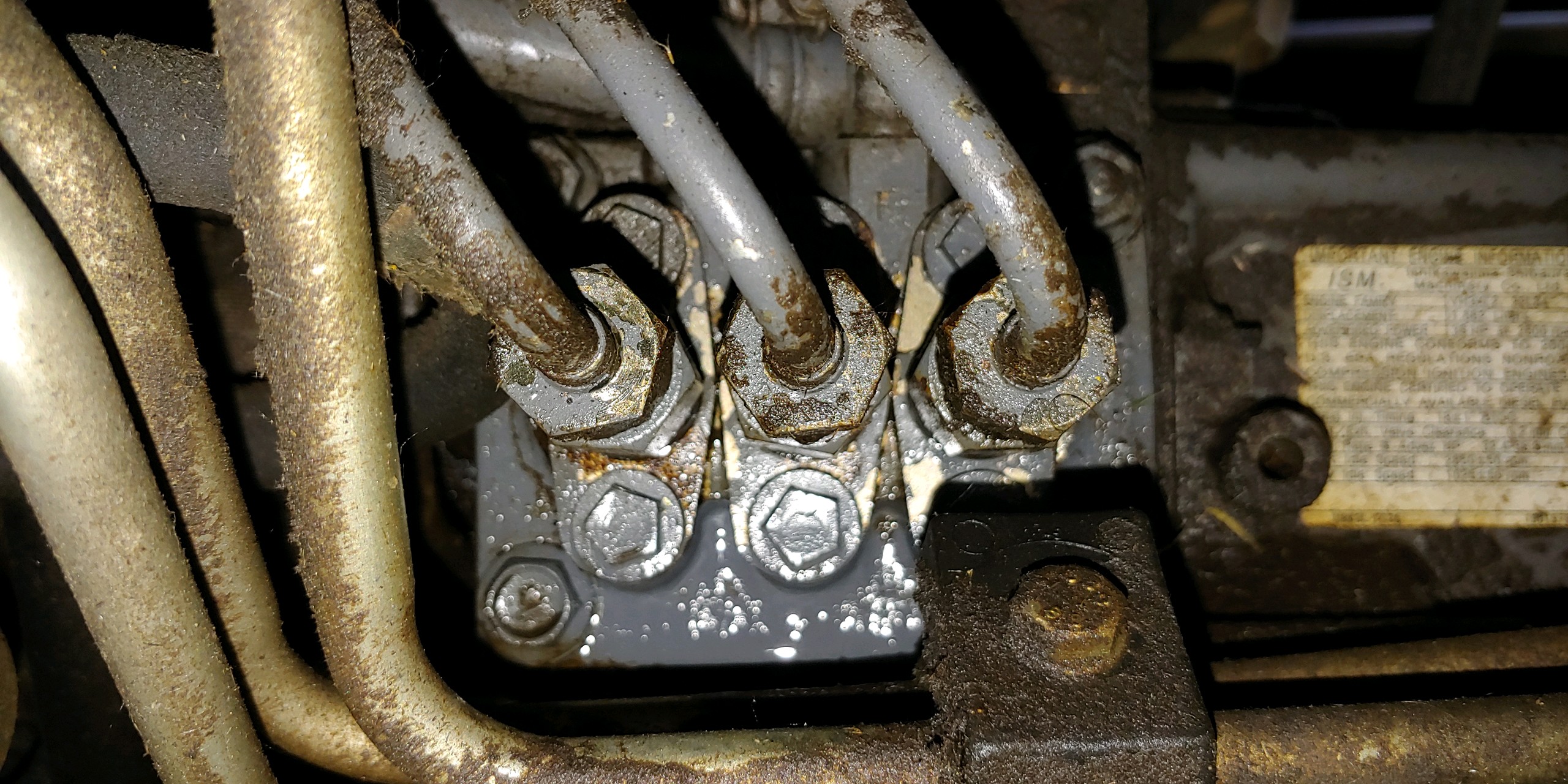

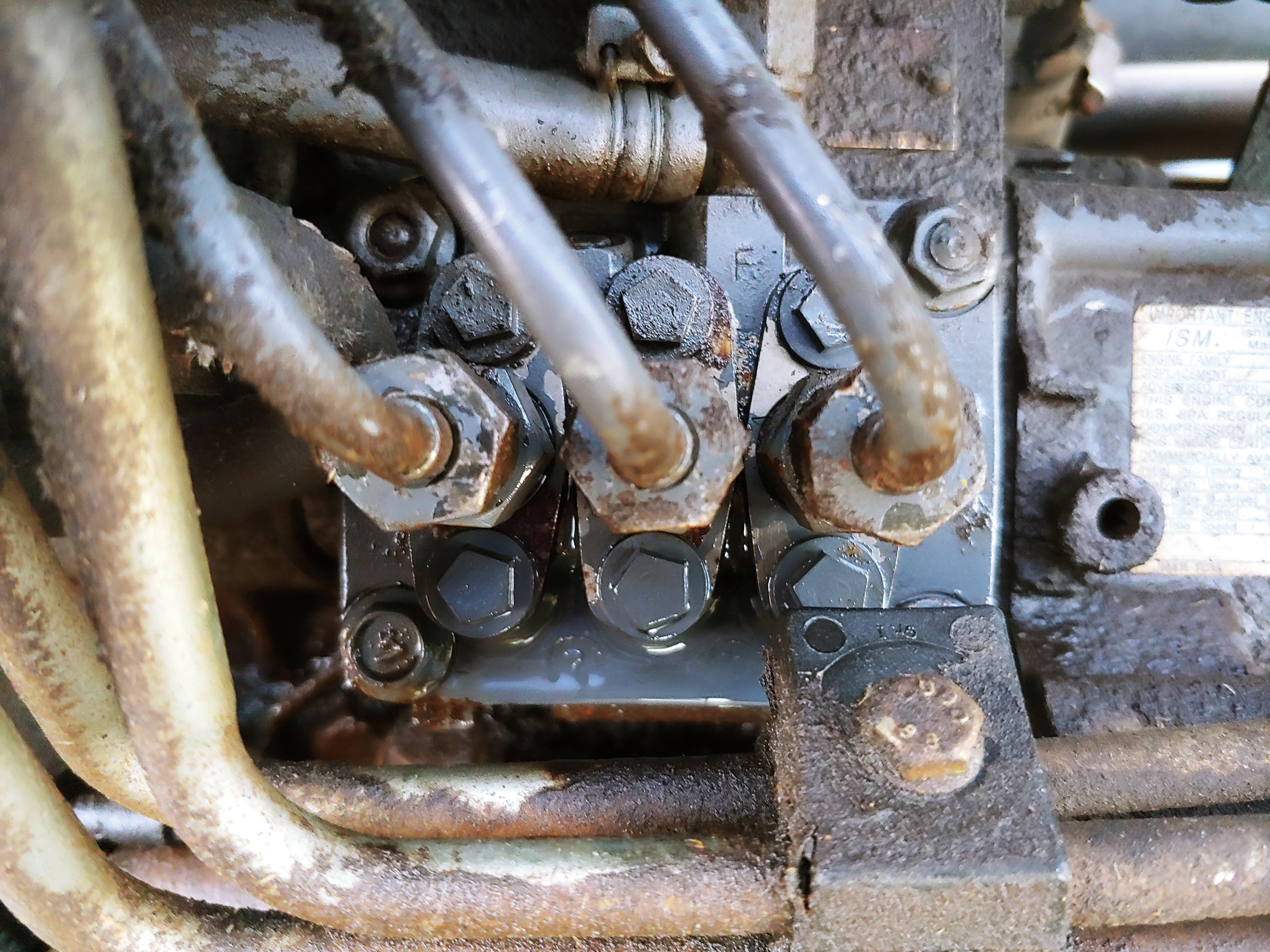

Long story short, been interacting off an on with this tractor for quite a while, but the owner decided to get a new one, so I picked it up at a good price. It hasn't been treated all that well, but I'm hoping to turn that around. The issue I have is that there is a leak at the fuel injector pump. I used to turn wrenches a while back, but haven't in a number of years. It seems like it may be leaking around the ports, and it leaks enough to cause about 1/3 of a gallon overnight. As soon as I dry it, within 10 seconds or so, its back to looking like this. I don't know whether thats an injector pump rebuild, or if it could be that someone ran it dry and was trying to bleed it to get it going again and didn't tighten, or overtightened etc. Everything is tight for sure. I read a few things about the o-rings below the plate being an issue, and if it needs that it'll be sent out, but hoping its something simpler! Anyone seen this?
