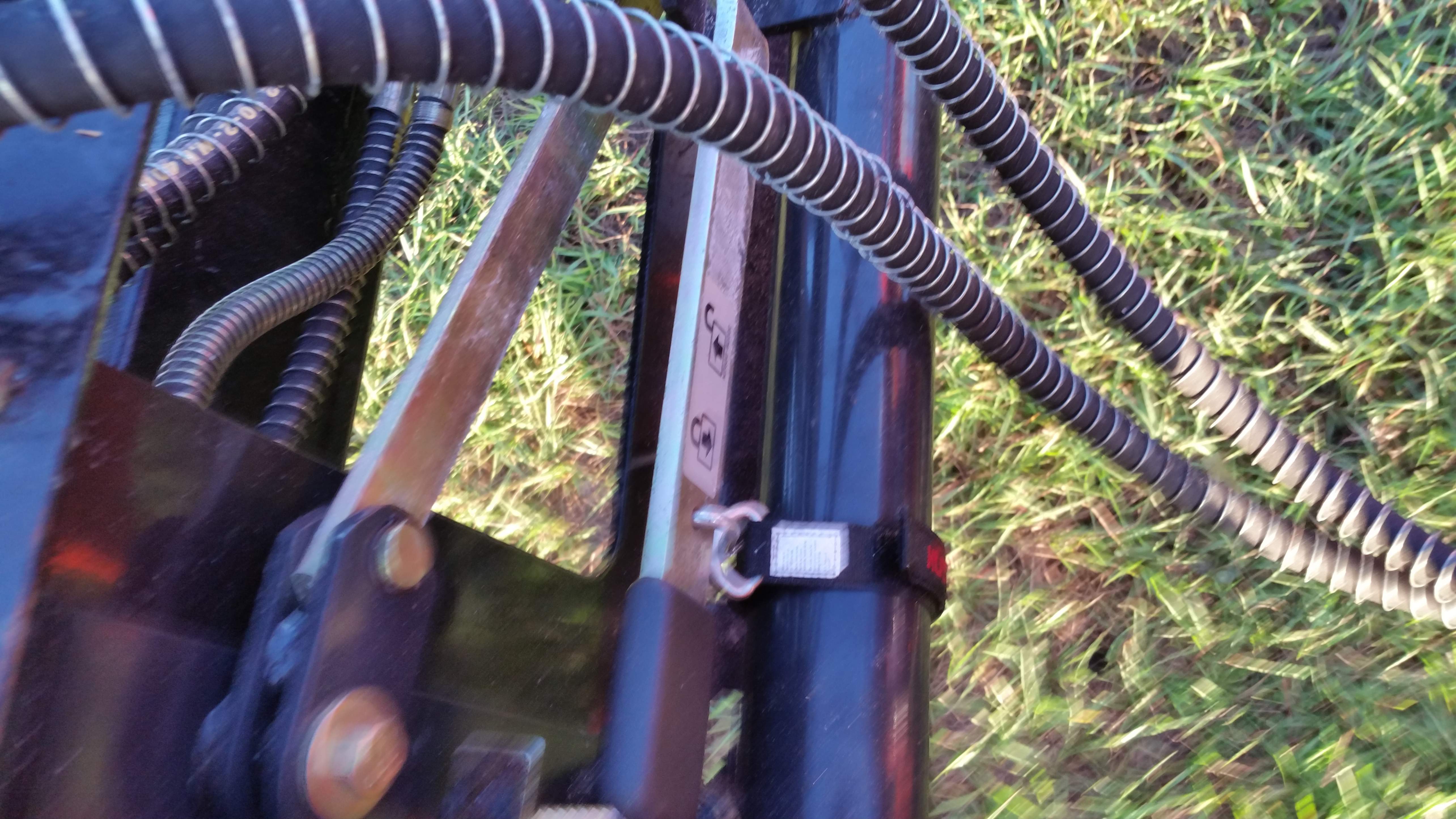

Hello TBN,

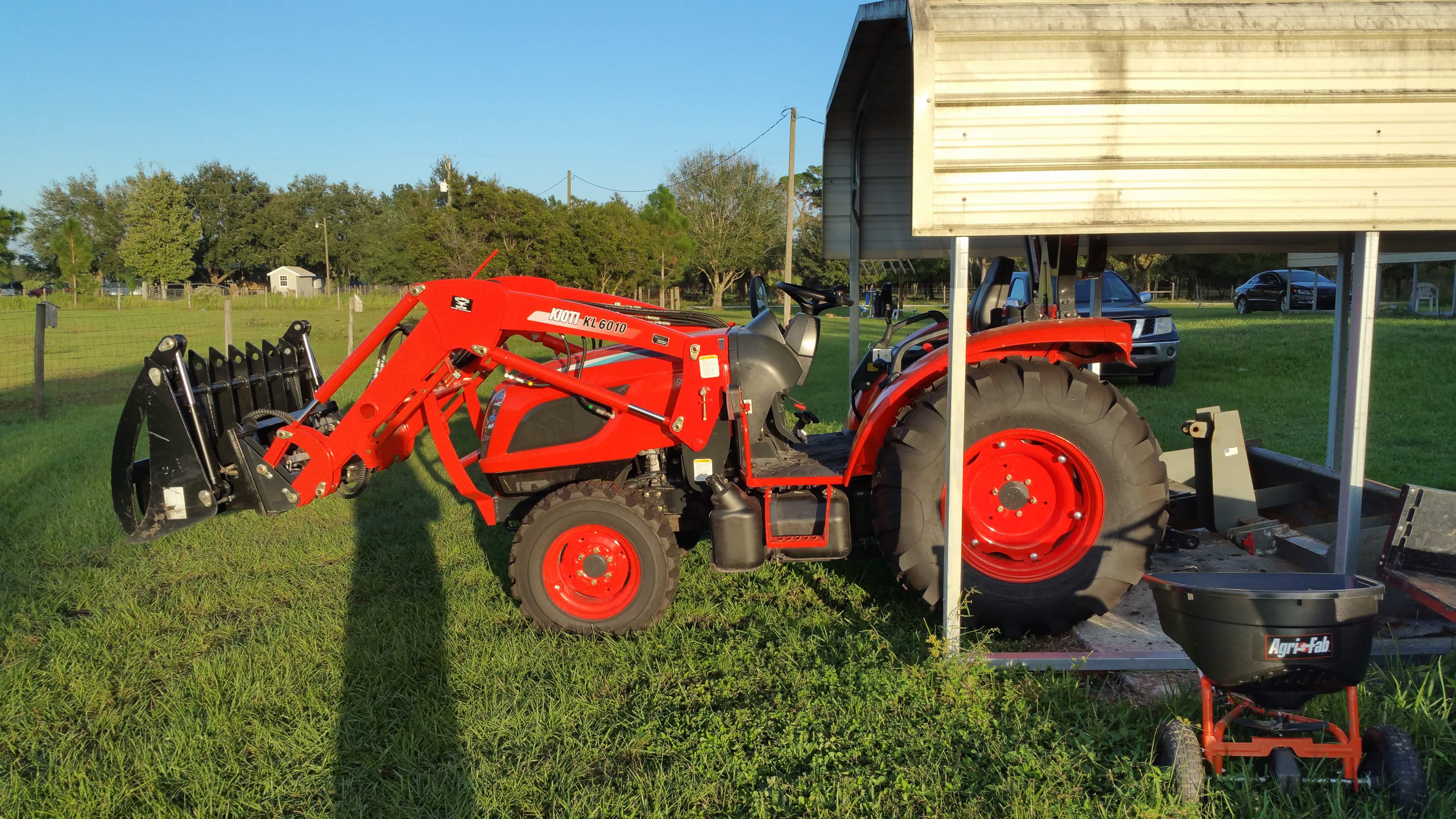

I have read this forum for a few years and during that time I went back and forth from both oranges to the green and back never making a decision on a compact tractor for my 3 acres. My wife finally made the decision easier and wanted to buy 20 acres and a house and sell the 3 acres, so..... now I have a brand new shiny NX 4510 and I am very happy with it. I used my parents L3830 for years and thought I loved it but I really love this thing. My wife calls it "your last big toy." Ha! Anyhow while purchasing and knowing how she works I figured I better get everything now because it was gonna be a while before I got anymore attachments. The following are the things I have purchased so far:
Kioti shop manual

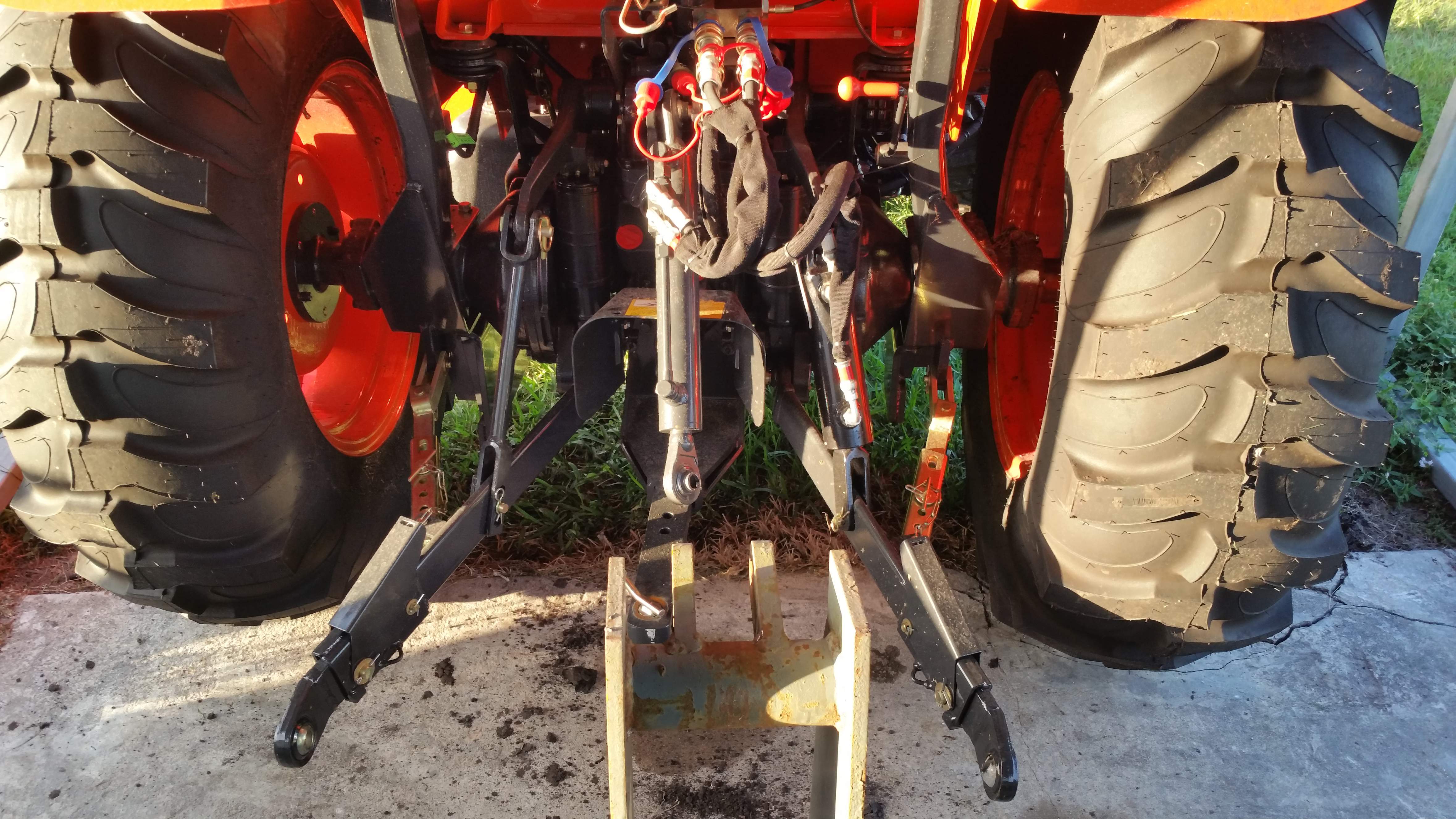

Top & tilt from MI&E

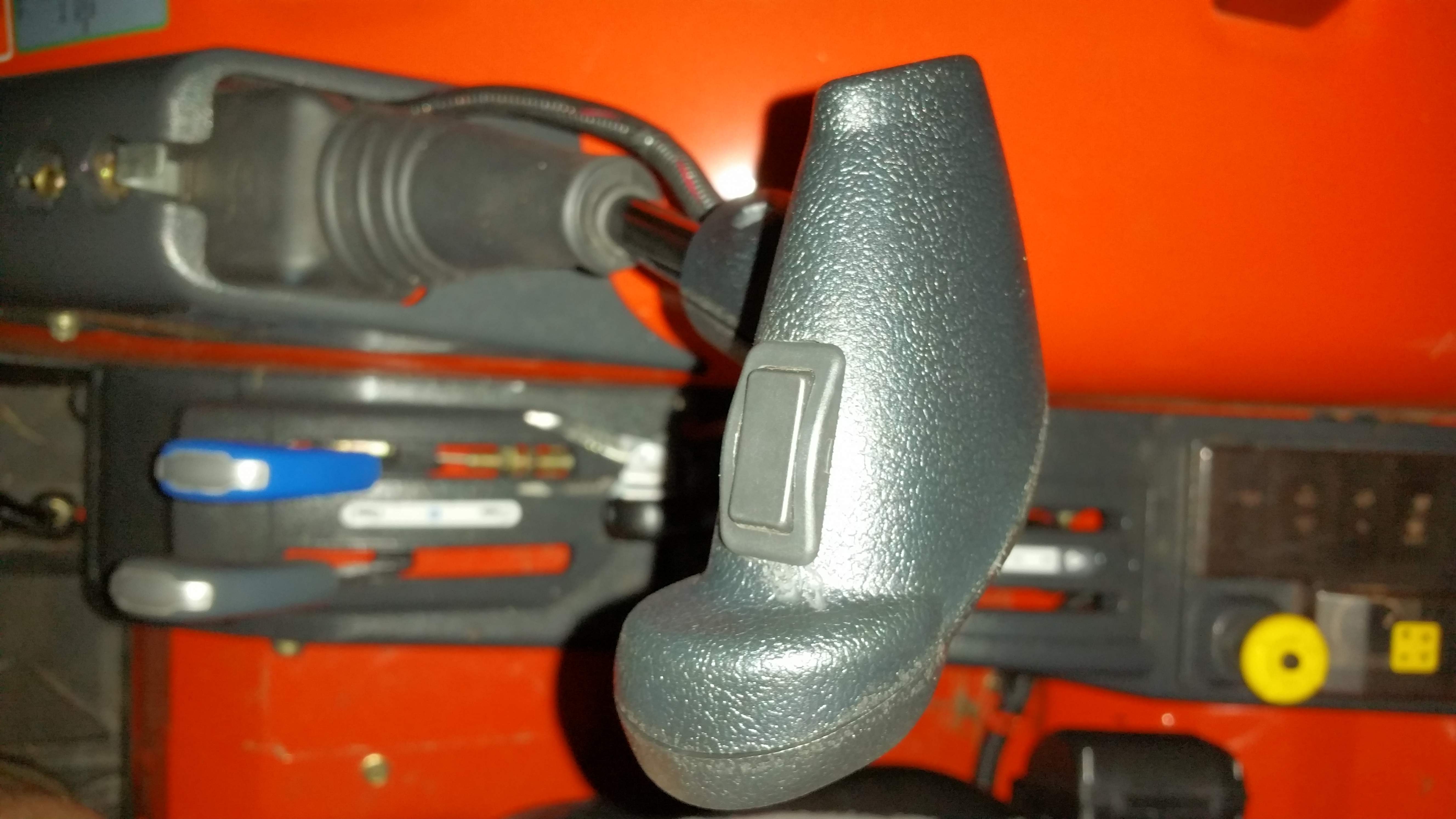

Third function from EA
Pallet Forks from palletforks.com

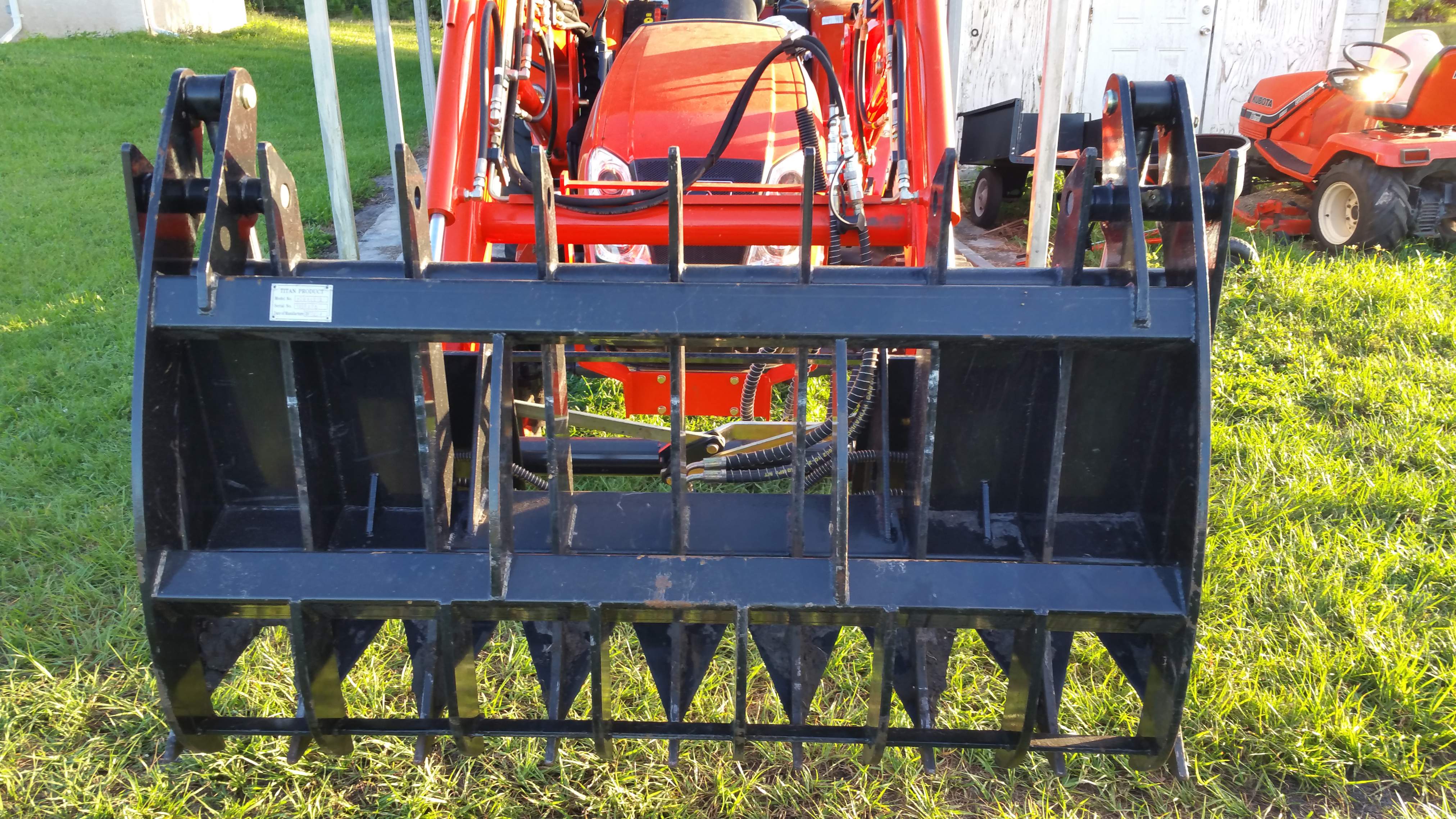

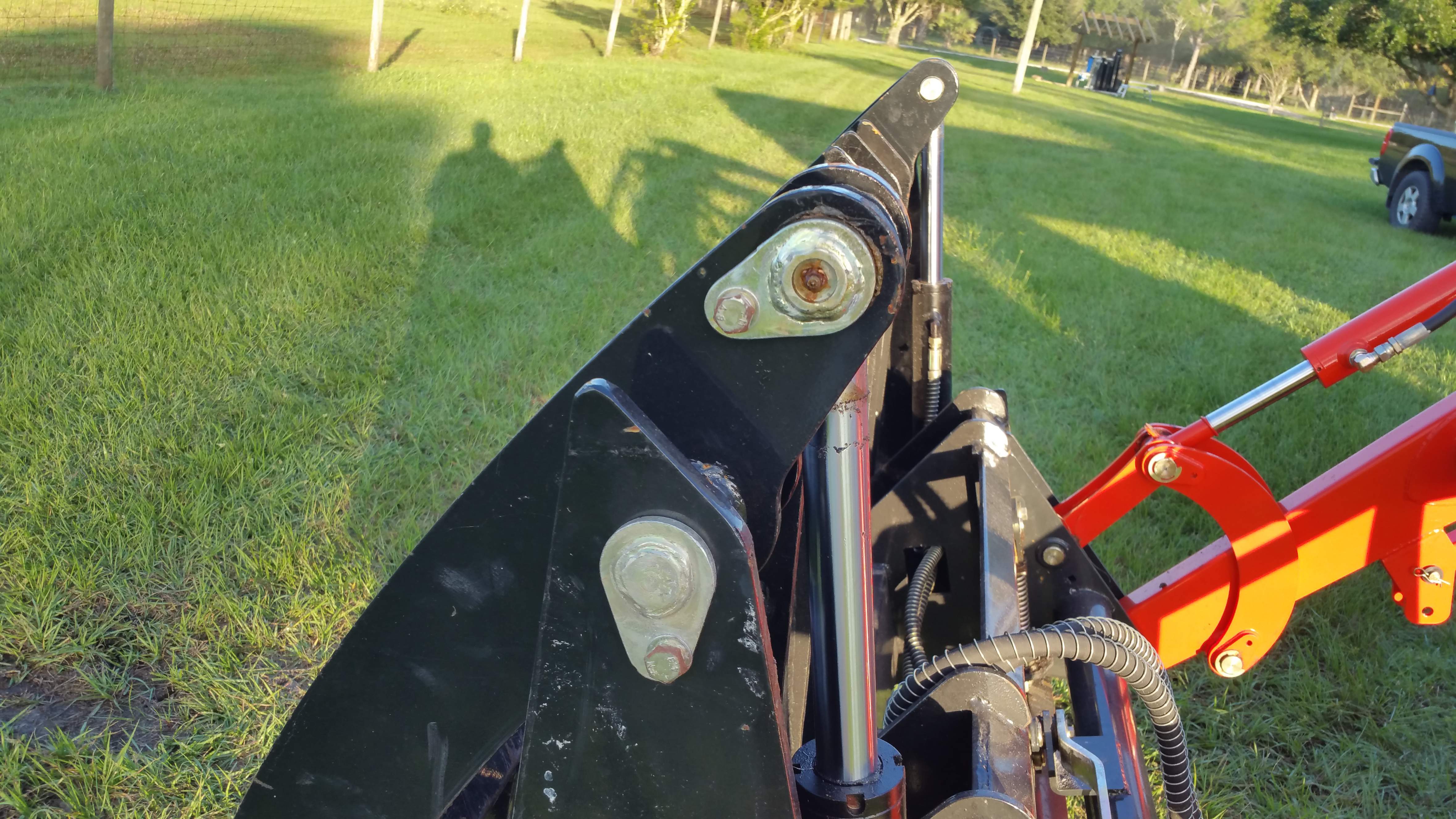

Root Grapple from Palletforks.com

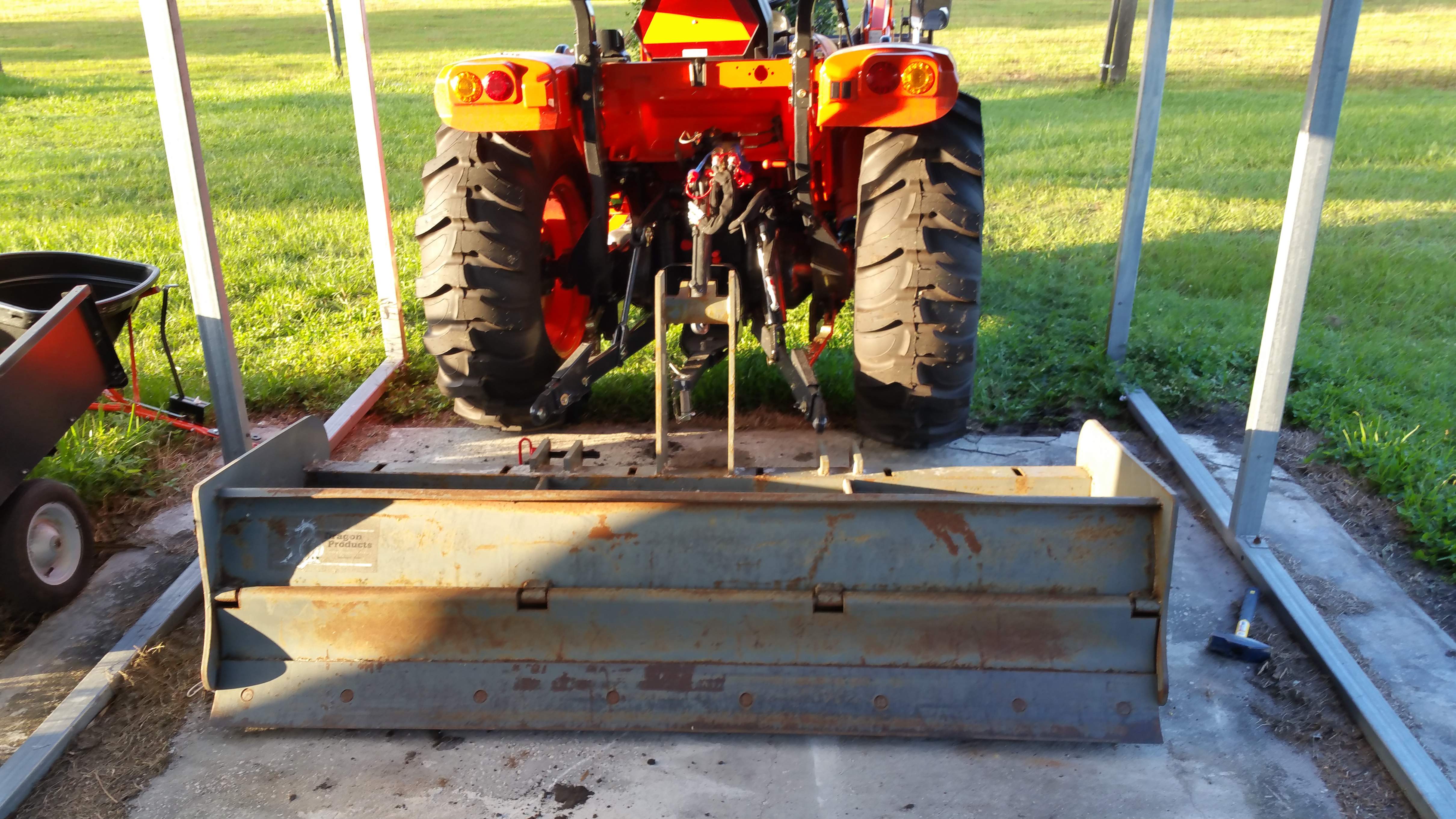

7ft hinge back box blade (Modern Implements) purchased used
next will be Woodmaxx 78in hydraulic offset flail mower and a disc harrow
I have had the tractor for about 3 weeks now ( Sorry took so long to post) and have only accumulated about 11 hours since we are just coming out of our rainy season but I hope to get a lot of work done during the florida winter. I spent most of the 11 hours pulling palmettos from the pasture with the root grapple and I love it, that thing is a beast. I had a great experience with all dealers I dealt with from kioti down. I ended up paying cash for my tractor because it offered me the most savings. I figured I've been working all this overtime for all these years I earned something new that I didn't have to make a payment on or fix all the time. I also have completed a couple mods that I saw on here. One was from Eric The Oracle which was the strap for the quick attach. I noticed that for some reason the lever pops occasionally under load. next was my own doing I hated the joystick control for the third function kit so I dremeled the factory knob and added the switch.
