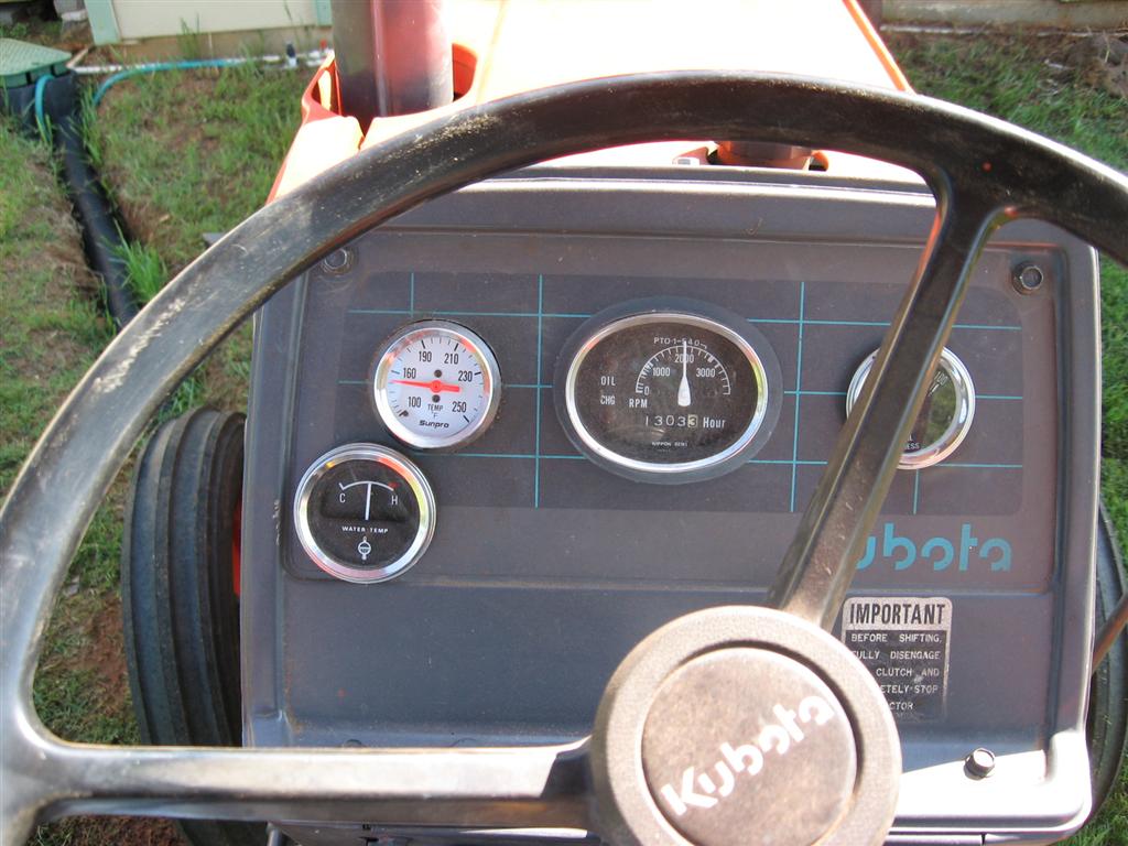

/ new tractor not working #29
Not all thermostats open at 190. My L opens at 160. I bet most others do to. I fixed my overheating problem (a bad NEW thermostat), it stick on 160 all day. It did run up to 175 the other weekend when I was clearing those trails, there was some stuff on the screen. I got most of it off in the field and the temp immedialtly dropped back to 160. I used the compressor when I got back to the house.
Good Luck,
Rob
