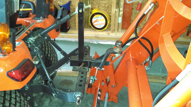

Regarding the trailer hitch, I use the 3 pt hitch. I use it for unloaded trailers. I tried a clamp on bucket hitch before, but found the 3 pt was easier for me to maneuver the trailer.
Here is something I rigged up using a cat. 1 drawbar, cheap bumper mount hitch from harbor freight, and some steel welded together. It works well and cost me about $60.
   / New Tractor, New Member Loader questions #14
Yep, that is very similar to the 3PH ball mount that I use. Those drawbars make a good base. Plus, other things besides a ball can be put in the receiver - Pintle mount, rope hook, grab hook, or whatever you can weld onto a ball mount.
A trailer is much easier to hook up when looking down on the hook-up point over the back of the tractor with a 3PH. When it is out front it is quite difficult to line up and the visibility is limited.
Hooking the trailer to the front gives some added maneuvering ability but (most) tractors have such a short wheelbase that turning a trailer is a cinch from a rear hook up.
