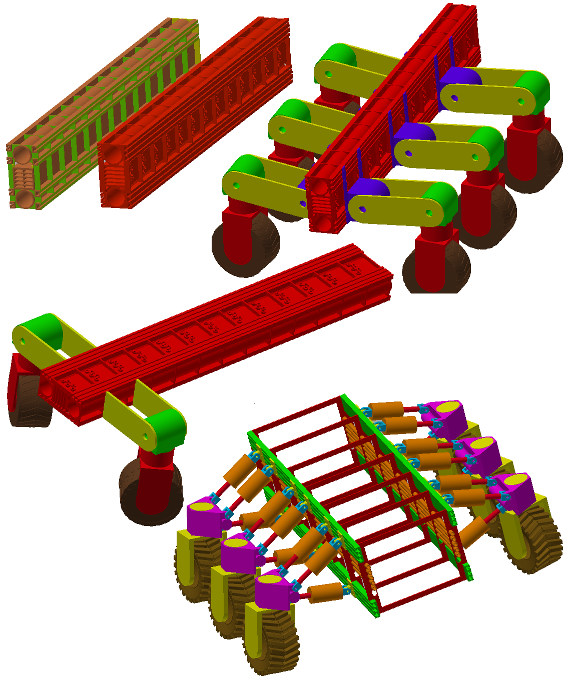

just not happening, with trying to squeeze everything into 12" width, 24" high main center frame.
deciding to go with a wider width of approx 40 inches, and approx 30 inches high.
moving the engine, hyd pump, generator head, batteries, fuse box, fuel tank/s, all into the center main frame. vs trying to set them off to a 60 foot side.
redid linkage/s for wheels so wheels can move up and down a few inches, and extend/contract out away from main frame a few inches. and still allow tires to be used as transport mode or field mode. 3pt hitch like linkages seems to won out. simple and easy.
picture showing 24" tires, but 36" perhaps slightly larger diameter tires should easily be possible.
if ya truly needed extra height, or perhaps lower profile. the (yellow) brackets, between hyd cylinders and main frame, should be easy enough to swap out. to change height of were main frame was off the ground, for both in transport mode or in field mode.
going to stay with the unistrat like tracks. thinking of staying with 3 sets (one on top of the other). for 6 bolts. hope that main center bolts. will take more force. and the other outside bolts. i hope, will keep the center portion of track from really warping badly.
i just boxed myself in though for engine dimensions. if i can keep the engine width down to say 30 inches width, and height below 24" and then how ever long. i should be golden.

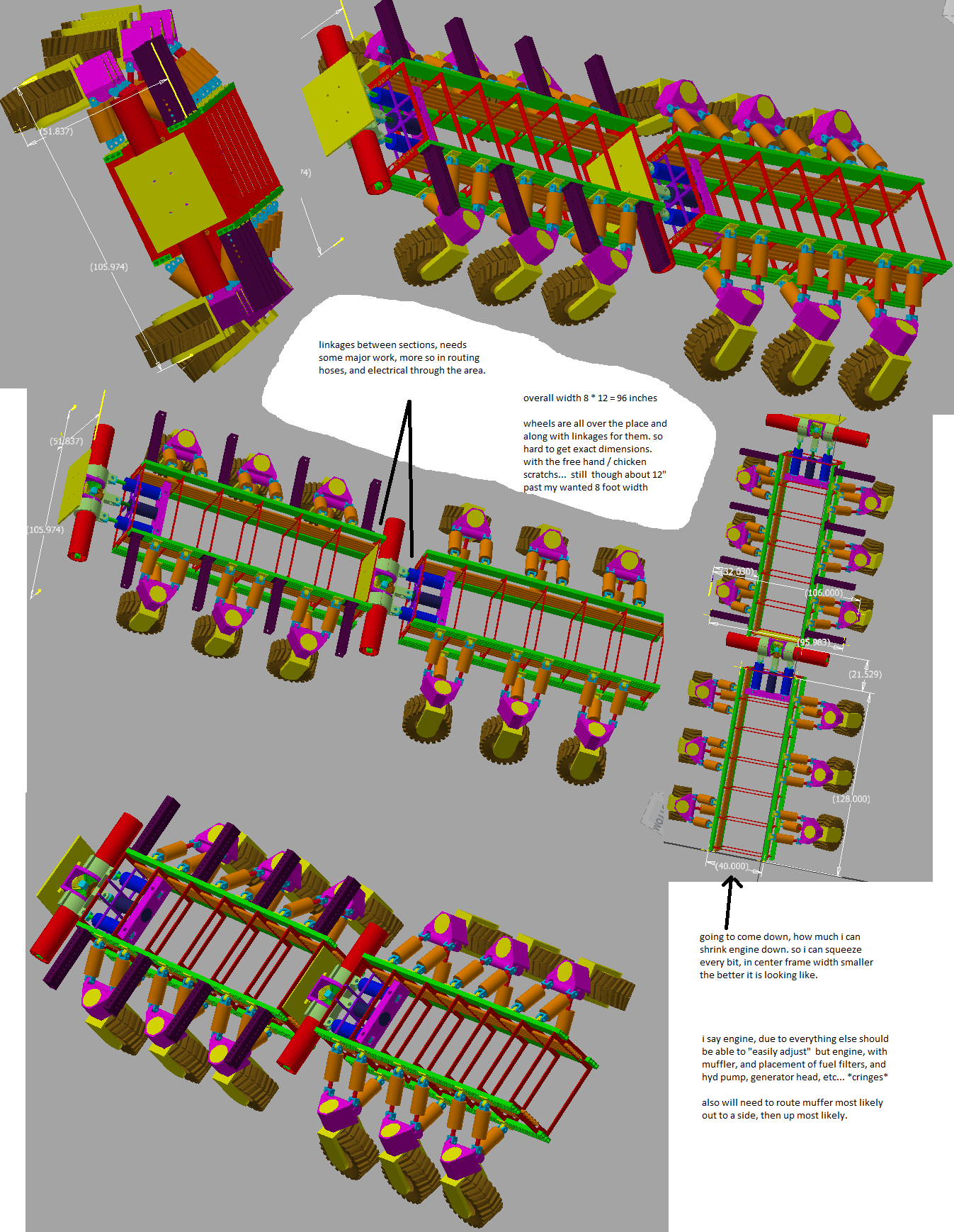

reworked the linkages between sections, not the best ((the big square yellow block)) is my cheat for now. other side of linkages for sections, were the 3 hyd cylinders are. trying to lay some sort of ground work possibly to allow the 3 cylinders and "pinkish/purpleish" support bracket to easily push in / pull out as one single chunk possibily. thinking of using area above and below hyd cylinders. as some sort of place for "quick connect" area for all the hoses and pipes.
with above said, at moment showing 2 approx 15 foot sections (counting section linkages) figure engine, hyd pump, generator head, muffler and anything else that needs direct connection to engine, and can not be placed in another section. is going to max out a single 15 section. then maybe using a 2nd 15 footer section, for fuel tank, batteries, fuse box, fuel pump, fuel filters, hyd oil filters. not sure about hyd oil coolers... most likely going to be counting on a min of 3 15 foot sections and there linkages between each section. to get the basics. 45 max feet for basics? hhmmsss maybe see what happens.
more space i can squeeze the width of the main frame down to. the better for linkages to wheels, and linkages to fold/unfold implements.

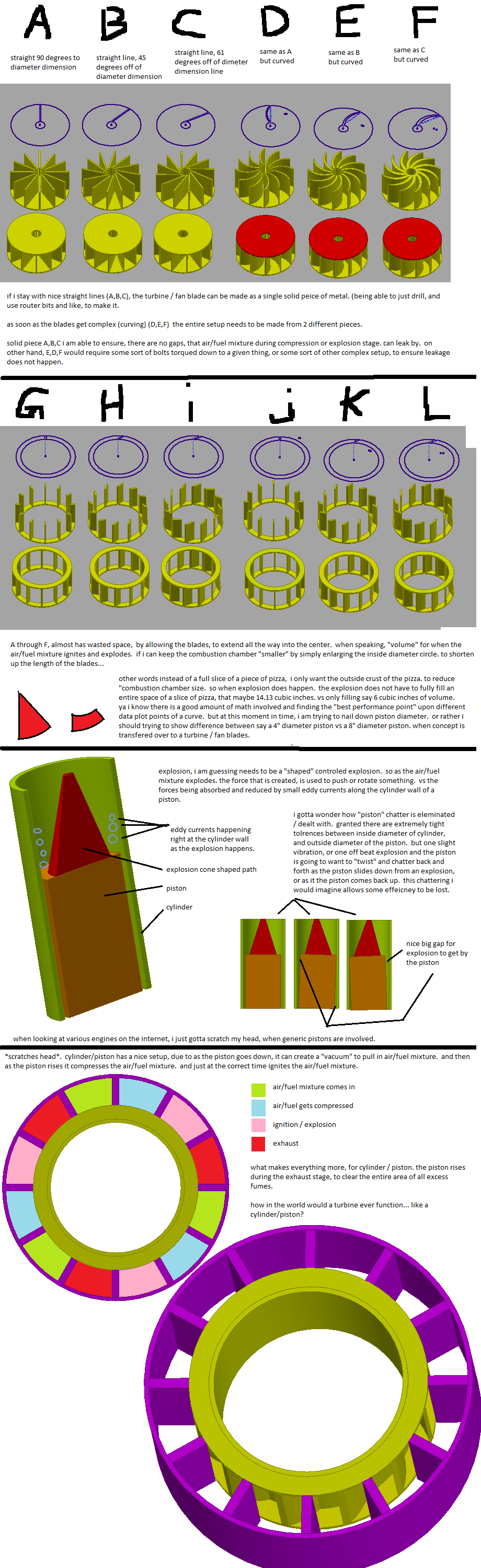

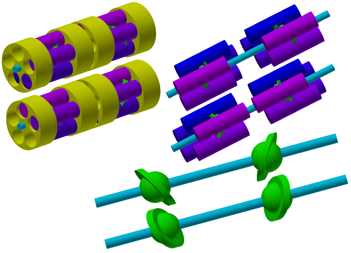

never much of an engine person, so most likely off on terms...
double swash plate.
10 pistons
20 cylinders
primary goal is reduce some vibration. in how i have the "swash plates" matched up. when an explosion of the fuel happens. "weight" and "force" of the pistons, is carried off in opposite direction. to either bring the pistons pointing between swash plates together. or apart from the center of the 2 swash plates.
i suppose, i am technically using 2 engines connected to common drive shaft. not sure how badly the drive shaft would vibrate and want to bend right at the center between the 2 swash plates.

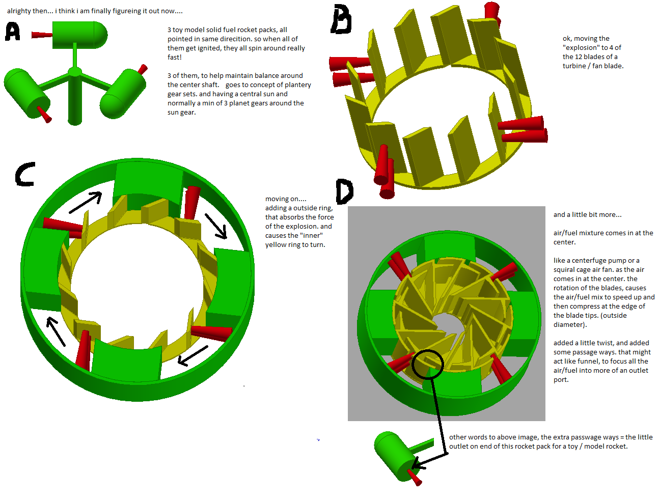

re-write 5. getting a tad annoyed with myself, due to lack of indecision. a lot comes from lack of knowledge. and i keep changing my mind as things click.
alright....
started drawing something up, and when i stepped back from it, it was a mix between turbine engine and piston/cylinder engine.
i like the turbine ability of lots of HP and lower weight, but what i do not like is the high "air volume" per min that would need to go through the engine. your talking a tractor here. seeing dust, weed seeds, leaves, snow,ice, water, mud splashing. if i tried to move such a high volume of air. there would most likely be a huge amount of "plugging" of screens and filters. an air plane, a jet, a helicopter, a large boat or should say ship. they have a cleaner environment that the engines most likely would run in. vs a tractor out in fields, and going through dirt roads, and muddy ruts, etc....
the other issue with turbines, is material needed to handle the higher temperatures. which of course, would most likely cost more $$$$
the high RPM's could most likely be dealt with, at the generator head and hyd pump and air pump. even if i needed to use some gear to reduce RPM's of a turbine engine.
i do like the simple shaft/s ability of turbine engines.
piston/cylinder engines. i just do not like the "vibration" even with the last post picture/s.
i guess what i am looking for.... is some sort of "timed" air/fuel mixture engine. that has mini explosions of air/fuel. vs a constant stream of air/fuel in a turbine engine, that gets away from piston/cylinder. ya a timed air/fuel mixture, like a piston/cylinder engine. would create a vibration. between each explosion. but the ability to adjust air/fuel mixture, and roughly predict RPM's over a wider range, and torque. it would be nice to get to something that has a few more "piston/cylinders" vs concentrated in only a handful of pistons/cylinders. (ggrr need to say combustion areas)
or, i go with a bunch of smaller size turbine engines. that are all built into a common engine. that allowed lower RPM's. but ability to adjust torque. while maintaining RPM's. hhmssss.....
a turbine engine, with idea of such a high volume of air both being positive and negative pressures. and hooked into say an air seeder or like. and if exhaust could be cool down enough. ya right, that would most likely over crowd the engine section of the 3 to 4 sections that make up the SSTT.
hhmmmssss.... turbine engines....
as much as i like the idea of a turbine engine type in the SSTT, the con's are to much.
attached diagrams, just me, trying to think things through...

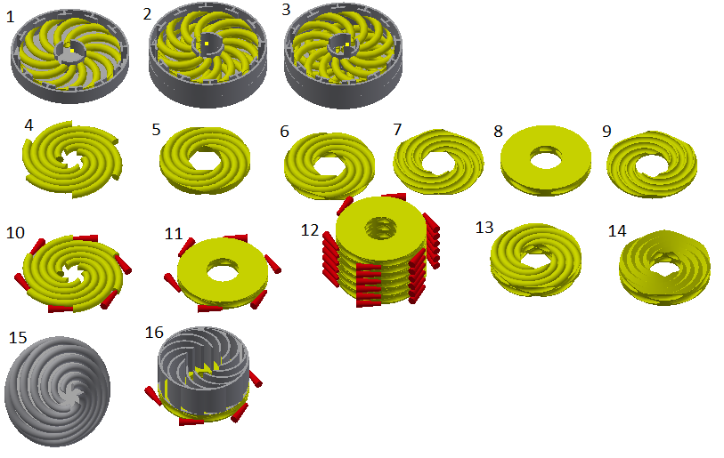

DESCRIPTION OF ATTACH DIAGRAMS!
continuing off of last set of diagrams in last post of mine.....
1. using circles and cutting them up to make "vanes" air enters through the center, the blades/vanes turn. an explosion happens, then blades turn more. and the air coming from center helps push exhaust out, into an outer ring.
2. same as 1, but trying to see how doubling them up would look
3. same as 1, but looking to see if i could change direction. of one of the set of vanes/blades. to act as a better "compressor" to compress air and or air/fuel mixture, before the explosion happens.
4. went from circles to "spirals" to make better use of space.
5. remove extra garbage on the inside and outside of creating the spirals
6. turn the spirals into actual pipes, that are bent into sprials.
7, 8,9 7 and 9 are 2 halves that would have to make up #8. no other way to get around it, for actually machining the pieces out.
10. trying to show "flames" or rather explosions coming out the ends of the 6 spirals.
11. hiding things away, and showing what the blade/vanes would more likely look like with flames / explosions coming out the ends.
12. wanted to see how things would stack up. i really do not like the "straight" notations. and most likely would want to "spiral" the flames/explosions around the entire center drive shaft. to possibly pickup some better explosions efficiency.
13, 14. just trying to see if i could stack more vanes/blades in a more compact form, and if it would pay off or not.
15. thinking about changing spirals from "flat" spiral. to more of a "coil" like a spring. so air coming into the pipes/vanes/blades. it is not having to take a sharp sudden 90 degree change of direction. and in that loose my velocity (think miles per hour) of how fast the air is moving along with "pressure" loss.
16. trying to see if a squirrel cage like fan, might produce a high enough pressure, for everything. and frankly i doubt it is possible. at least in the space i have available. granted i will most likely proven wrong some were down the line. but the issue with squirrel cage fan is, it causes air to change sudden directions multi. times. and it would require extra space, that simply is not there, at least at first glance. and at this moment in time not worth while for me to look into.
