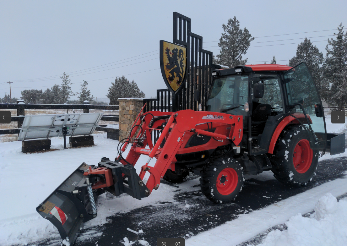

Kubota is undeniably a stellar brand, but as a finance guy I went for something equally reliable which offers better bang for the buck.Picked up a Kioti NS6010 which has all the bells and whistles for $40K US (60HP, FEL, cabin, airco, third function,...) I don't really need 60HP, but hell, my 911Turbo has 600, you can never have enough HP :). Serious, have a look at Kioti if available in your neck of the woods. They started as a Korean Kubota copy cat.
