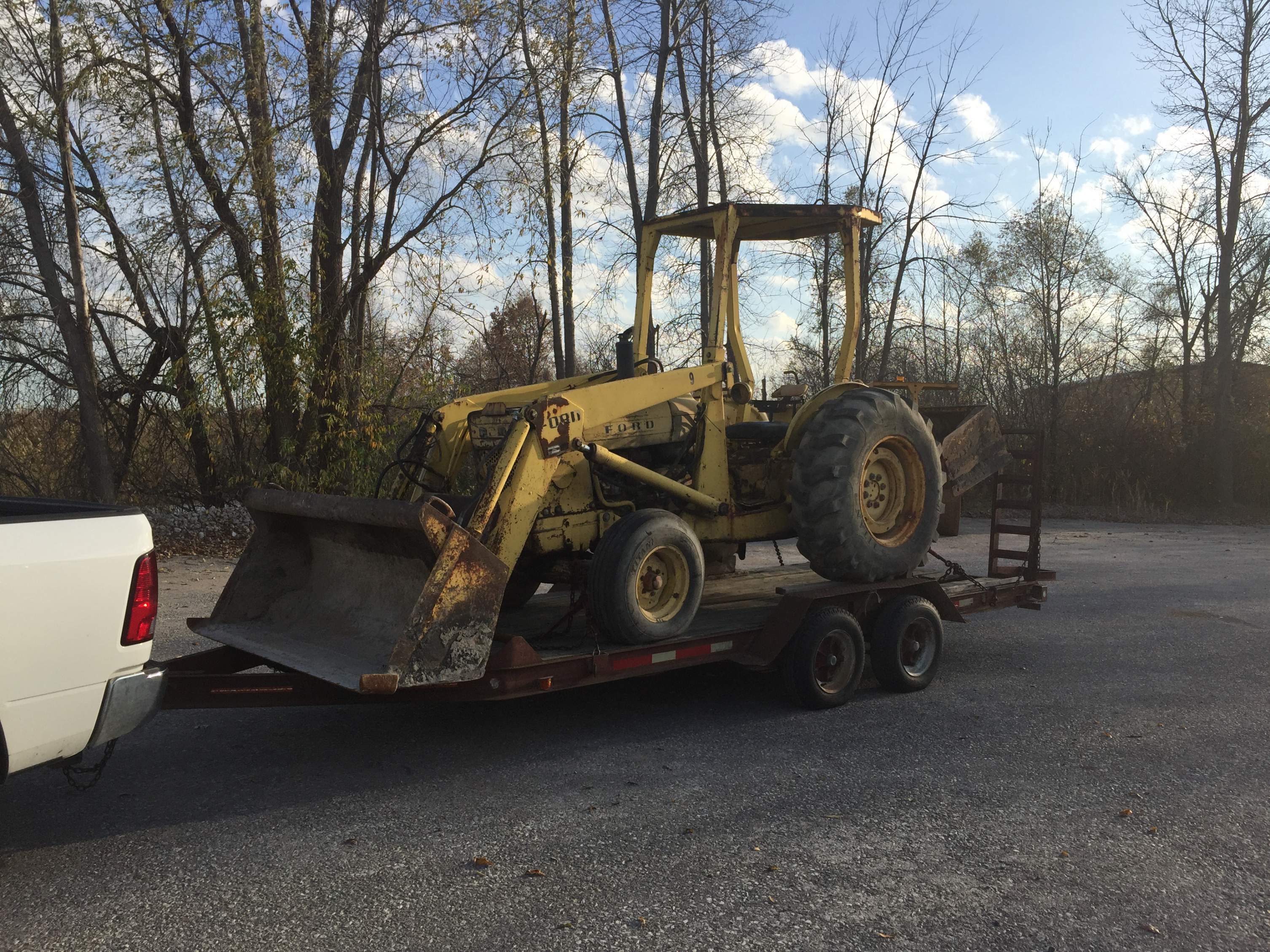

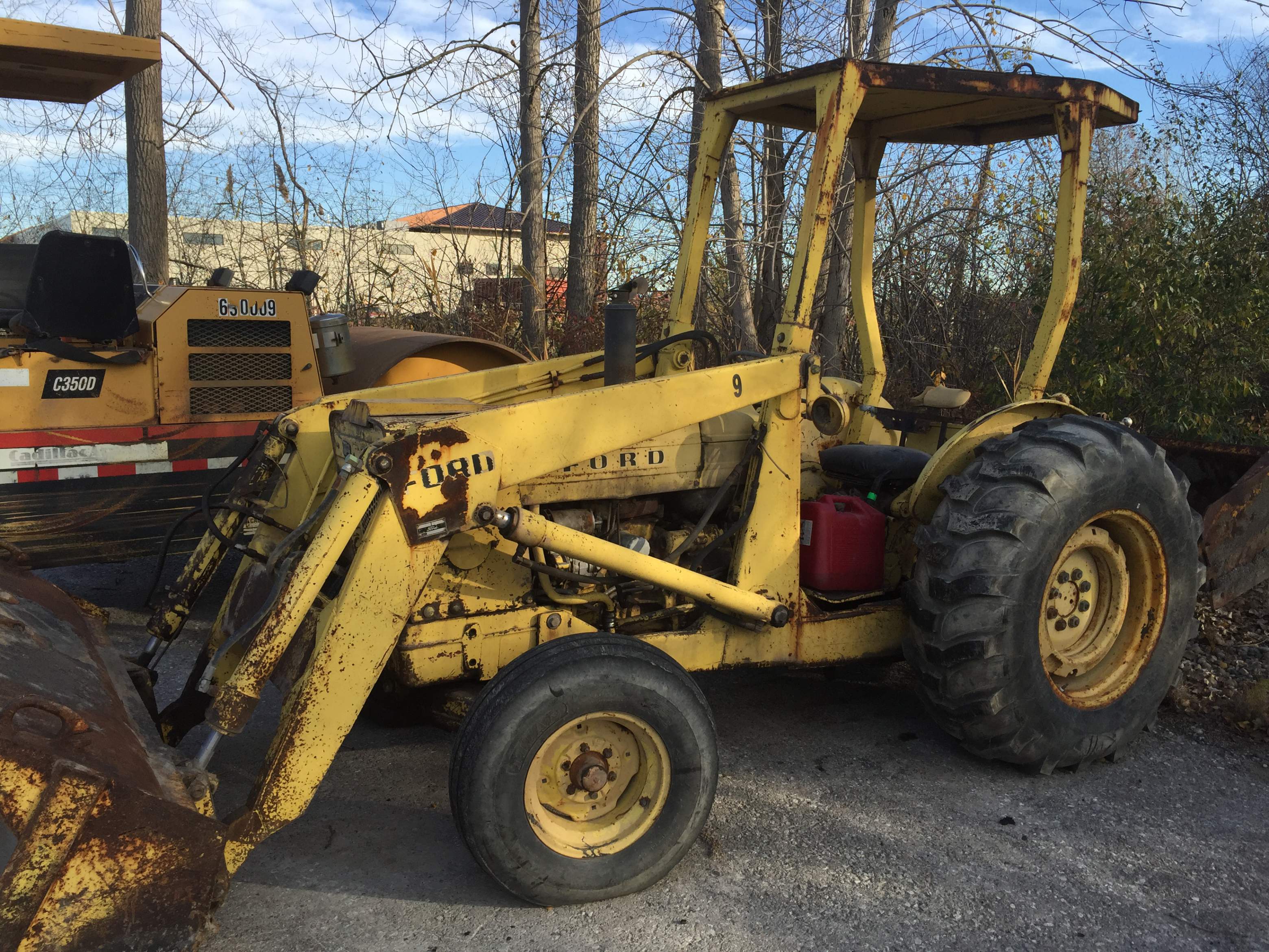

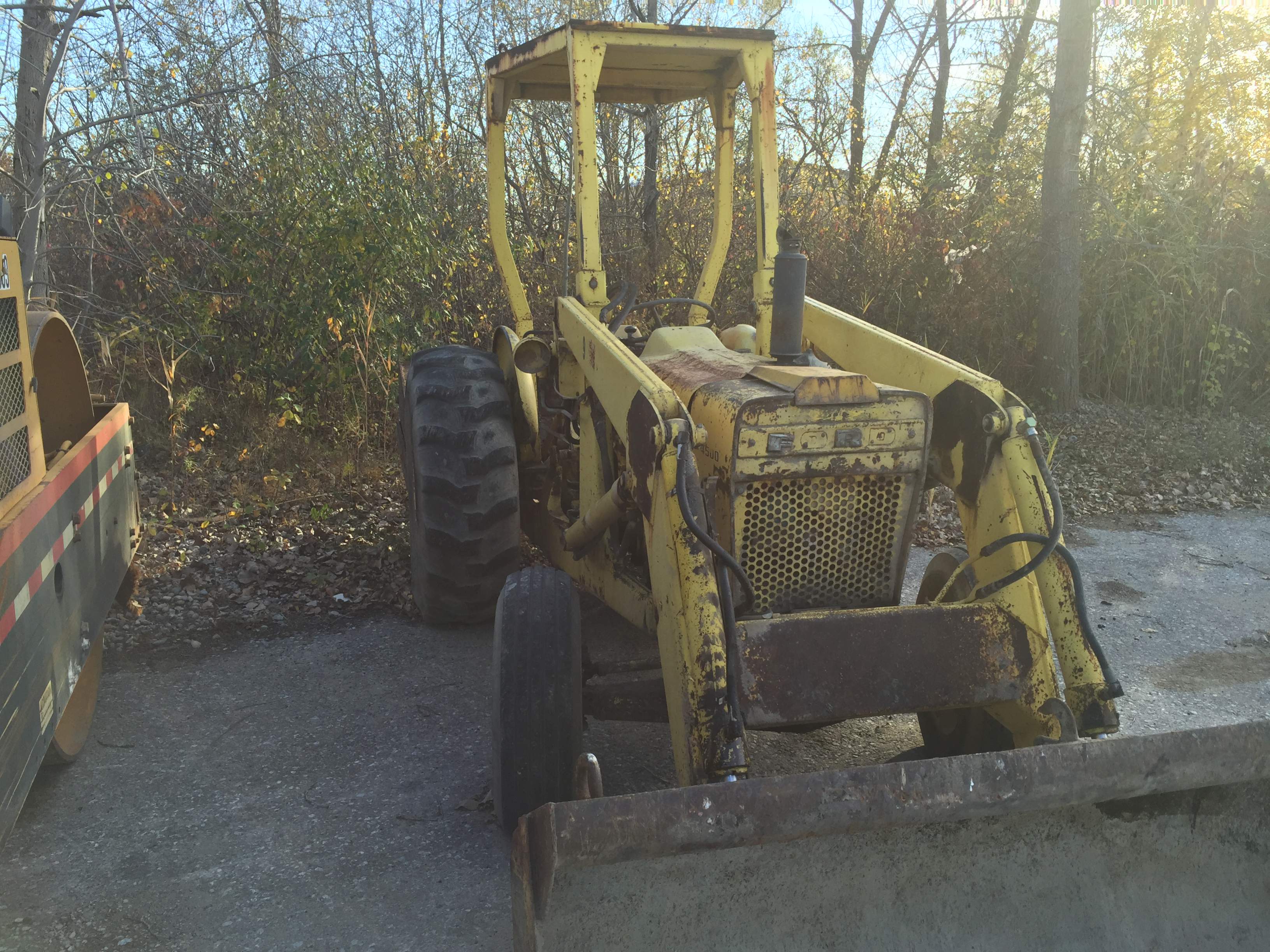

I couldn't resist this one. O'l lady tells me that I have to many tractors and to many projects......I just smile and say "ok ok, it's the last piece of equipment". I never listen to anything she says anyway. I picked this one up about 30min from the house. (C388169) I'm thinking its a 1973 4500. I went and looked at it and the guy couldn't get it started, turned over but no smoke. He said, when I parked it last week it ran great. I thought I was looking at a parts tractor and made an offer accordingly. He said it has a new battery and new starter. The battery is huge & new, one brand new 16.9x28 Goodyear, the starter, not so much. I go back yesterday to pick it up. Hit the key, Click, nothing happens. I told my buddy to smack the solenoid with the wrench. It starts turning over but no smoke. Crank it some more but won't fire. While I was looking at the pump, I noticed the fuel shut off cable was broke. Pushed the lever forward and it started right up. This monster runs like I can't believe. I'm still in complete shock as to how good this machine runs. Either there's no oil in it or it doesn't leak a drop. The only major problem it has is the power steering doesn't work at all. I was expecting that because it's the steering is the weakest link on these tractors. I'm going to do front to rear full fluid/filter service, give it the "good from far but far from good" paint job, full hydraulic steering and run the snot out of it. It's so big, It barely fit on my 16' trailer.
