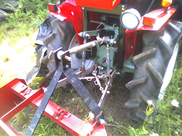

I went to the local farm store and just started looking for parts that might be helpful. I saw a draw pin that looked like it just might work. I bought a few, and bolted them into the frame of the tractor. I hooked everything up so it at least looks like most 3 point hitches I have seen. (see Picture)
I still haven't figured out how to hook up the stabilizer links. I don't even see how I could modify the tractor to make them work. The best I can see right now is to put something on the inside of the draw pin and hook the links to that. Take a look at the picture and tell me if you get some bright idea how to attach the stabilizer to the tractor.

You're right on the money about the sway chains. I could hardly pull the lift arms apart to hook into the 6 foot box blade that I bought yesterday, but once I got the blade hooked up and lifted it swayed around quite a bit. I just hooked it up to move the blade to it's "parking place" after I unloaded it, so no harm was done.
I've got a guy fabricating some "tabby do-dads" right now to hook the sway chains into. I'm probably just going to loop the tabby do-dads over the draw pins as was suggested.

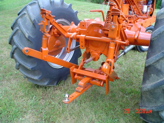

on my AC WD45 the factory didnt use sway chains, but they had a limiting block/rub bar for lack of a better term that fit over the draw bar. it would allow the inside of the lift arms to smack it and effectivle stop three point sway. it worked good. just expect to paint twice a year. it might give you ideas.

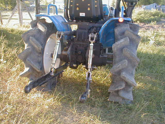

My Yanmar didn't have any sway chains when I got it and when making a turn pulling the brush hog it got to bouncing pretty high. Here's how I remedied the problem........ The sway chains with turnbuckles came from Hoye.........oh, and I made the pivots that slip over the pins from some flat 3/8 " stock
