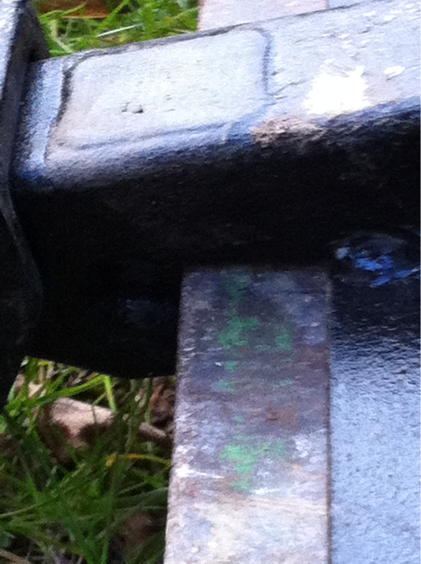

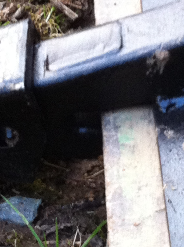

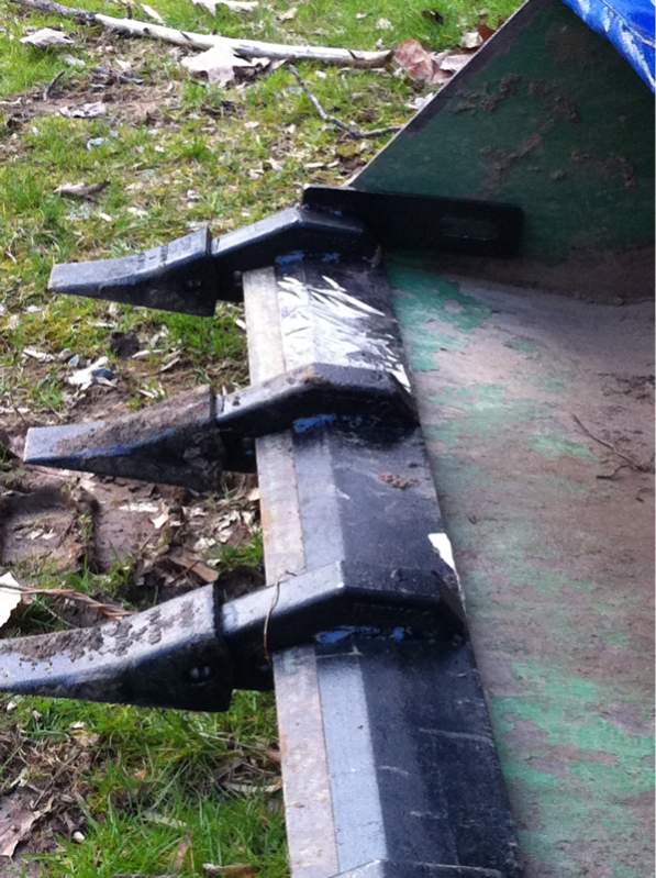

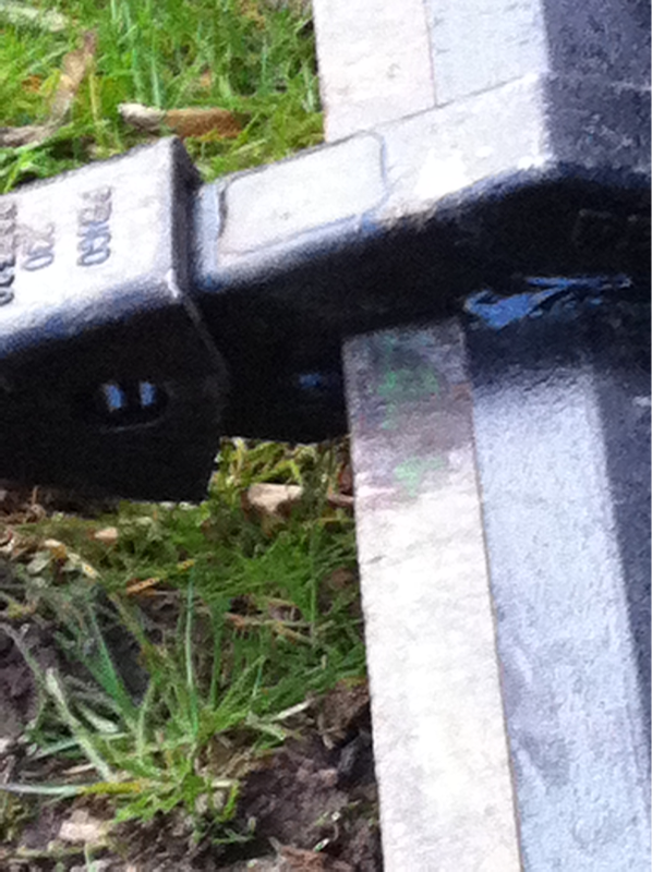

Just received my Gator Toothbar. Went to attach to my bucket and found that the teeth do not slide under the bottom of the bucket very far, leaving what looks to be quite a bit more room to slide on. I cannot move it any further and figured before I push it against something to see if it will slide on further I would throw this out there. I have a JD 61" HD bucket. Is that normal? I would figure they make them somewhat universal to fit lots of different buckets but wasn't sure what others had experienced.
Thank You -Dana

I will try to take pictures tomorrow. The bucket has the bolt holes for the cutting edge but I don't have one attached. That is what I thought they were referring to - the edge not the bucket. I should have asked - I may have bought the wrong toothbar....
   / New Toothbar Attachment Question
Well I tried to take some pictures though the gap is hard to see - probable at least a quarter inch the bar could slide back until the the hooks under the teeth would be touching the bucket - wonder if this is normal or a problem..
Thanks for the replies- Dana

That installation looks fine. That 1/4 inch won't hurt a thing.
What you're seeing is where the radius of the tooth holder (casting or forging) begins. The angle on the cutting edge and the angle on the tooth holder are a bit different, so you won't get a perfect fit.

Thanks Roy- I really appreciate your response- now I can drill some holes and put it to good use!
- Dana
