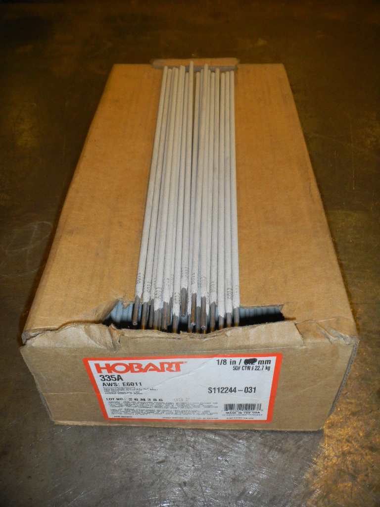

For what little I've run 6011, I really like Hobart's 335A 6011.

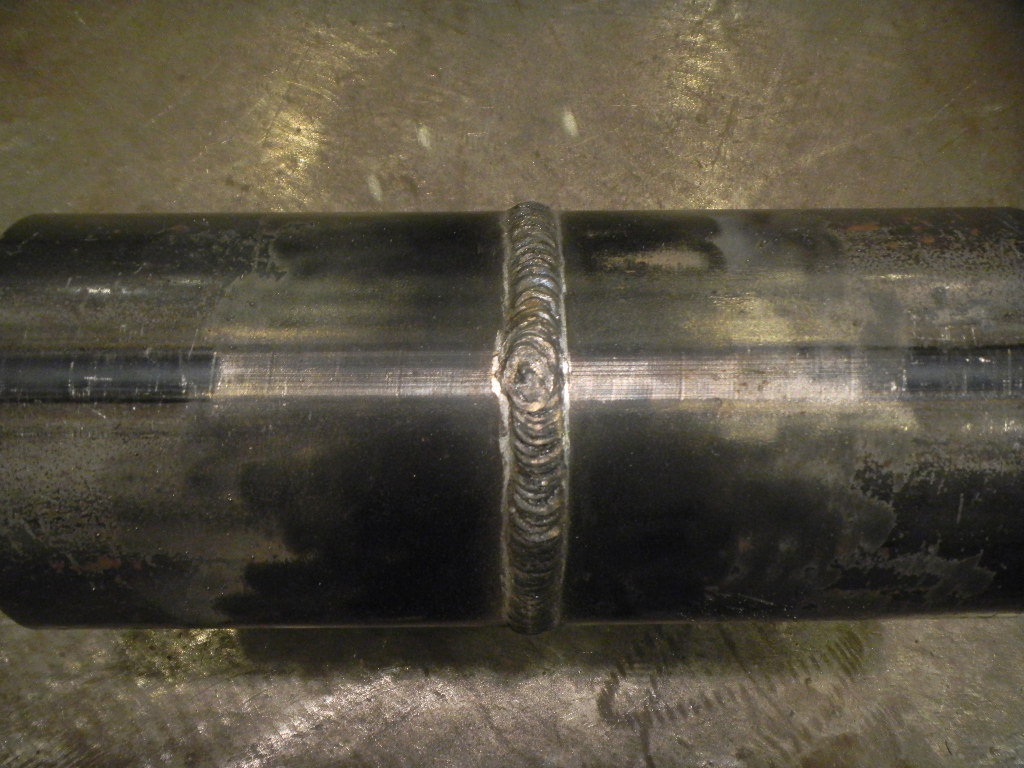

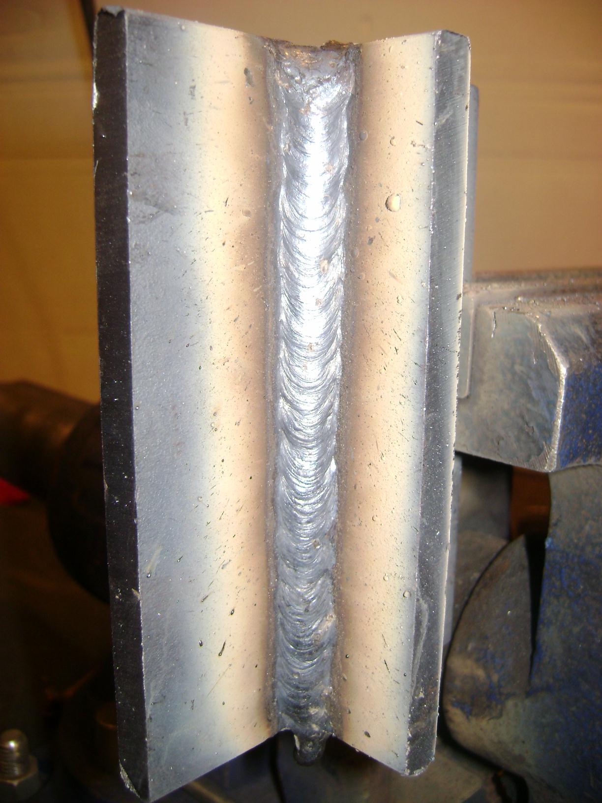

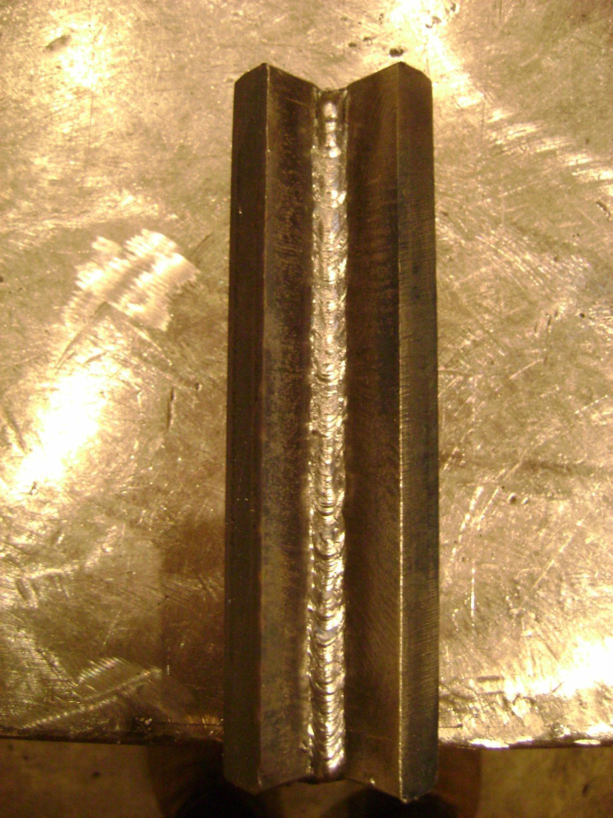

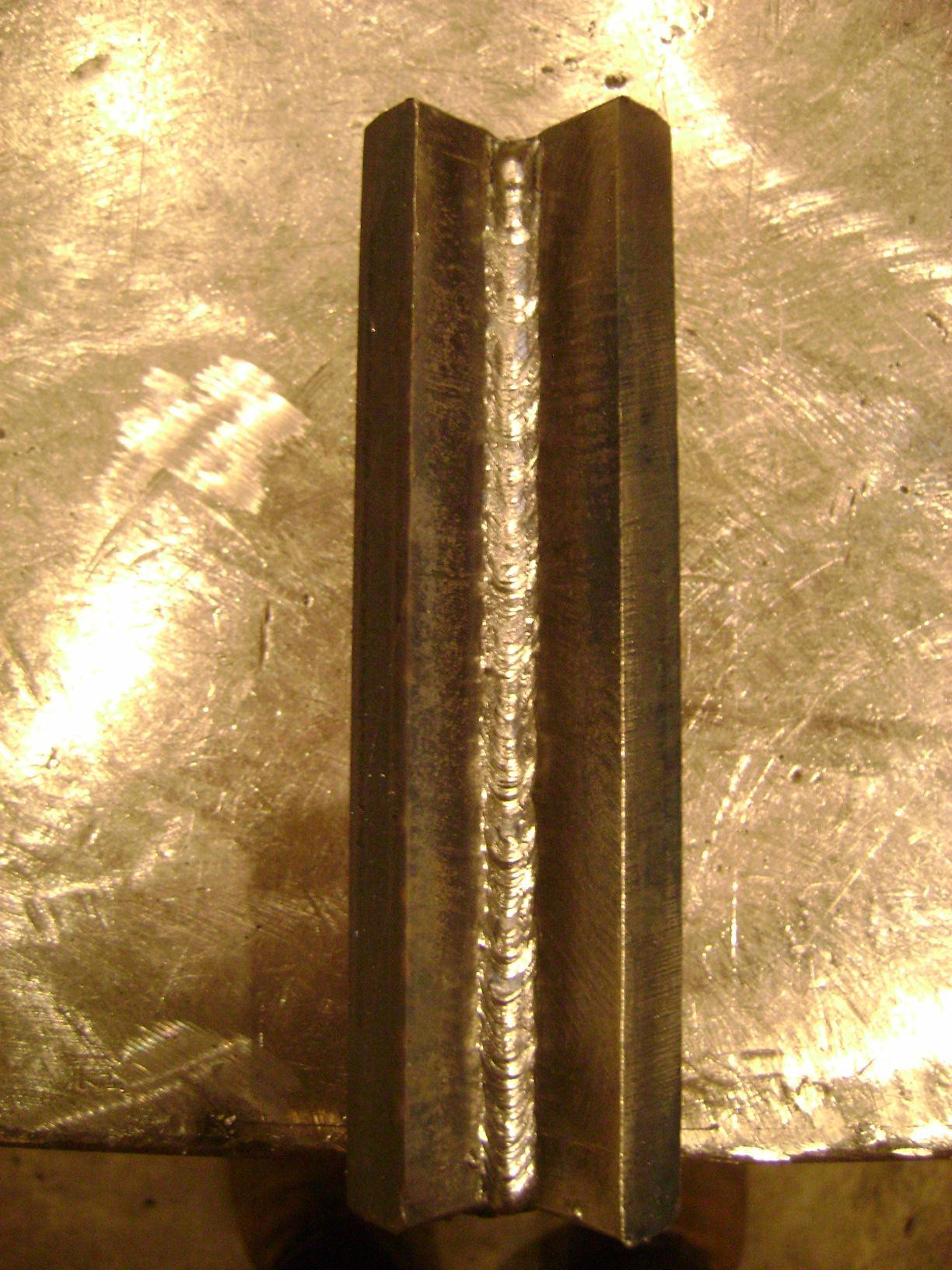

I run 7014 vertical up hill like I do 7018.
First picture is 7014 vertical up hill.
Second picture is 7018 vertical up hill.
