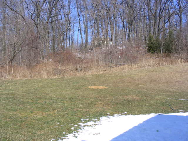

My slopes look similar to yours. Here is the slope behind my house. It measured between 18-26 degrees at different parts with one very small section at 30 degrees.
I used to mow this side to side with my Ventrac, but would not do that with the 425. Now I go around to the top and straight down.

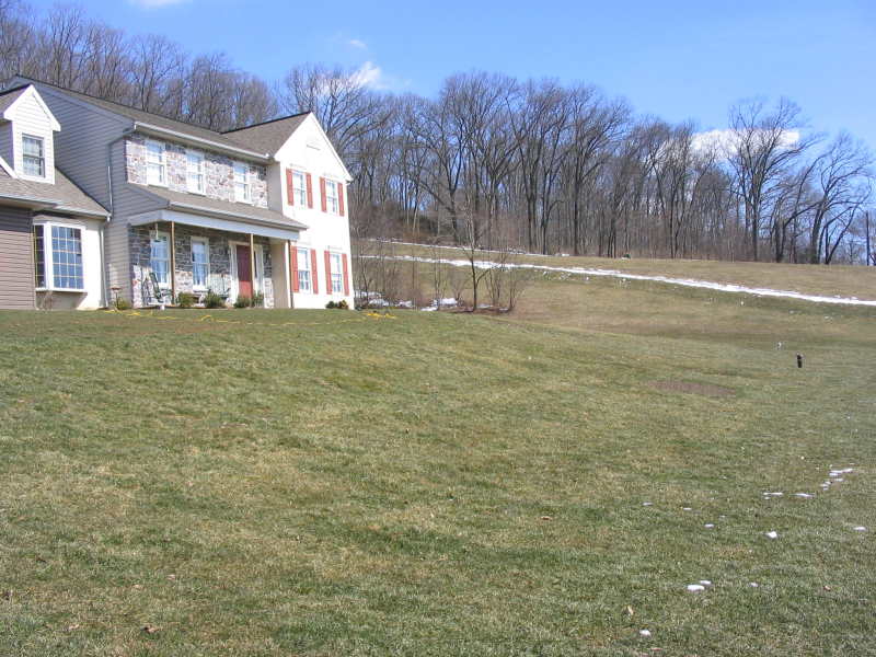

Here is the left side that I drive up to get to the top of the hill. 10 degree slope, easy.

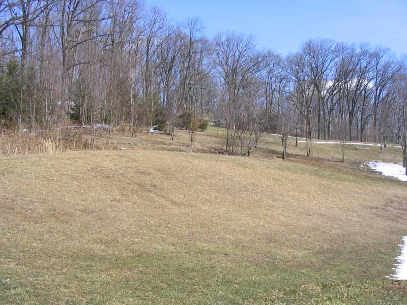

Here is the front hill. I can mow this side to side with no problems. I get a little shaky on a couple of spots. I am considering turing the wheels around like Fourteen has done for a little more stability.
The 1430 would probably be better here as it already has a wider stance.

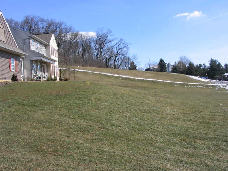

Last pic of the front hill. I measured the slope from 14-23 degrees. The parts over 20 are very few and are dips that I will be correcting this summer now that I have a great tractor with good FEL capabilities. /forums/images/graemlins/grin.gif
