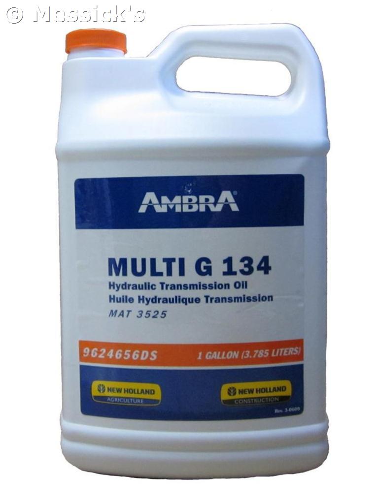

While you are at the New Holland Dealer you should pick up a gallon of Ambra multi g 134 trans/hydraulic fluid. It's good to have on hand.
