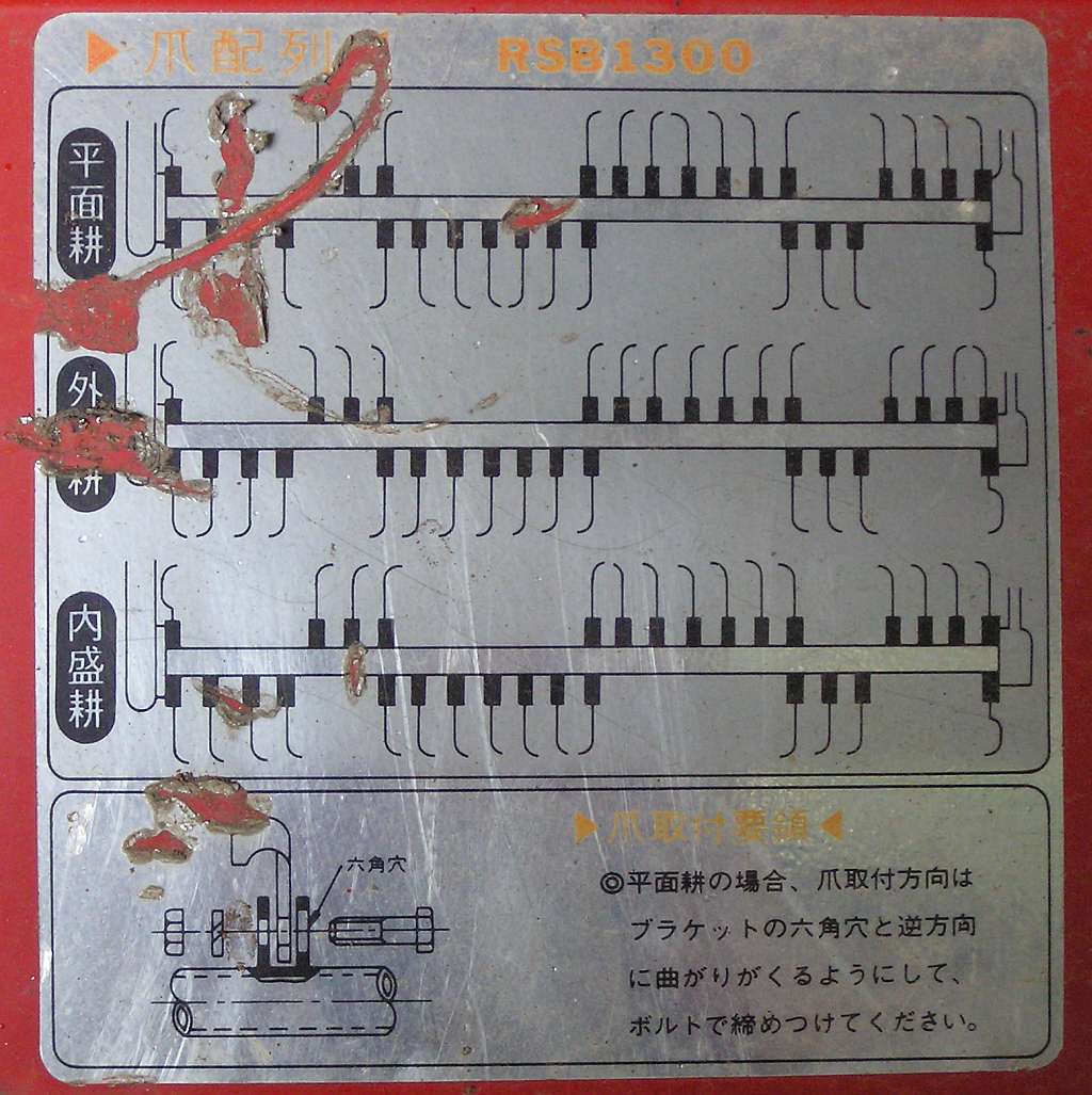

Is there a set pattern when replacing the tines on a Yanmay tiller There are bolt holes that some seem to load the bolt from the top and others from the bottom(assuming I have the tiller on the side). Any help would be great..
   / New to tillers #2
Yes, there are patterns for the tines. I'm not sure what diff there is in the various patterns as far as tilling is concerned.
Here's a pic of the decal on my tiller showing the various patterns.
   / New to tillers #3
The way I understand it, the patterns are relative to where the dirt "tends" to migrate when tilling ... neutral (top config), to the outsides (middle config), to the inside (bottom config). I set mine to neutral but have hardly used it since trying it first time so don't know if it makes much diff.

Thank you for the photo. I now laugh because the tiller does have a drawing like that but I had no idea what it was for as you well know you can't read anything..
We were given a new set of tines when we bought the tiller and as soon as we put them on and tried it, 7 broke off. We called the company that sold the tines to the person we got the tiller from and they said they came from a bad batch of tines and would ship us new one so we are waiting for them to try to install, again.
