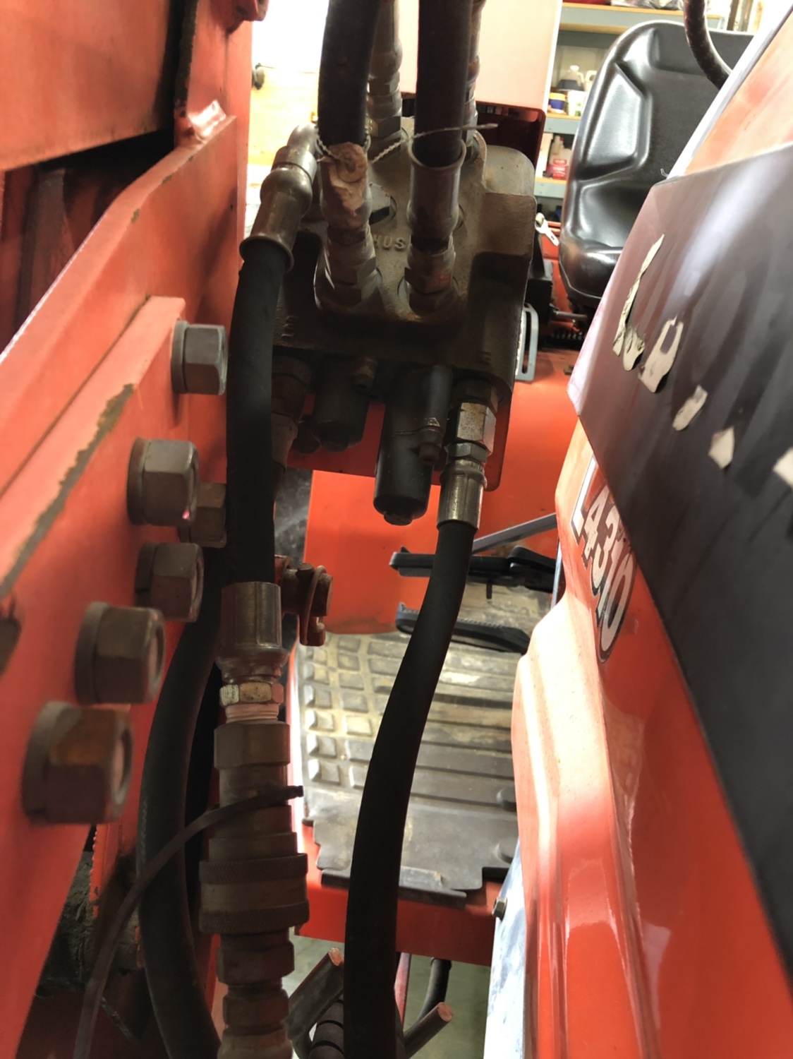

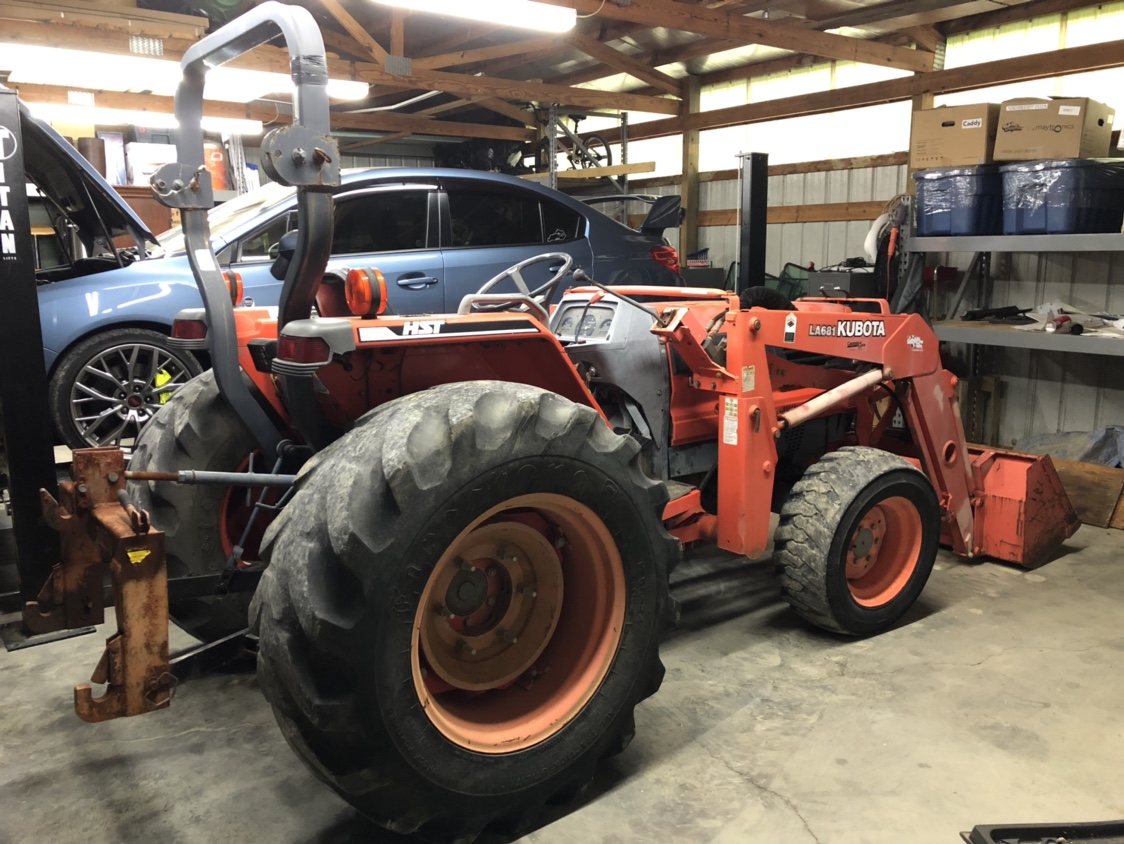

Hi everyone,
I just bought a L4310 to replace much smaller JD 2305. I would like to go through it, change the fluids and filters before doing any work with it. One thing I noticed is that the loader hydraulic lines don’t have quick disconnects. So to remove the loader it seems a bit odd to have to actually remove the lines like this? I mean it doesn’t seem like you can get to the engine to change oil or anything with the loader on it. It has only One line that has a quick disconnect style coupler. Is this typical of the age of this tractor? Sorry if This sounds dumb, I’m just looking for some help in understanding what I’ve got here and what to do going forward with regard to maintenance. This is only my second machine... (the little 2305 was my only other tractor). I need to order manuals for it... just trying to get the hang of this. Thank you.

Hello. Refrain from attempting to remove the loader. Maintenance should be doable with hood and loader up.

Looks to me like the loader control valve comes off with the loader (in the 3rd picture). And it has the stands on the loader arms.
Personally I would want to know how to remove the loader.
I remove/install mine all the time. Just like any other attachment.

You’re right. It does have flip down loader stands and except for the lines not having couplers, it looks like it’s designed to be removed like other quick detach style loader frames.
My immediate need is to just be able to service the engine and honestly didn’t see how to open the hood with the loader frame on the tractor. I’m going to raise the boom and take another look.
Having owned a Bobcat skid steer in the past, I am a little leery of working on the tractor with the boom up in the air over head. Seems awfully dangerous unless their is a safety lockout or similar to keep the boom from falling should something go wrong.

Different people have different preferences. I've had three tractors with loaders since 2002. Loaders are usually on between the last mowing in the Fall and the first mowing in the Spring. During mowing season, the loaders and frames have always been removed except when using the loader. The frame is just something to get in the way. It only takes a couple minutes to get the whole loader and frame on and off.
Access under the hood is a lot easier without the frame, and since I don't have the safety props I won't work under a raised loader. Your loader frame has a bar that crosses the hood. If you do remove your loader, be careful you don't miss the pins when taking it on and off.

I always put a couple of props 2x4's, etc under the raised loader arms when I work under the hood.

Yep, it looks like the QA is on the valve supply & return.
5 minutes to get it off and so much nicer to work on, or have it off when not needed.
/ New to This Kubota... #13
