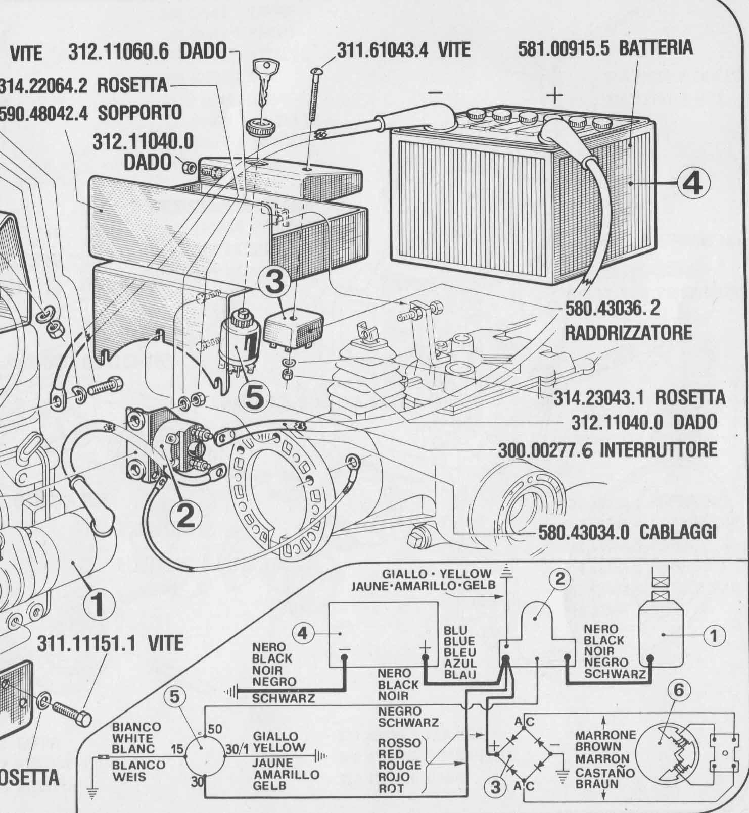

Common simple keyswitch pretty much only needs 3 or 4 wires depending on battery or mag ignition. B or Bat terminal hooks to B+, to give everything else power when the key is turned, S or ST goes to the starter solenoid and only has power when the key is cycled to the start position and I or Ign powers the ignition, and if a mag ignition it will need a G to enable shutdown by the keyswitch.
I went back out to the barn with a buddy of mine and he took the wire off that was just a jumper from one terminal to the other and moved one wire from one terminal to another one and everything seems to be working now except it don't shut off with the key. The previous owner replaced the ign. switch so the terminals don't have letter markings there are numbers identifying them only. There is a kill switch on the handlebars but it is not hooked up. The kill switch don't feel right so I think the previous owner just unhooked it and I don't know where to hook it back up at. The wire coming off of it is long enough to make it down to the little box mounted by the starter but I am not sure if that's where it goes.There is also a little white button down on the motor that shuts it off, which is what I used tonight. So now there is only two wires hooked up to the ign. switch. I don't know if this is right but it seems to be working. Whether or not it charges the battery is another question also.

Hi. I have a 735 BCS as yours ( 61858 is the serial number) Mine is a 1982 sold by Mainline Before BCS America. I have a diesel and rope start. I add a pict of Wiring. This is a Charge and start system only. For stop You must use the kill switch on handle bar. You can try( When engine is running just pull or remove the key) I recommend you to repair the kill switch on the handle bar for safety.
SAFETY Never tolerate somebody front a tiller. If tines hit a big rock or a big root the tiller can jump one feet in the air and six feets front in less one second. Good luck! Oldmech wiring.jpg

Thanks FBB, I agree with you and old mech. This thing is to fast not to have a dead man switch. If you don't mind helping me out I will buy and install all the safety parts. I am not the only person that will be running it probably and I don't want someone else getting tore up by this beast. I started it yesterday put it in fifth gear at half throttle let out the clutch and it spun the tire on my concrete floor. IT can definitely get away from you. What do you guys think about only two wires being hooked up to the ign. switch? I tested the two brown wires that come out of the engine and run up to the little box by the key switch and they are putting out 13.64 volts. I am guessing that the voltage must be making it back down to the battery through the red wire that goes to the little box by the starter. I will try to decipher from the schematic old mech. sent me to determine where the kill switch was wired. Thanks guys I really appreciate your help.
