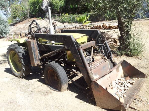

The solenoid-looking thing is your clutch safety switch. It looks like it has been bypassed. I was severely tempted by that particular machine and almost went to buy it; I think you got a good deal. It has regular R1 "tractor tires" on it, with a set of turf tires as spares. It's an early model, at least on the hood, but has a tall snorkel-type air intake that looks similar to later versions. The loader is a heavy aftermarket unit with a large reservoir on the right side, but the tractor was missing the lower lift arms and side links, if it's the same machine.
From my experience with a loader-equipped YM240 and turf tires, even when the tires were filled with water I struggled to pull a small disk that would cut deeply enough to do any good. The combination of the front bucket and slick tires made it rather useless for that application. Adding R4 tires helped, but my YM240D has conventional R1 tires, and pulls better in 2wd with those tires than the other machine. Your outcome may be different, but that's how it went for me. :)
If I were getting new side links, I would order a set from Hoye that have an offset. Regular ones will work, but I like to be able to narrow up my tires to drive into a ditch the width of my bucket, and with tires at a narrow setting they rub on my lift arms with some implements.
I wish I knew what to suggest for weed control. Copious amounts of money spent on pre-emergent herbicide is probably the best, unfortunately, if you won't/can't have goats or, perhaps, a bunch of geese. I have better luck with a scraper than a disk for weed suppression, but it doesn't really work that well. At some point I'm going to build an attachment for a box blade that pulls a cutting blade that just lifts and scrapes the weeds, and doesn't drag the soil.
Before you work it too much, it's probably worth your while to pull the radiator out and flush it and the block with a hose. I like to run one of the cooling system cleaners through it, then flush and fill with distilled water, antifreeze and some surfactant of whatever is on sale. ("Water-Wetter" is the best known.) It's smart money to make sure the water pump is in good shape, you have a new, quality belt, and the radiator fins are straight too. I think overheating from insufficient/absent cooling system maintenance kills more of these little tractors than anything, so I try to keep it in good shape.

Yes 284, its the same Tractor with the missing links for the 3PT system.

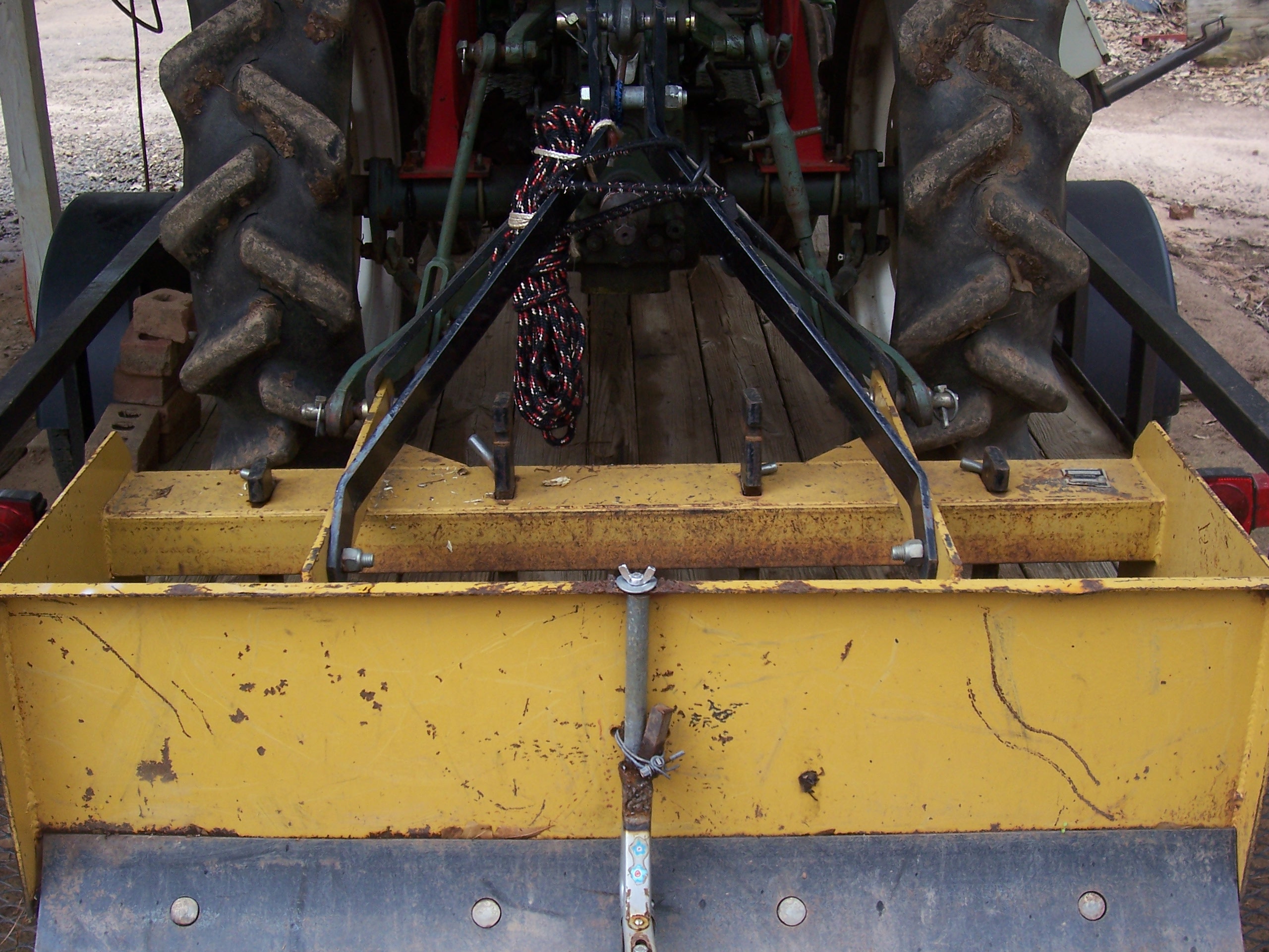

Once you get the 3pt. up and working and try a Box Blade you may be supprised of what you can do with it. If you set the the Rippers deep enough to dig the Roots up the Box will most likely catch and collect the Weeds/Roots and level the Dirt back. But with Turf Tires it may be tough to do since your loose alot of traction in the Sandy soil. I Grade a good bit of Crush and Run "Sand and Gravel Mix" on my small Road and Drive way. With the weight of full Box it would be tough to do and my guess is you couldn't keep much in the Box to level the Dirt from the Lack of Traction. You can see the Adjustable depth Rippers and How much Traction your giving up With Turf Tires compared to Orig. Ricers. And pay no Attention to my Lawn Trailer hookup. Hey it works great to carry you tools in when your out and away working:).

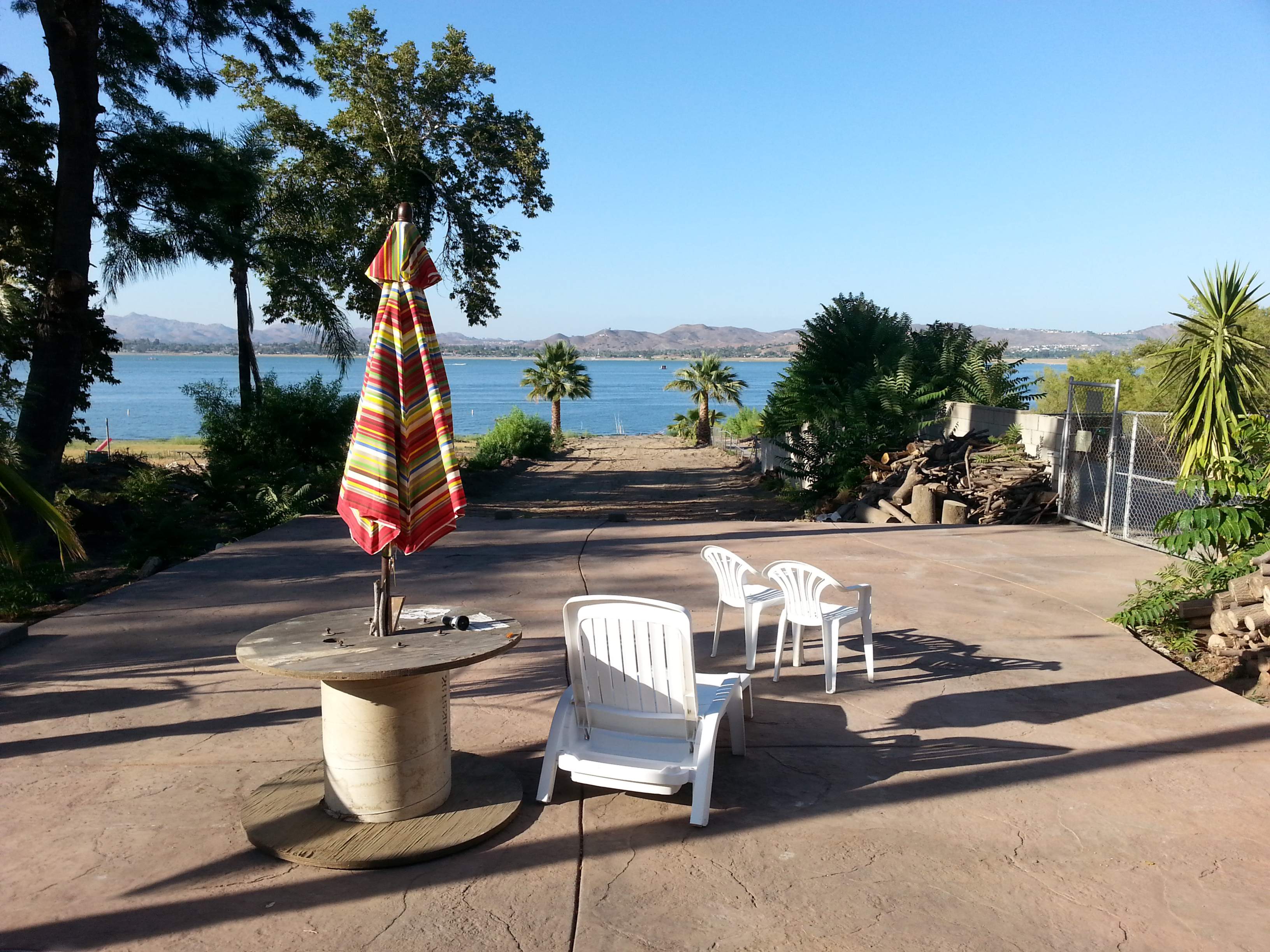

Its about 400' to the lake but hard to see as the land drops away in that pic
This will be the before Picture, tough old girl before the Makeover.
