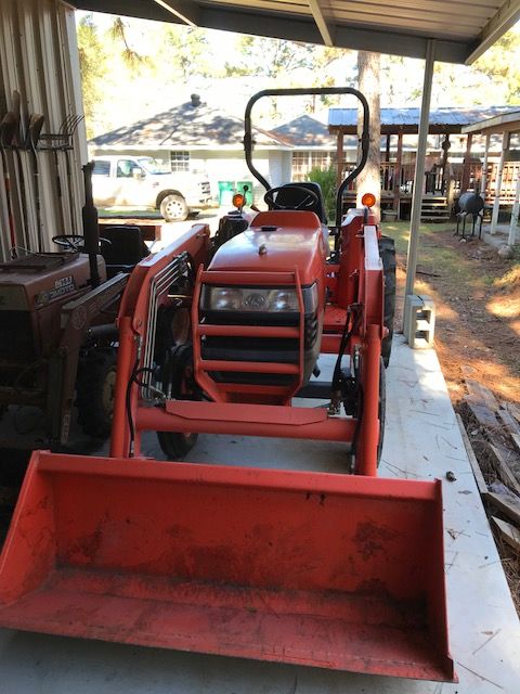

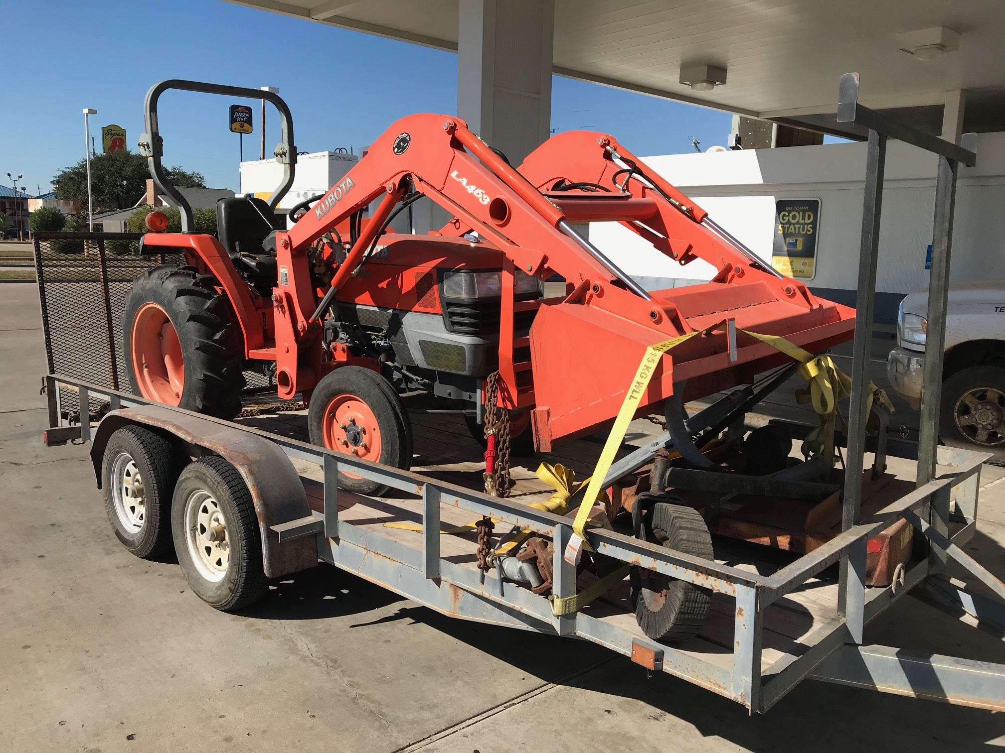

Here is the only picture I have right now, will try get some more when get a chance.
Like I said it is sun faded, been sleeping outside for 10 years, luckily in west Texas with low humidity so no rust! This was while bringing it home.
   / new to me tractor #14
You might want to ask Santa for an LED light to clamp on your roll protector. My bucket interferes with the light, and yours is quite a bit larger. Also, it looks like time has got into your headlights and smoked up the lenses.

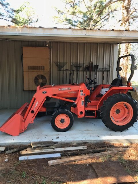

OK here is the Tractor **** I said I would get LOL!07Kubota1.jpg07Kubota2.jpg
