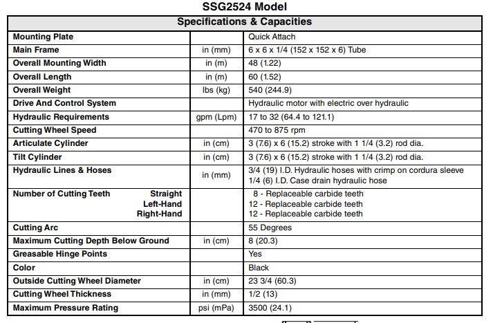

I've had no problems with mine. I have the larger Landpride. SG 50 maybe.
Interesting, it looks like they only have one size, but two different model #'s. It's looks like the only difference is the range of cutting arc (35 vs 55 degrees) and one is quick hitch compatible.
Is this the one you have?

No, mine has 55 degree swing, goes 10" below grade pto driven and is quick hitch compatible but I don't have a quick hitch and the one I have is Cat2. I special ordered it direct from Great Plains btw. Mine takes a pair of hydraulic outlets (4 hoses). Had to change them from flat faced to Pioneer release under pressure. Both the elevation and swing can be modulated too. Mine is Kubota orange to match the tractors too.
Have to take a picture of it...

I'd love to see a photo. I like to learn about these things, and it sounds like you have one that I've never heard of. Perhaps it is closer to the Shaver specs than I realize.
Most of these grinders are very similar, with the exception of the Woodland Mills, they most all of the up/down and left/right circuits. The big differences are the build quality, whether it's meant for residential or commercial, and the size tractor they are meant for. There is a huge difference between your Landpride and the Shaver that the original post was about.
All these grinders have model #'s pretty clearly identified on them, it's quite simple to find. I'd be very curious to hear what your model is, or if it was a custom built grinder by Great Plains Manufacturing.
Could be, I don't know actually. Told my Kubota dealer what I wanted and he ordered it and delivered it to the farm. Works fine for me, I just have to be careful about how hard I push it. I was thinking about putting it on my other Kubota and using the 1000 rpm pto running at 540 which brings the engine out of it's optimum power range and drops the horsepower appreciably but for now it's on the back of the open station running at 540. Only thing I really use the 1000 rpm pto is for powering my grain leg.
