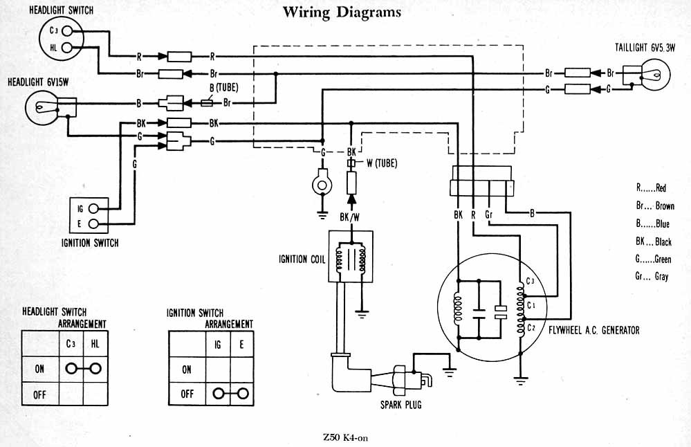

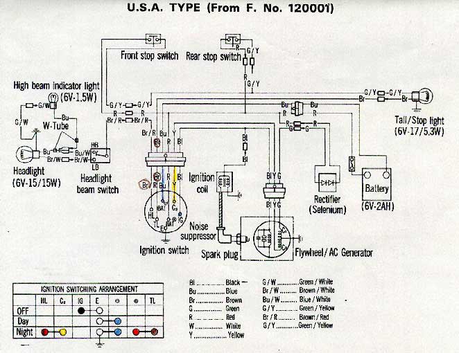

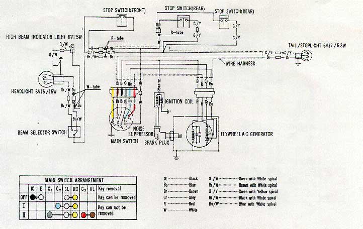

I had the same ignition issue, but due to the key being lost and not being able to get the proper switch. I used the diagrams below to make the conversion, the first one is the one from the Mitsubishi service manual.
/ New to me mt160 #3
Whoops, the last three were for my sons Z50A, not the tractor.

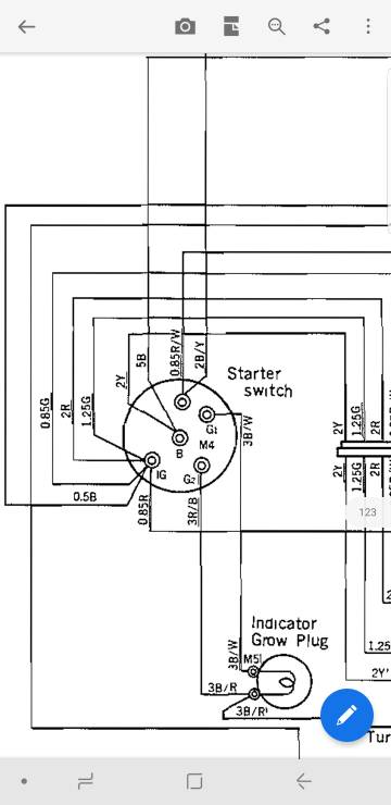

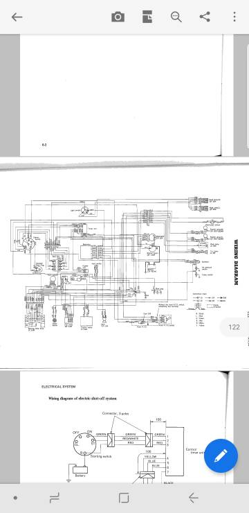

They need to be connected to power momentarily, if you note the conversion image: power is supplied on TS (glow), and on the start position.
When the tractor is running there is no power to these.

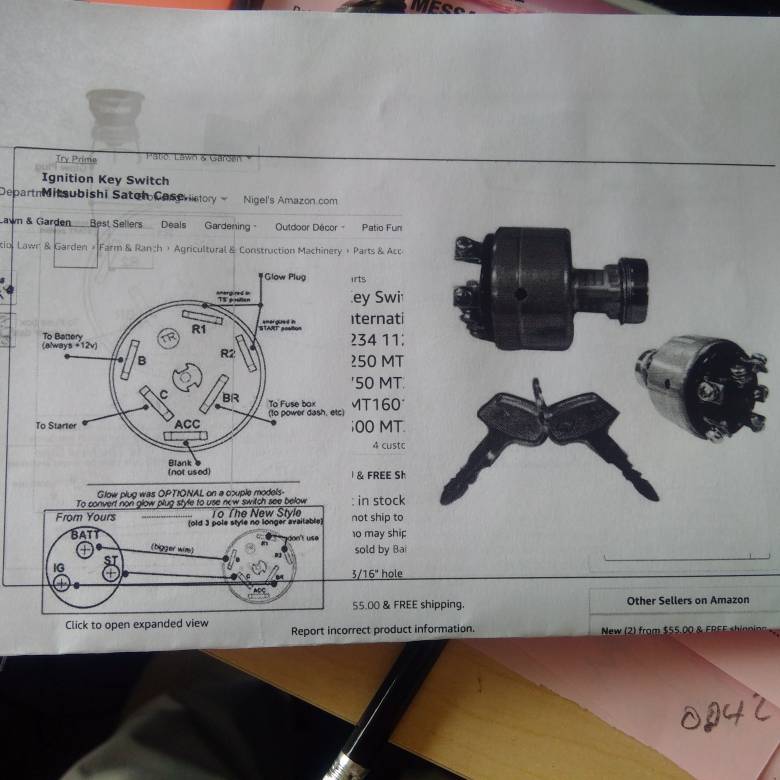

Not sure if this will zoom up enough, but I cant extract the page easily on my phone.Screenshot_20190103-174039_Adobe%20Acrobat.jpeg
/ New to me mt160
This is what I got.
Based on the Diagram
Old Switch = New Switch
Center B = Bat ( Yellow, Black)
Unmarked = ST ( B/Y, R/W, and I think they added a RED extra hot line direct to starter. ) There is a B/W line and red line at the starter solenoid. -- I think this overall is wrong in some way. Like Maybe they should be on ST and IGN.
IG = ACC ( Red, Red, Black, Green, Green)
G1 = N/A (B/W)
G2 = N/A (B/R)
= IGN on new switch unused
I thought the stuff on IG would go to IGN but it seems to be the lights and things.
Could I add the 1 line (B/W) to a switch that has 12 v power? Seems like they are flips of the same circuit one side bypasses the glow indicator. So couldn't I attach the R/B direct side to the ST Circuit?
Appreciate all the help. If this isn't worth the effort it might be feasible to find a replacement OEM switch, as opposed to this universal.

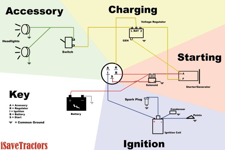

ACC is usually accessories, you would not want to attach your glows to this as it is always on. It's for lights and stuff.
Maybe this is a better image for yours:tractor-wiring-starter-gen-copy-web.jpeg
/ New to me mt160 #9
Ideally you would pick up a proper diesel ignition switch.
The glow plugs have two momentary signals: the 5-10 seconds on the glow position and the 1-2 seconds to aid the start position.
The rest of the time you want your glow plugs off. There is no reason to heat after the engine has started.

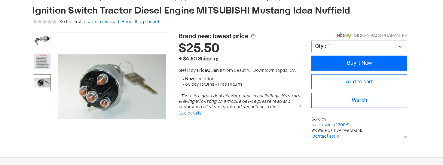

/ New to me mt160
Gotcha

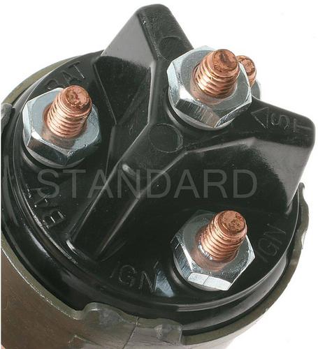

Here is what he says it is. Is there a better option?
It looks like I could add the B/R to the IGN pin and that would give me the temp start for the Glow Plugs during the Start Cycle .
Thanks again you're an amazing help.
/ New to me mt160 #11
Can not read what the text says in the image.
Any generic diesel ignition switch will do, just might have different pin markings is all.
/ New to me mt160
#12
Thanks I'll see what I can find.
The text claims its a Mitsubishi Ignition Switch. But I think it's far more generic.
/ New to me mt160 #13
Glow plugs draw considerable current so generally you'd want to use a relay,
That being said, any momentary switch to control the relay with U as the timer will work, i.e. counting off , say 5 or 7 seconds B4 attempting a start.
Naturally you will protect using appropriate fuse or breaker.
With the above in mind most ignition switches could serve the other functions.
