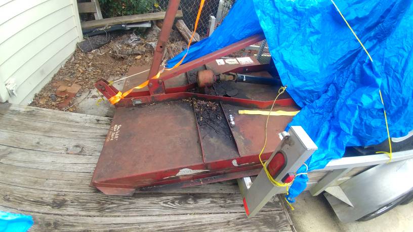

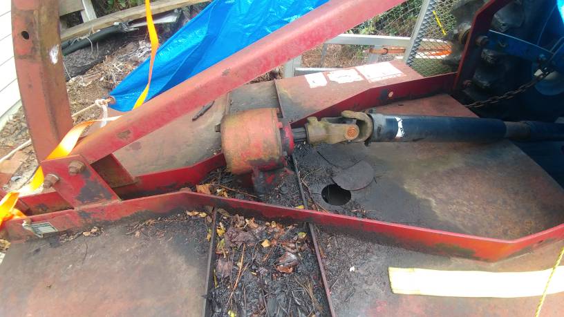

This may be a "Tiger" model Hardee Rotary cutter, yes I know I have a leak in the upper seal.
I measured what remains of one of the remaining blades ( so worn they come to a point) looks like 20" with at least 2 " to the inside of the cutter. 0112201248.jpg0112201248a.jpg
   / New to me Hardee Rotary Cutteer #6
Looks like a C-60, model tag with serial number is visible on upright welded to deck near rear wheel mount
Boy do I feel like a dummy, I thought I looked everywhere. It is C-160-It. Thanks everybody.
