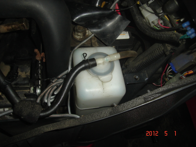

2.) Is my reservoir tank cap broken?

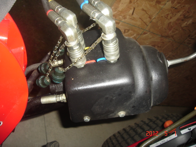

4.)I've seen some controllers with a plastic cover and some without, this is an earlier GC2300, am I missing one?

You should get a manual for the tractor at least, FEL and MMM maybe, service manual if you think you need one. My dealer let me use theirs anytime I need it and so far have not needed it. The The overflow hose is broke off the cap should not be a problem. The handle is to release the front bracket for the MMM. The cover for the FEL controller is there for looks and to hold the color codes for the hoses. Make sure you mark the hoses so you do not get them mixed up. Skid plate is up to you I have 670hrs with a lot of FEL and BH work and have not had a problem with the filter. If you are planning to go into the woods with stumps I would think it. The fill for the hyd. fluid is in the middle of the rear under the rear sheet metal and 1/2 glass is fine. The way I use the PTO levers is I select the PTO lever I will be using 540 rear or 2000 mid (MMM) and then only use the main PTO lever to start and stop the PTO selected. Yes the MMM is loud, you have 3 large heavy blades spinning but check the idler pulley there is no drain hole in mine and water can set in the pulley and can get into the bearing and ruin it. I had to beg my dealer for a hat.

Here's what he coolant bottle looks --should look-- like. The broken part is just for the overboard overflow tube (clear one). It just goes down to drain below the frame.
Right on about the colors on the plastic cover- here's what mine look like, but there have been some color codes on these tractors that weren't labeled correctly....
