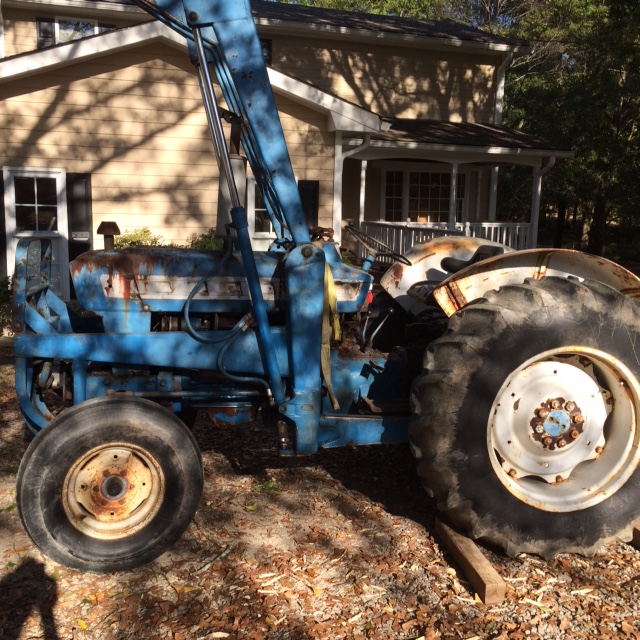

I don't plan on parades, but some fresh paint eventually would be nice of course I am having a lot of fun without paint. Also apparently the wife likes watching me riding around the property on it that's a major plus ;).

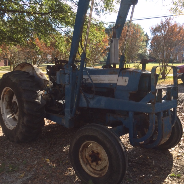

Changed the blown out oil filter gasket & filter, changed engine oil, cleaned out the oil bath air filter plus new oil.
Had to replaced the battery, old one was leaking from damage due to formerly burnt wires. Since I don't currently have any implements I ran it in High, low, pushed over a sizable pile of wood debris checked the temps all over with a infrared thermometer. Factory gauge right on the red line when I took the readings so apparently the factory gauge is not accurate currently.
140-170ish oil pan
140-196 head block
340 ish exhaust right at center of exhaust manifold
on to other things when some money comes back around, lots o leaks
Didn't change hydraulics thanks to battery cost, but checked trans & differential. Differential is really foamy after just a few minutes moving to a flat spot to check is this normal?

She looks like a "Queen" to me!!!
