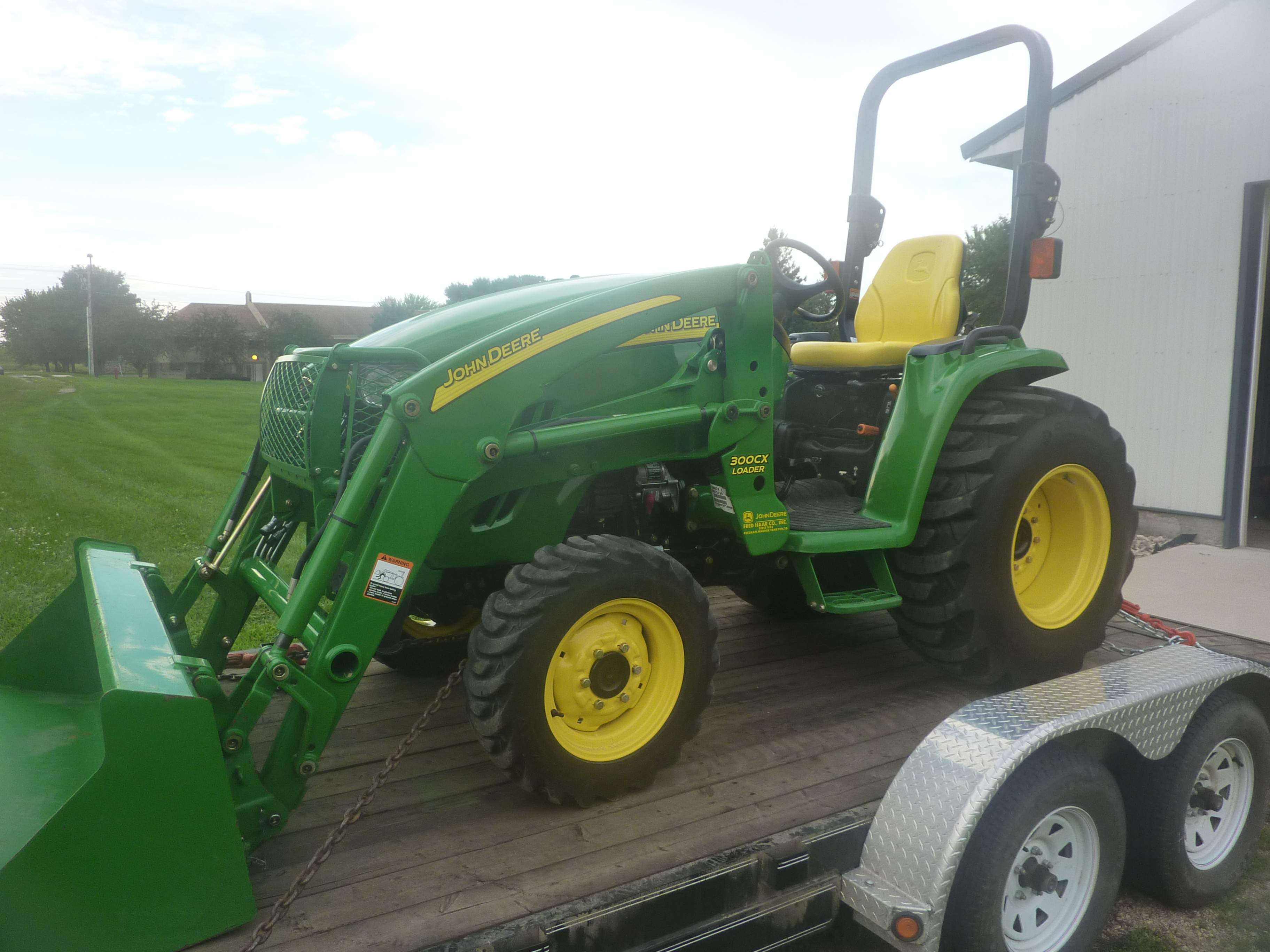

I finally located the 3320 I was looking for via the Tractor House site. It only has 230 hours on it....and looks like new. Has the right stuff for my needs, eHydro, 300CX loader, 3rd remotes WITH hydraulics to the front via optional JD lines, block heater, HD Grille Guard, Big R4 tires and more. It's all ready for that Markham 48" grapple. :D
The one thing strange was that this tractor has the "standard" 61" bucket. I would much prefer the HD bucket....but it wasnt a deal breaker. I'm going to beef it up bit. I think if I put a channel along the top, add a strap to each side and put my modified tooth bar (from my 790) on the bucket....I should be good to go. (?)
I'm happy that I found a nice clean used 3320 at a fair price. :thumbsup:

230 hours!
Did it spend it's entire existence idling in a garage?
Way clean.
Congratulations, looks brand spankin' new.
/ New to me 3320
Yep...pretty clean for and 06. The former owner did some brush hogging and used it for snow removal. He bought a 4X20 with a cab to replace this tractor. This tractor has spent most of its time in a nice shed. :thumbsup:
