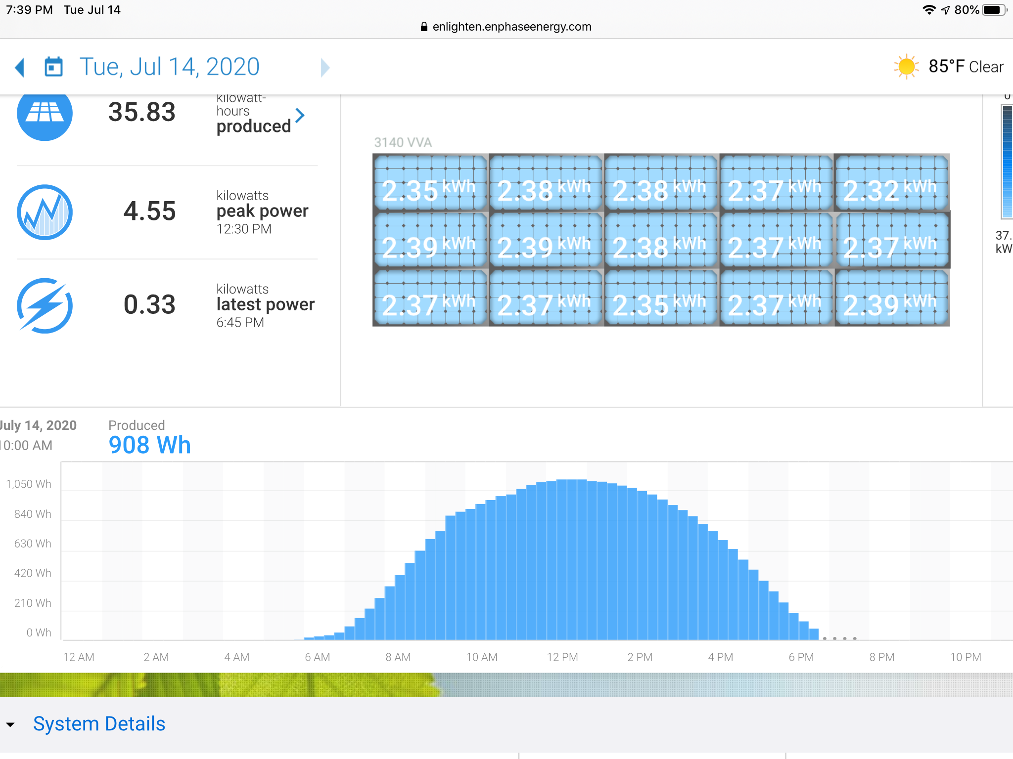

I just got my PTO a couple of weeks ago. Right now SCE sez that my current bill is $0. Desert sun is great as I am getting many hours of production per day.
   / New to Grid Tied Home Solar... #130
Being in the desert, can you run ac units with solar?
