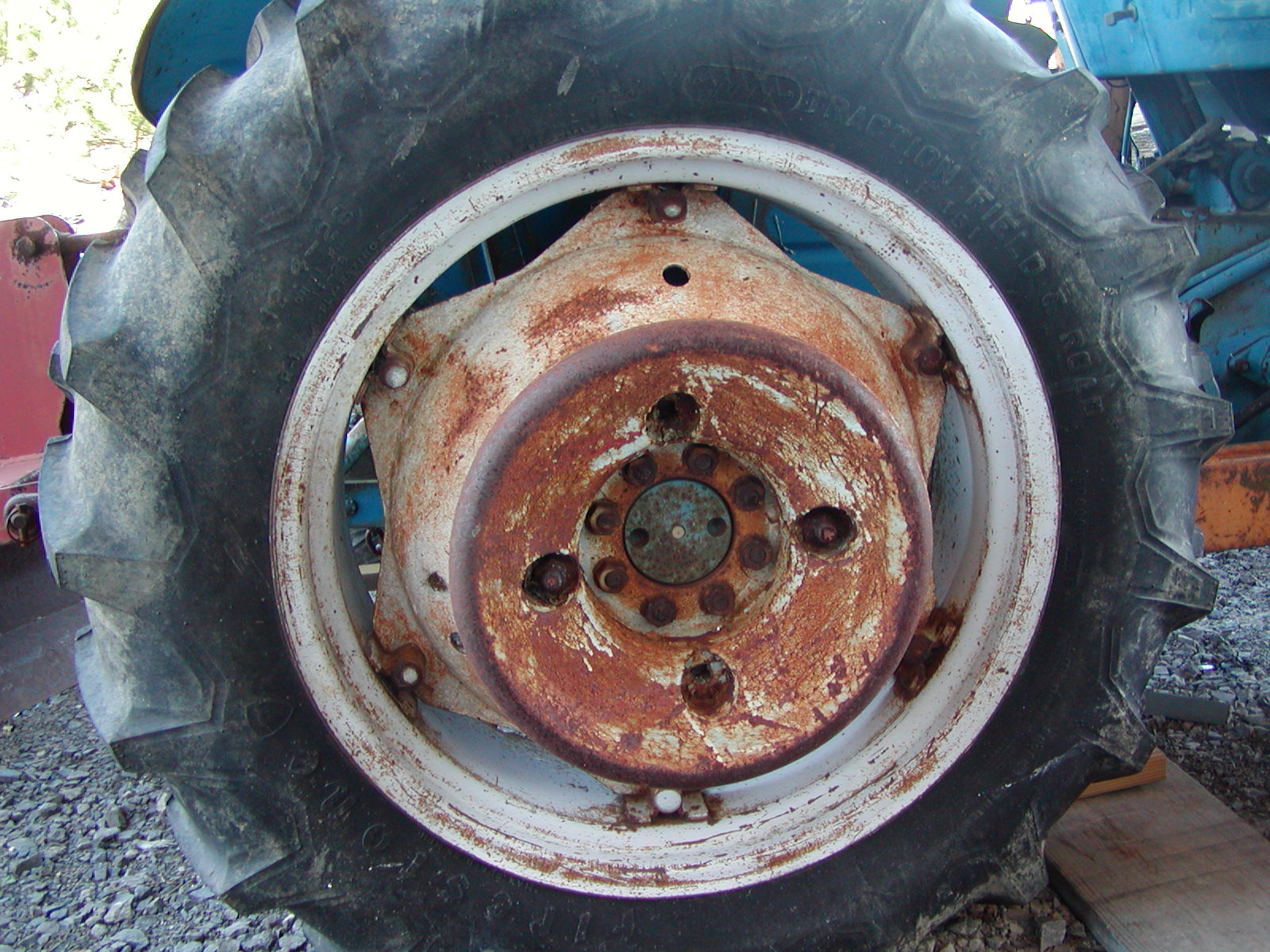

post a pic first.. next.
does it have a hand brake on the left side at about the running board level where a foot would set ahead of it?
how many lugs on the rear hub.. and what size rear rubber?
post back
pic of sides and front and rear hub..

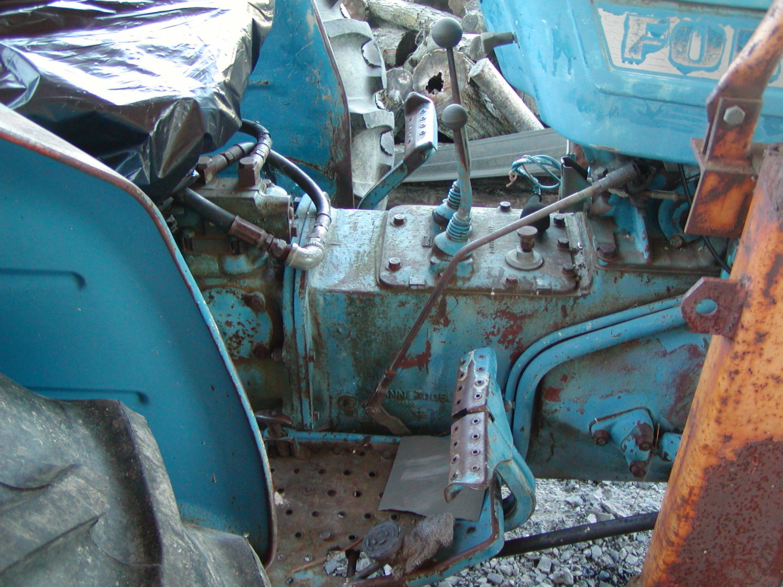

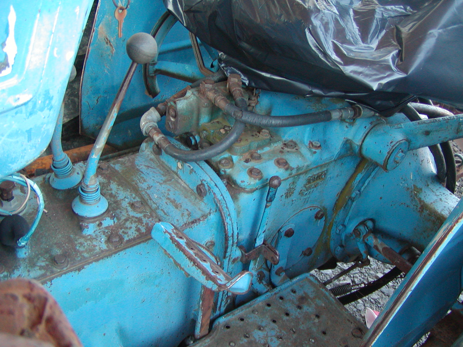

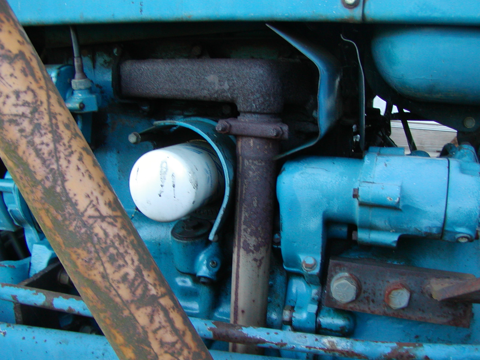

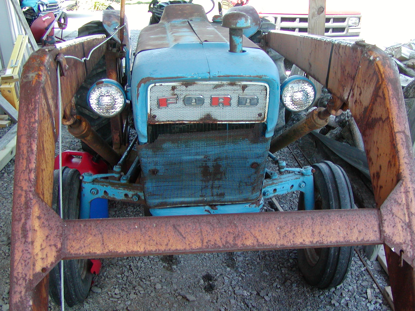

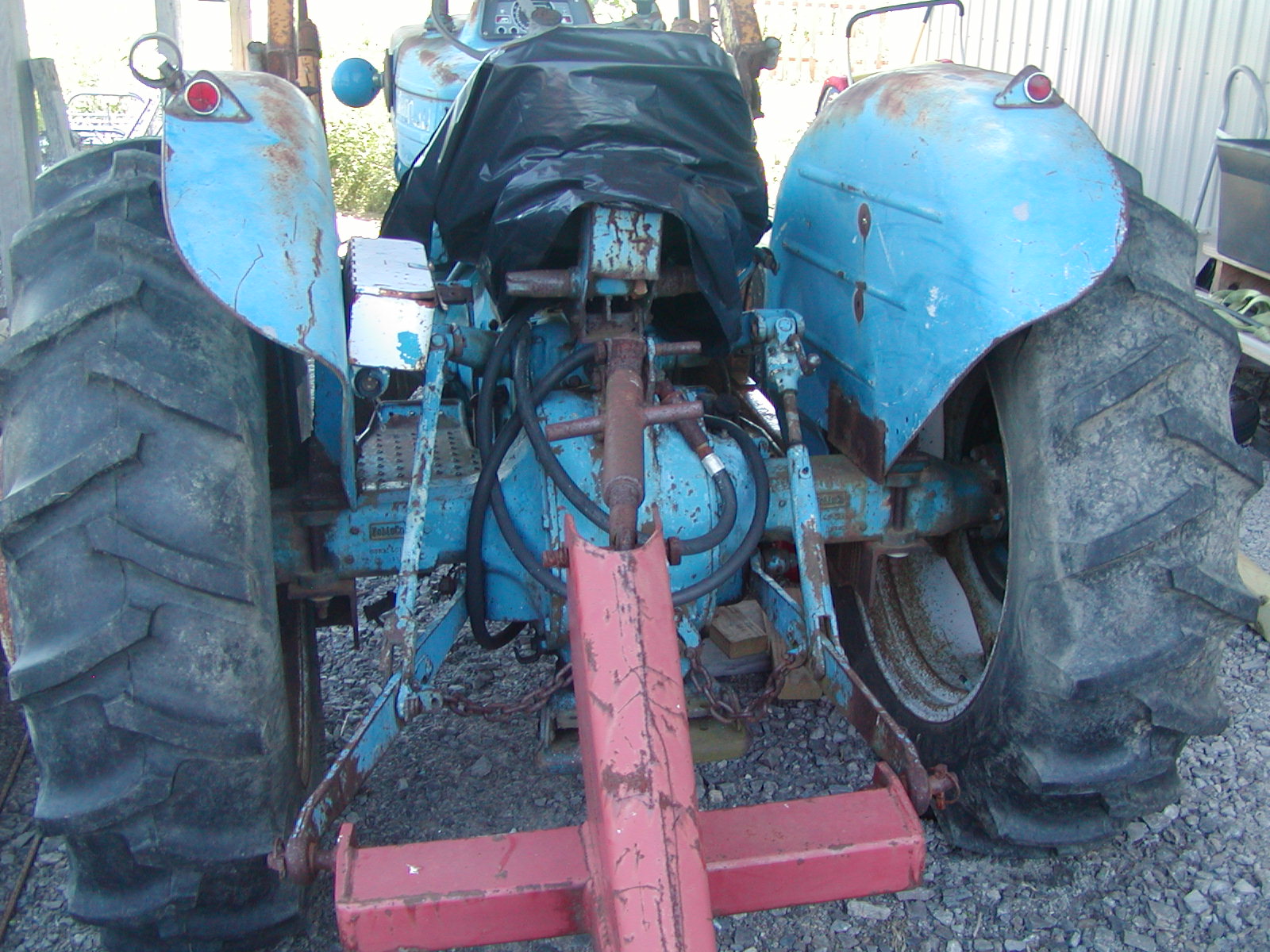

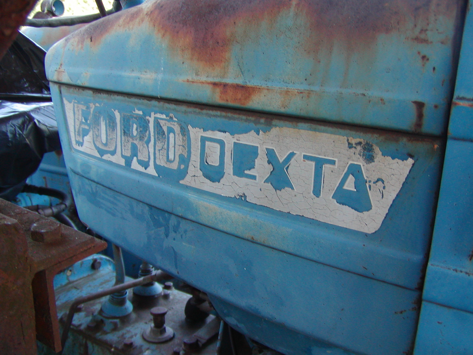

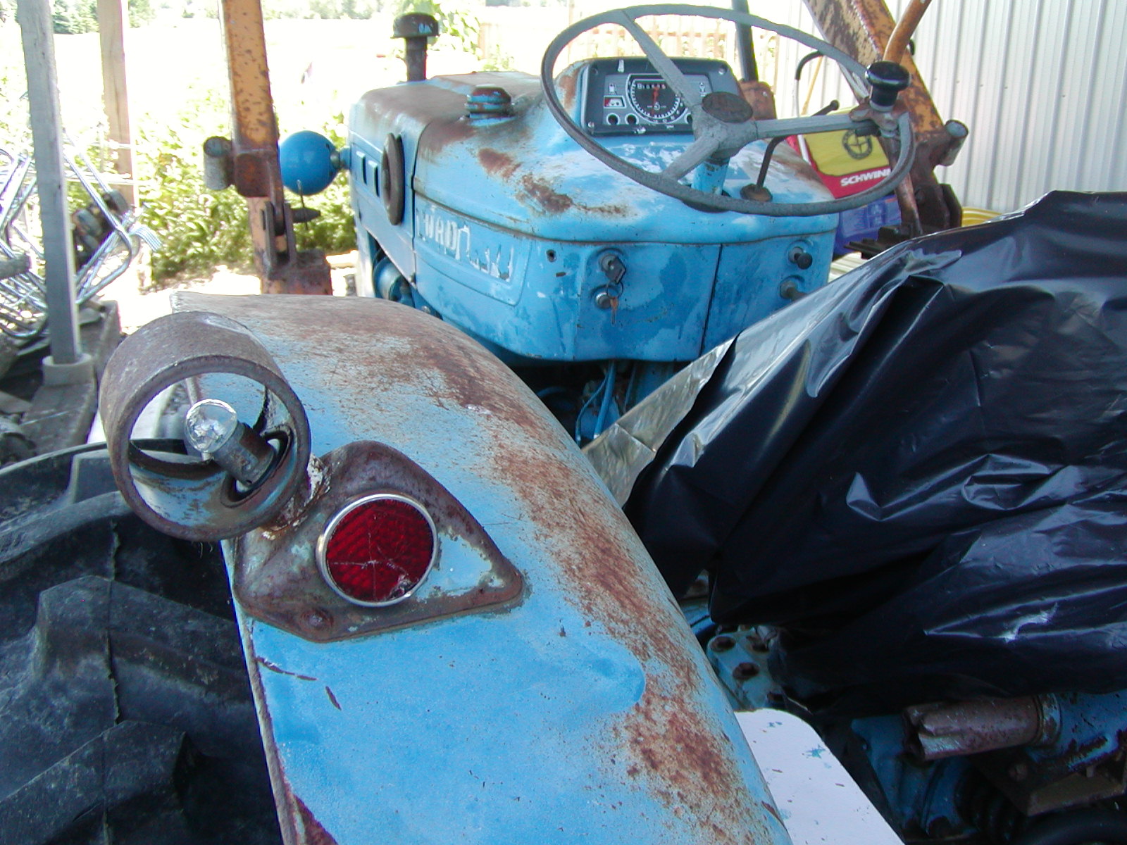

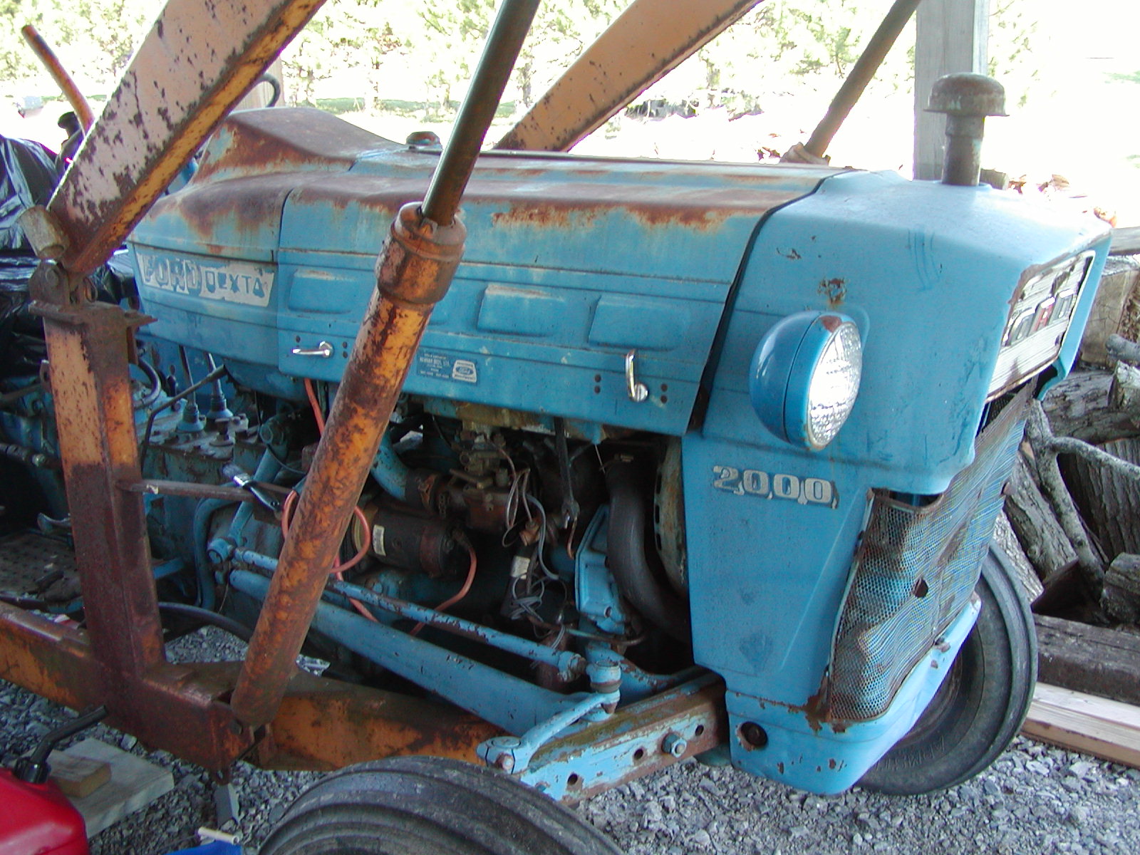

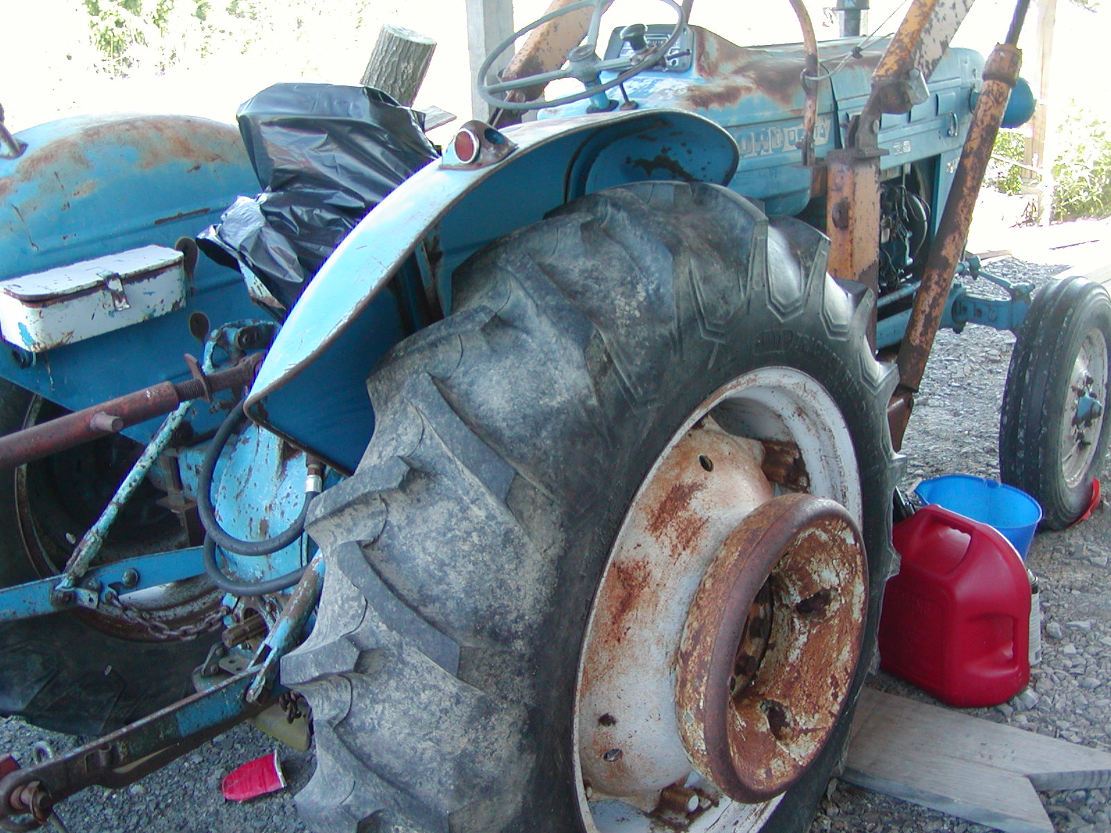

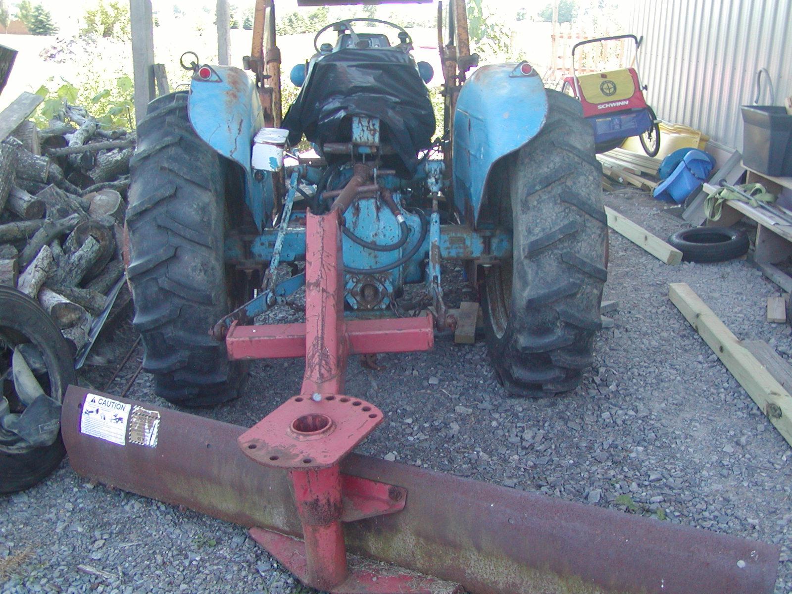

Thanks for the quick responses.
I had to go and get new batteries for the camera. Figures, doesn't it?

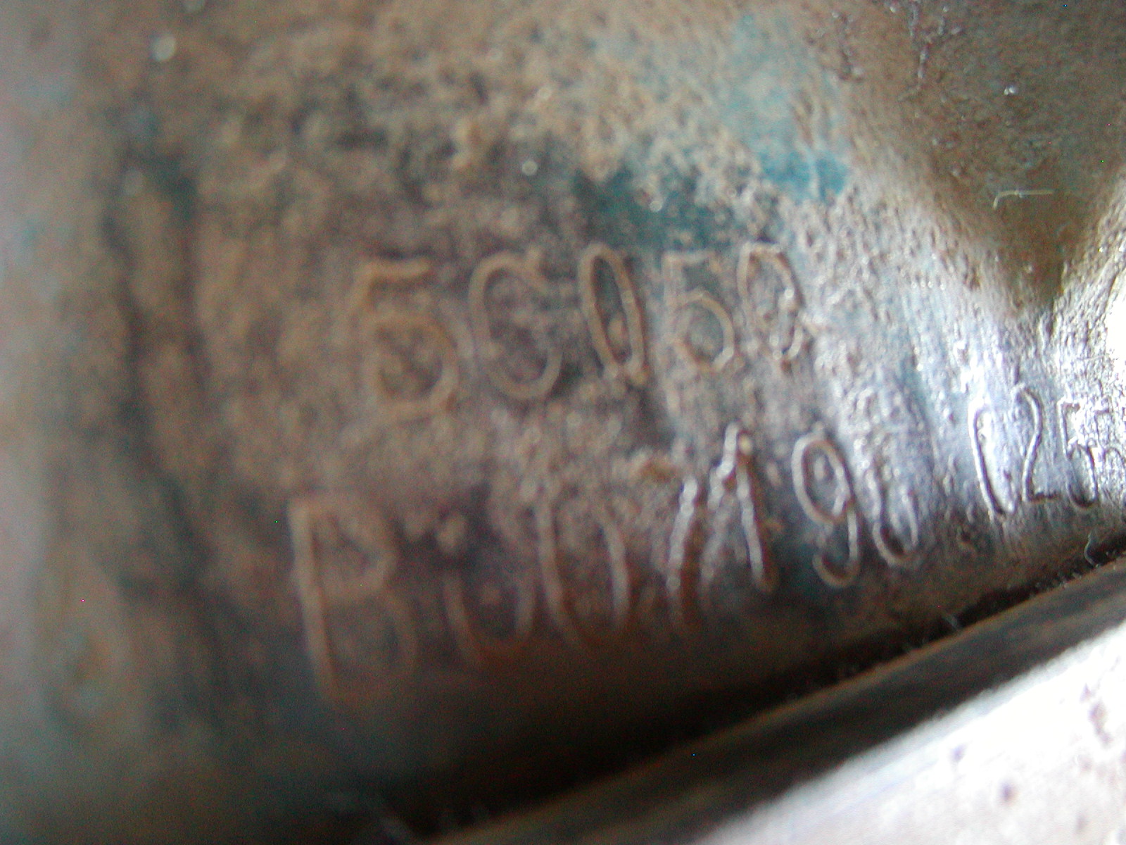

I have taken several pictures of this old girl, and hopefully they will help. One of the pictures is a close up of the numbers at the rear of the starter. Not sure if they are clear or not.
But, if so, you will see why I have been confused. The pictures show the decals of both Dexta and 2000.
To answer Soundguy's specific questions: I see no hand brake on either side. Pictures will verify this. There are 8 lugs on the rear wheels hubs, and the rear wheels/tires are 12.4-28 on
11 inch rim 11-28.
Hopefully the pictures will help. I also have a lot of numbers that I have found that are cast into the axles, diff, transmission, etc. Even have a cast number on the bottom right (?) side of
engine. It is C5NE 6015 A T1. By the way, when I read something is on the left side of the tractor, is this looking from the seat or from the front of the tractor? Told you I was new.
Now I'm not trying to jade anyone's opinion here, but I realize that this is a probably a tractor built in England during the transition from there to the states, from Dexta to the 2000 and from
Fordson to Ford. I am almost certain that this machine at one time was in Canada. I read a small blip a couple of weeks ago that had two guys that commented on this transition time. One said that most of these transition tractors were diesels, with a few gas 4 cylinders. Then there was just a mention of the 3 cylinder gas engine and one guy said that as few as 50 may have been built, and the other guy said there may have been as many as 1200.
I have no idea where they are getting their info.
Thanks for your time, effort and knowledge.

   / New To Forum with ??'s re: Dexta 2000 #5
that 2000 is a 65+ she's a 3 not a 4 cyl.
a tad on the rough side too.
hood agrees that she is pre 4-68
   / New To Forum with ??'s re: Dexta 2000 #6
Agree. Cast shift cover dates it as a early pre-force Thousand series. Despite the decal saying Dexta, it is not what most of us would call a Dexta tractor, but simply a 3 cylinder 2000. Whatever posessed somebody at Ford to call the early 2000's "Dexta's" and early 5000's "Super Majors" has always baffled me. Both are vastly different from their predecesors with the Dexta and Major names.
OK guys, thanks for the time and expertise.
Now I have a few questions. Do you agree that the numbers on this old girl says that she came from England? B007195. Basildon, England.
And if that is true, and the English dated the same as we do, then this tractor was assembled on March 5th, 1965 on the afternoon shift?
I can't date her any later than that, none of the grill parts that I have looked up would indicate that. There is no plastic in the two piece grill.
I have no idea what the C255 number cast there means.

   / New To Forum with ??'s re: Dexta 2000 #8
same service manual covers the entire year range of 2000's
basildon england built unit.
not uncommon or rare..
