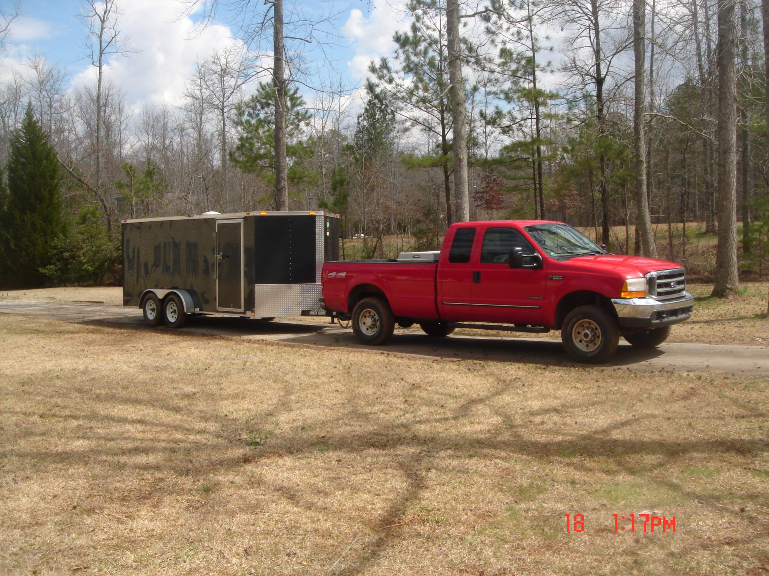

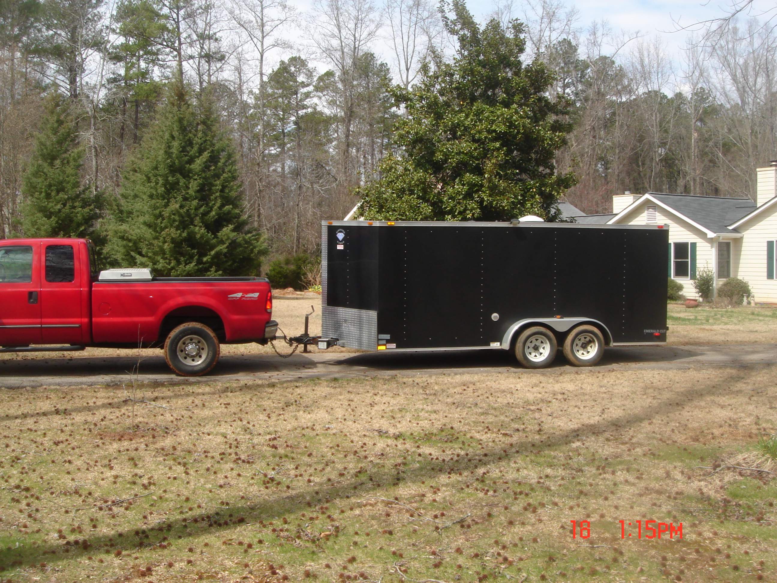

Well it's time for new tires on my cargo trailer. The trailer currently has bias ply 205 75 R 15 load range "C" tires installed, with dual 3500 lb. axles - brakes on both. Of the 4 tires none of them match as far as the manufacturer. This trailer spends allot of time on the interstate at 60 - 65 mph carrying tools for house renovations. The trailer is equipped with tool, hardware, and pipe racks inside. Very rare that it's loaded with allot of weight, but I want to be able to load it full of furniture if needed. So if you were buying new tires would you go with radials, or stay with bias ply? Would you stay with the 205's, or move up to a 225 load range "D" tire? Other suggestions?
