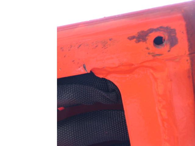

Well I finally remembered to check my kl130. Yup, it has the reinforcement and it also has cracks. /forums/images/graemlins/frown.gif (I took some pics but I can't find the cable that goes from the camera to the computer right now. I will post them later when I find it.) There are two larger ones on the left side of the tractor as you sit on it and the right side has smaller ones. It is cracked right where the reinforcement ends. I will be contacting my dealer tomorrow to see what he says. It will be interesting to see how this gets fixed since it had the reinforcement.

I purchased this in late October or early November, can't remember of the top of my head but DEFINITELY less than a year. Well here is the first pic. This is the left side which is worse. (Hopefully this works, I've never attached a photo)

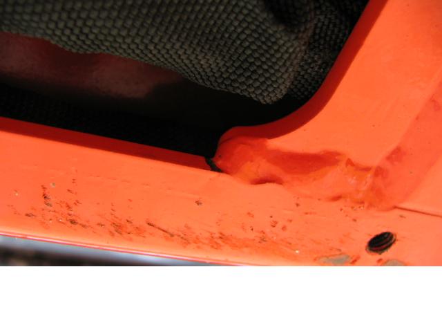

Here is another of the left side upper maybe closer view?

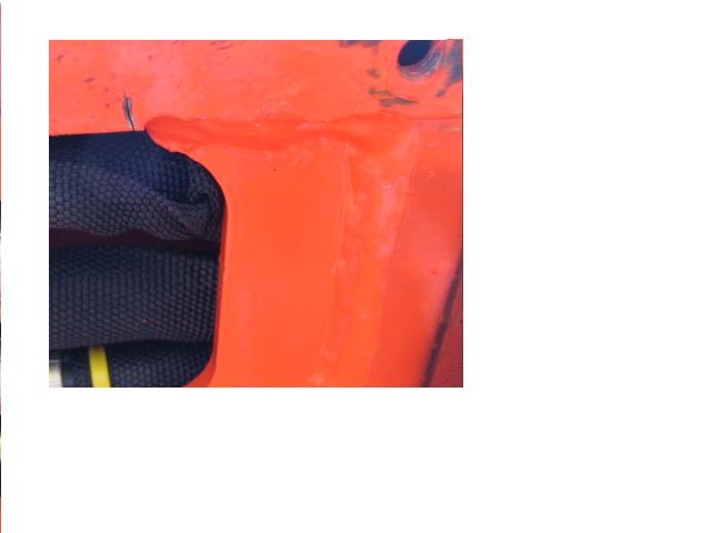

Here is one of the crack below that one on the left side.

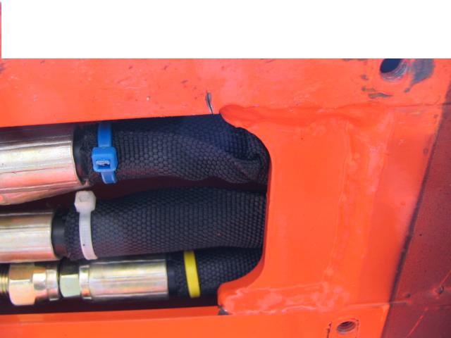

Here is one on the right side. This is the smaller on kind of hard to see. I also accidently deleted the photo of both upper and lower on both side. I am so not computer literate. /forums/images/graemlins/confused.gif

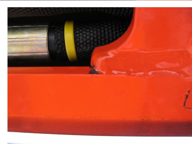

The last one.. I found one which shows both on the left side.
