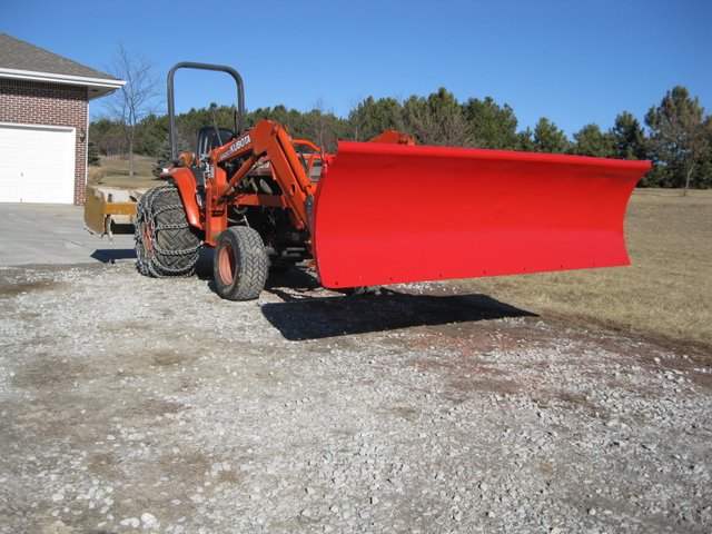

Here's how it looks after the first coat of paint. Hopefully I'll get the second coat of paint on tomorrow. Then I can start working on getting the hydraulics hooked up.

That ain't Kubota orange!!
   / New snow plow project for your viewing pleasure #27
Nice job.
All thats missing horse shoe for luck,by that I mean..whew I was luck I miss the mail box,auto etc. when plowing at night. ;)

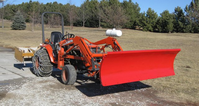

Second coat of paint. Now on to the hydraulics.

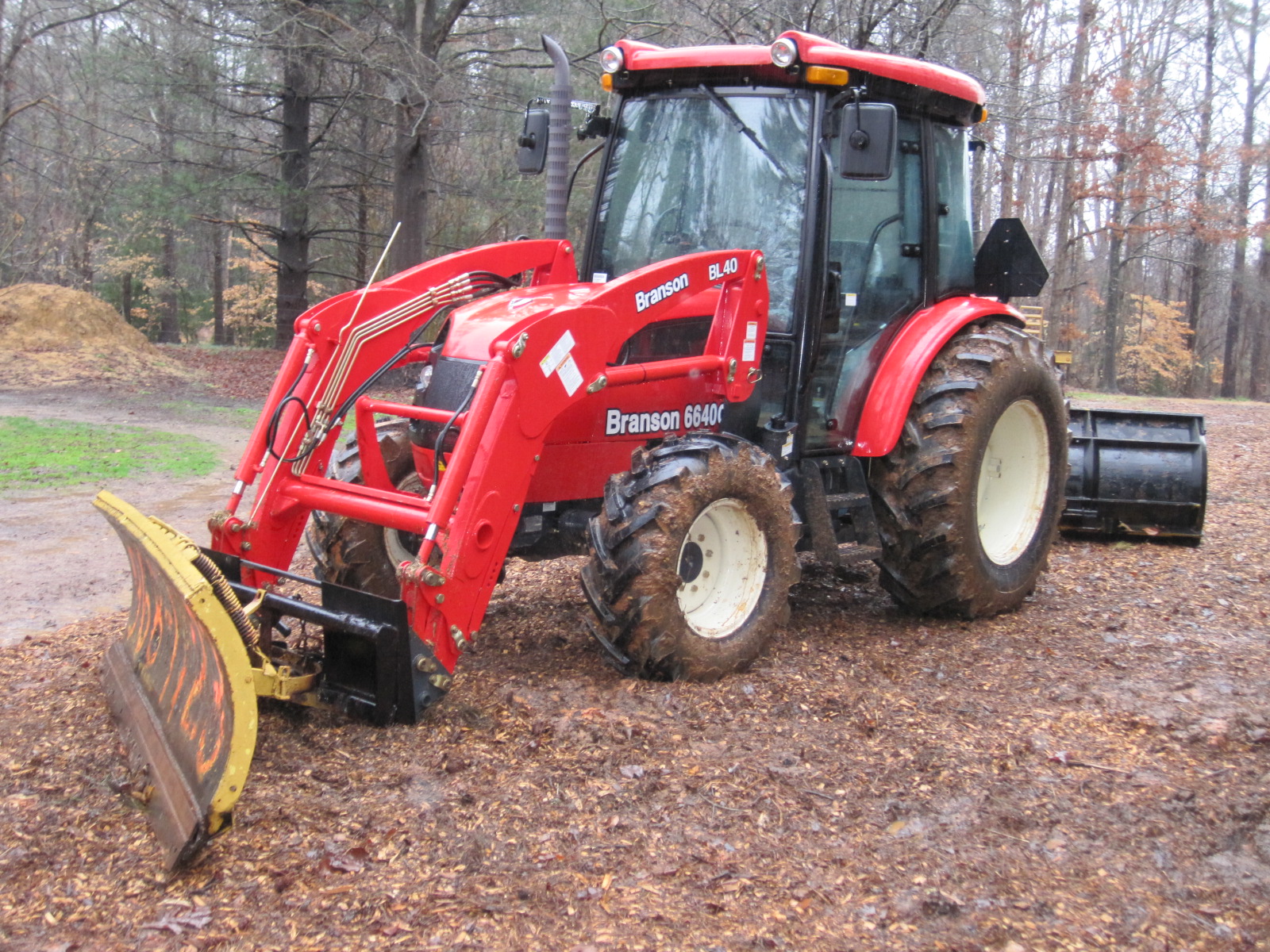

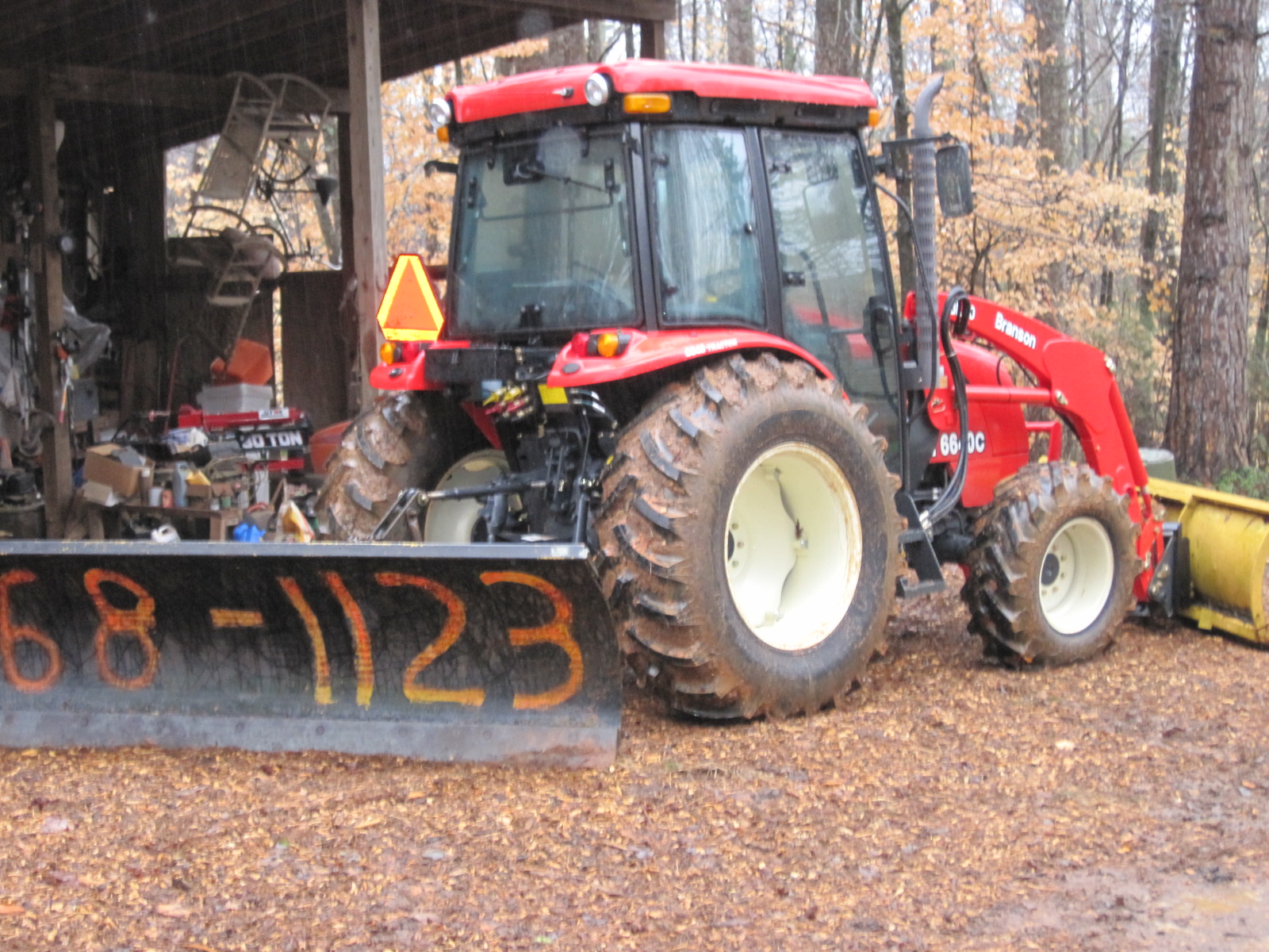

We were promised a pushable snow last night but it missed me by 10 miles. All dressed up and nowhere to go. So, I thought I'd post some pictures anyway. The front old western? plow was inherited from my father and has now been refitted on my third tractor, This time a Branson w/ QA loader, which makes switching a snap compared to lining up the old pin on rigs. The rear blade is an old State surplus highway blade a got for $125. I bought 3 of them(2 for my buddy snowplower) He made one of them into a snow pusher. Anyway, with blades front an rear, you can windrow a parking lot by just putting it in reverse and backing up instead of wasting the backup time. I bought the universal attachment plate on Ebay and had it welded to the front plow. Now all we need is snow! We got zero pushable last year.IMG_0283.JPGIMG_0279.JPGIMG_0281.JPG

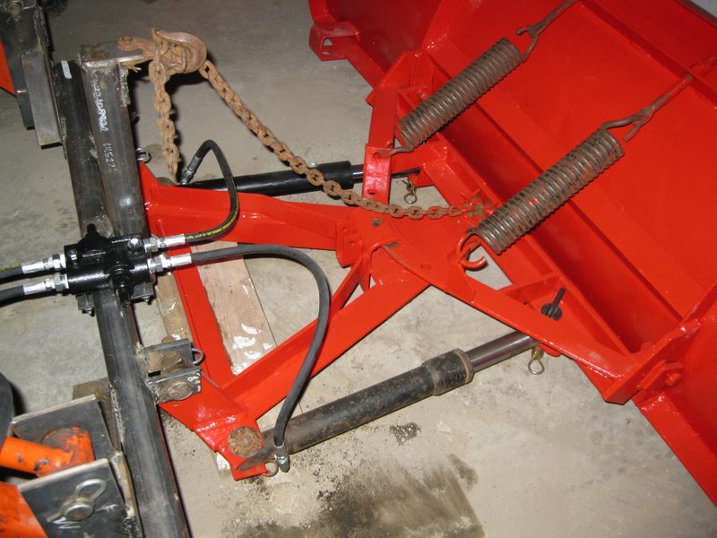

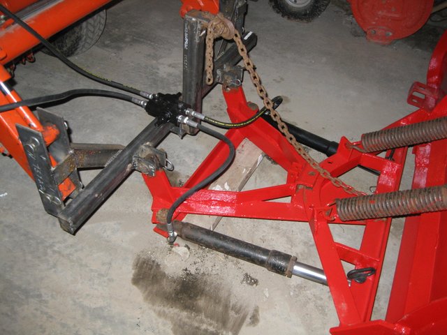

I installed the hydraulics last night. The 2-foot hoses to the cylinders seem a little short. I've ordered some 3-foot hoses to replace them. Works good.
Note the cushion valve to provide extra protection against non-symmetrical forces applied to the plow.
I also had to replace one of the cylinders because it had a connector broken off and I could not get the rest out of the hole. I'm still thinking about drilling it out and trying to re-thread the hole. But that's something I've never done before so I'm a little leery.
The mount is not painted because I'm probably going to try and move the connection points back 12 inches. I'm still trying to decide how to do that.
