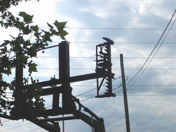

thei is what im doing to a sickelbar mower to cut back shrubs from my track

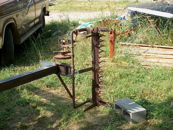

another view

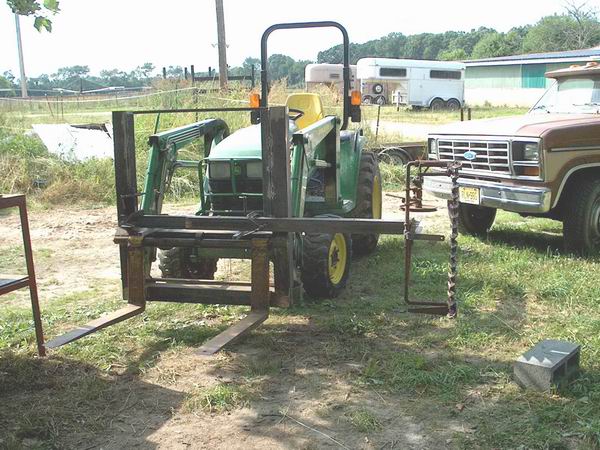

another view
it will be driven by a hydraulic motor working of the power beyond i just installed

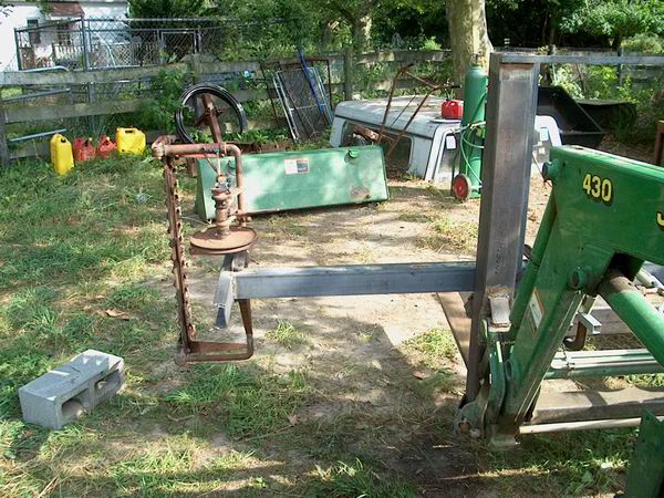

one more view

very nice, great idea to put it on the FEL /forums/images/graemlins/laugh.gif
doubt the power company gunna be to thrilled if you cut them cables though /forums/images/graemlins/grin.gif /forums/images/graemlins/grin.gif
   / new side ways trimmer #6
Chickenman,
Great idea! I could use that along my gnarly fence row.
I have 1200 feet of pond levees that have weeds along the edge. Brush hog can't get them, too darn much to use a weed eater on. I need to figure out a nice solution like you did. Maybe clamp a 2 stroke powered hedge trimmer to my FEL and let 'er rip!
   / new side ways trimmer #7
Sure would like a set of plans for that set-up ............ /forums/images/graemlins/wink.gif
   / new side ways trimmer #8
Thats great!!! I was thinking of mounting an old push mower deck with a horizontal engine on my loader to trim the trees along our driveway just today.
