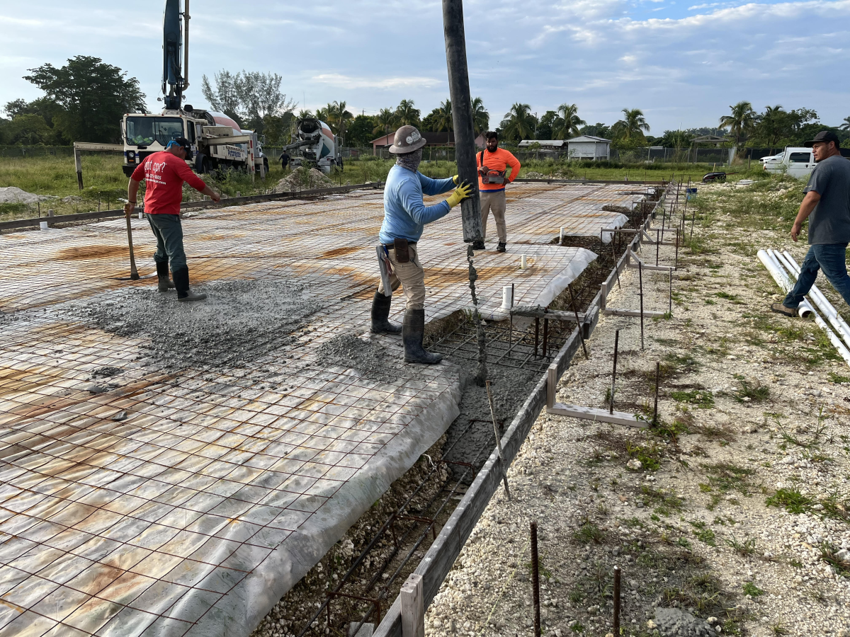

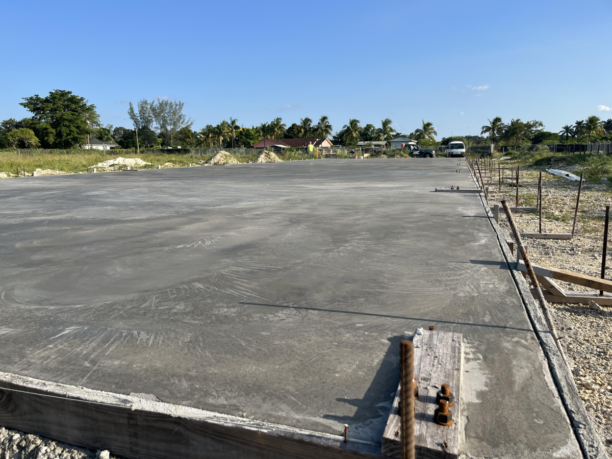

They can't be real time, joints are already cut when the pour pix were yesterday, and the concrete is dry. I kept my concrete wet for a week during cure.
Still, looking forward to seeing more pictures.

Cool your jets boys,
I just had knee surgery, so there are some delayed photos, I can barely walk around.
We did keep it wet for a few days during the curing process.
It came out looking like a mirror finish, as soon as I can hobble around I will post more pictures.
We used 4000lb mud w/ fiber mixed in.
The white swirls you see are the powder from the sawing cuts mixed w/ water.

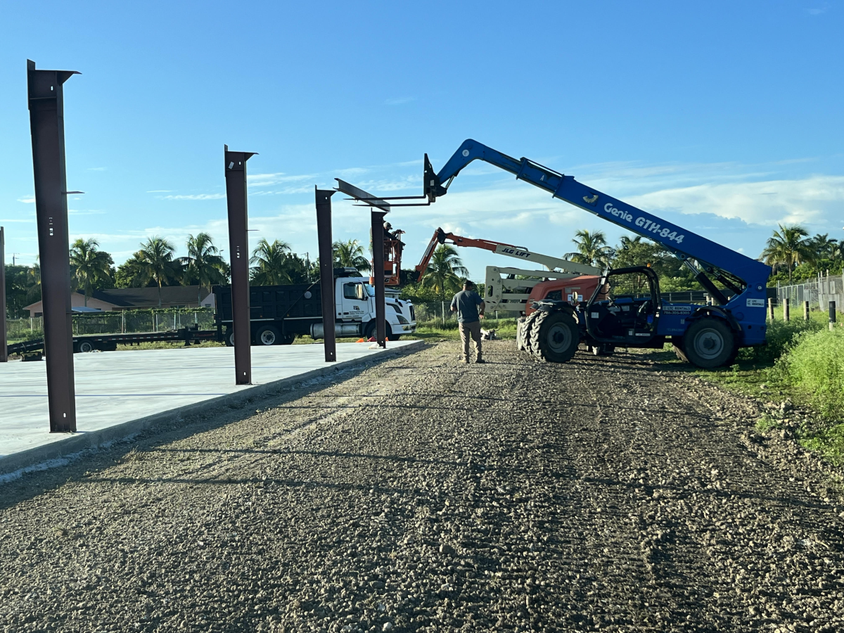

#25
Moving right along, we had to clean up around the perimeter with the cat so that the lifts could get in and for safety's sake.
Plus it makes it a lot cleaner.
Underneath each beam the concrete is 30" deep and 4'x4' wide.

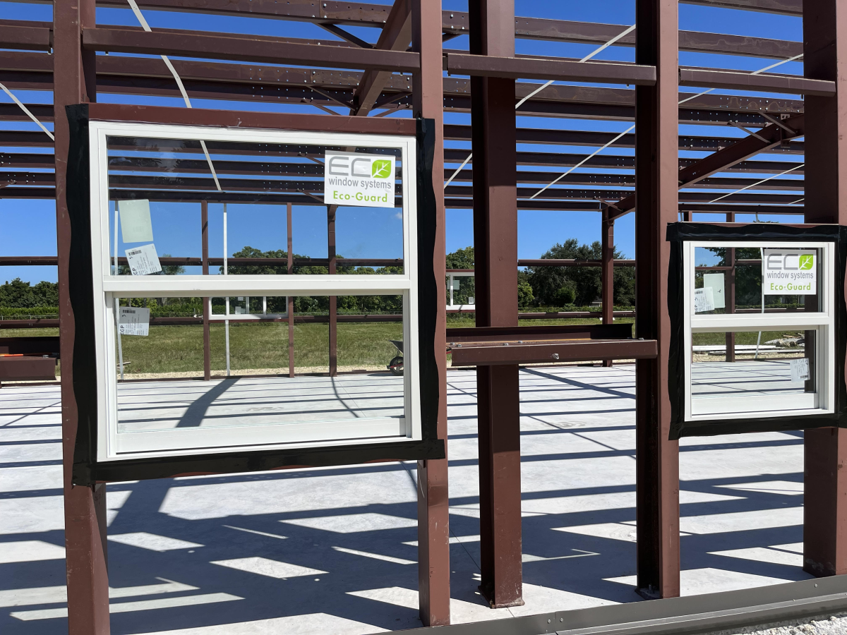

#38
hurricane impact windows installed
