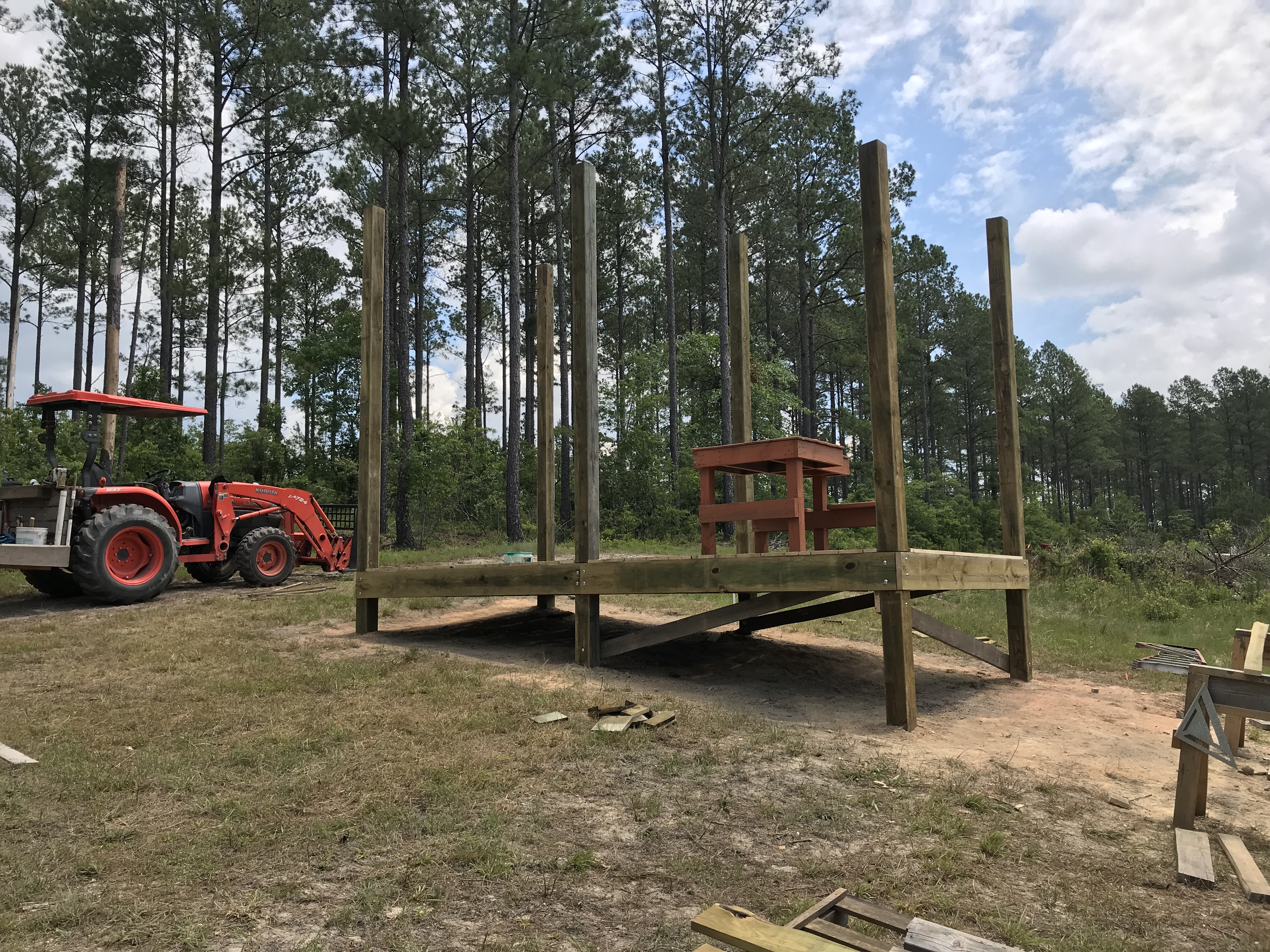

Interesting, I would never build with the joists outboard of the posts! All my joists get hangars , rafters get hurricane ties (need em here). All my exterior nail gun nails are galvanized AND clipped headed, they work just perfect. Your code does seem a bit ridiculous!! Glad I don't live in NY I guess, but with your gun laws that wouldn't be an option anyway!:D
I used to reside (didn't consider it living) in colorado the county I was in had some ridiculous codes also, most were aimed at squeezing money out of people though.
Funny enough, we also have to have H3 hurricane clips on all rafters here. Our gun laws aren't that bad despite our Governor's hard efforts. His "safe act" that he signed at 1 in the morning thinking no one would notice, was repealed because of many many flaws. One being it made all police service pistols illegal! Not well thought out at all. I have no issue doing full background checks, our pistol permit process is a p.i.t.a. but I'd rather keep pistols out of the hands of those who shouldn't have them. Our county requires you meet in person with a judge when applying, it wasn't that bad, took 5 minutes. The biggest pain up here is all nearby states require separate permits, my NY permit is not good in any other state and all aren't good here. So if I wanted to carry out of state to go to somewhere like say.. South Carolina, I'd need like 5 state permits 'til I got South of the Mason Dixon line, then permits seem to be accepted in more states.

I like it. I'm looking forward to seeing how you do the roof!!
HAHA!! That's funny... I'm looking forward to seeing how I do the roof too!!
So if you look at this picture, the left side posts,4 of them, side closer to the ground, will sport a deer blind on top.. at least thats the plan.. So I'll have a roof on that and planning to have a lower roof on the other end to try to control afternoon sun.
   / New shooting deck #36
That's very ambitious. Now I'm even more excited to see what you do!!!
   / New shooting deck #37
If at all possible I would consider leaving some open space above the main shooting bench etc...just so the noise is not so bad...even with "ears" on it can still be bothersome the more enclosed it is...
Hmmm , Makes sense, I'll have to explore what I can do..
   / New shooting deck #40
Or maybe get something soft under the roof so the sound doesn't bounce off as much. Insulation, old carpet/rug, bags of sawdust from your Mill, anything to absorb some noise?
