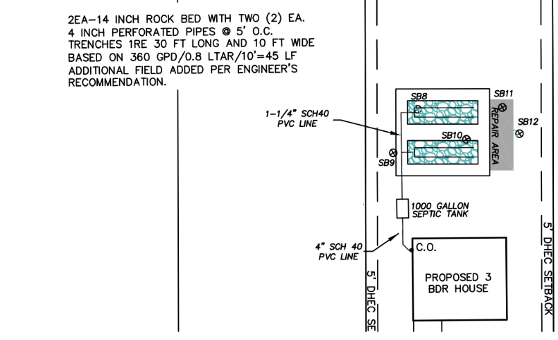

Two things stand out. 1) my original comment above about getting below the clay. I'll follow up and say a perk test would be valuable at this point. 2) my spider senses were way up when I read 30' of leach line. That seems way to short. A typical 3/2 house with typical soil needs 150'-200' of leach line. You are way under 100'. Adding between the two existing lines doesn't add much. Their is a space requirement between lines- both for evaporation and leaching.
I looked at the as-built again. Here is a snippet:
According to this, we had 4x 30' drain lines originally. These were placed in 10' wide rock beds. So that would be about 120'
The area between the two rock beds is what was dug up, and an additional 30' added, with a significantly thicker layer of rock than the existing 10' beds had. This was done to get through the organics layer. Although, because the trench filled with water so fast, who knows if they fully got through the organics layer.
We are in a very low spot in the country, and the soil here is typically sandy/loamy, with some clay mixed in. Even the drainage ditches will hold water for a couple days after a storm. But our house has the advantage of being built up on 2-3' of heavy sand fill. We have neighbors on either side that are not built up, older homes, and their septic system is working fine. I do not know how much drain line they have overall.
Thanks for all the posts and information!!
-Joe
Ok that makes more sense. An "as built" is a drawing of something that is existing. I'm guessing that drawing is the drawing of the repair?
Leach fields are required to have 100% replacement areas. That may end up in that area. If the soil layering is consistent with the neighbors and you brought in 2-3' of nice sand I'm guessing the leach lines will need to be about 6' deep. A test pit can be dug to verify the soil layering. A perk test down at the leach line depth would help too. If it was perked the test was done on that top layer which isn't your reality.
That drawing is what was done when the system was originally designed. It does not include the new "repair" line, which is located between the two rock beds shown in that drawing. I asked for a new as-built and asked if it was submitted to the county. The engineer said that they don't generate an as-built for repairs and there is no need to submit anything. Is that normal?
The septic installer just showed up and took pictures. They suggested the same thing to me that they originally did, months ago!! "Bring a couple loads of dirt in to cover the low spots and get some grass growing...hopefully that will tighten everything up and it will work fine". This to me, seems like total crap. There is 12" of soil over the rock at the area of the current blow-out, bringing that up to 15-16" is just going to ensure that the next time the system blows out, it will be in a different area (the new low point in the system, wherever that may be).
