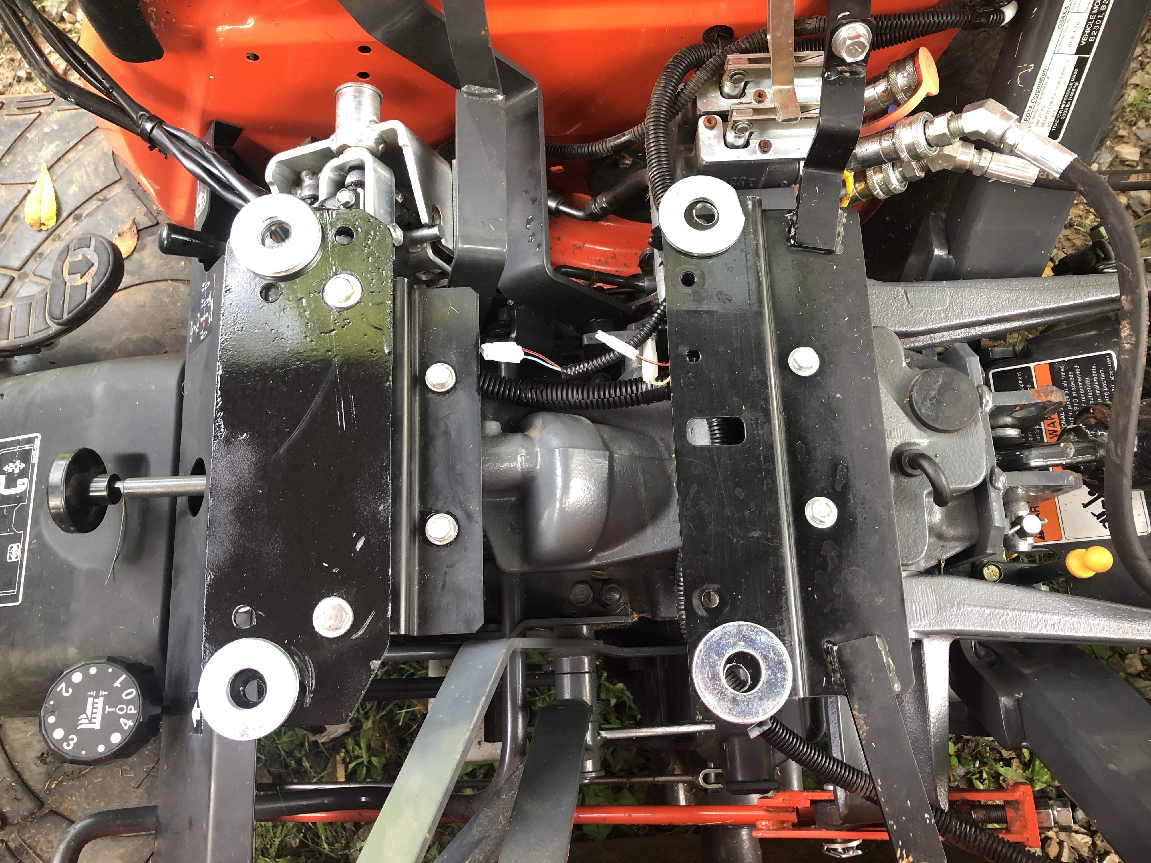

The seat came quickly and weighs in at 80 lbs. Its a substantial piece of kit! the stock seat came out easily enough. Its just two brackets bolted to the tractor.
As always not a single bolt and hole form the old lined up with the new. I retained the stock brackets because they lined up with the threaded holes in the tractor and gave a level mounting area. The rear bracket only needed to have two holes elongated to line up with the sliders in the new seat.
The forward bracket needed a plate fabricated to get from the brackets connection to the new seat's mounting holes. No problem, scrap piece of steel lying around, drilled some holes. Its not pretty and took a couple of tries from some mismeasuring but its hidden by the suspension skirt. No big deal. Gave the plate some primer and black paint. The longest part of the install was waiting for the paint to dry.
The only interference issue was the PTO engagement lever was just scraping the side of the new seat sliders. A Couple of washers between the brackets and the seat solved that. I also could have ground a little half circle into the lever edge.
The initial concern about the seat being too high was increased because I reused the original brackets which brought the mounting base up then added additional thick washers to clear the PTO lever. Even with that the seat height is just fine. At rest with the seat in its lowest setting its at about 12" above base, so about 2" higher than before. With me in the seat it settles right down to 10", same height as before. With the suspension travel (of which the stock seat had none) I move up and down from about 2" below stock seat height to about 2" above when really hitting the bumps. That's with the seat set at its lowest setting. Going to the higher settings still feels good. With the original seat I kept the tilt steering wheel at its lowest setting, with the new seat I keep it at the lowest with the lowest setting of the seat, with the higher settings I put the wheel in the middle of its tilt.
