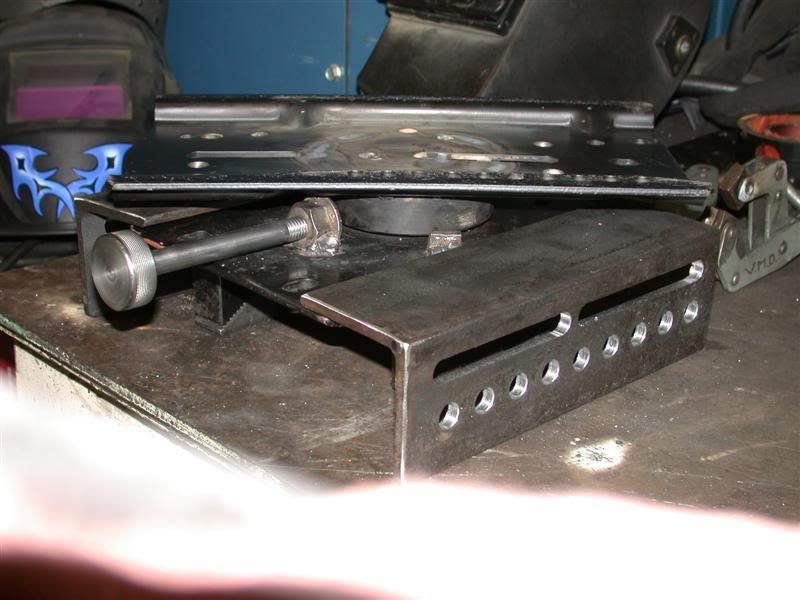

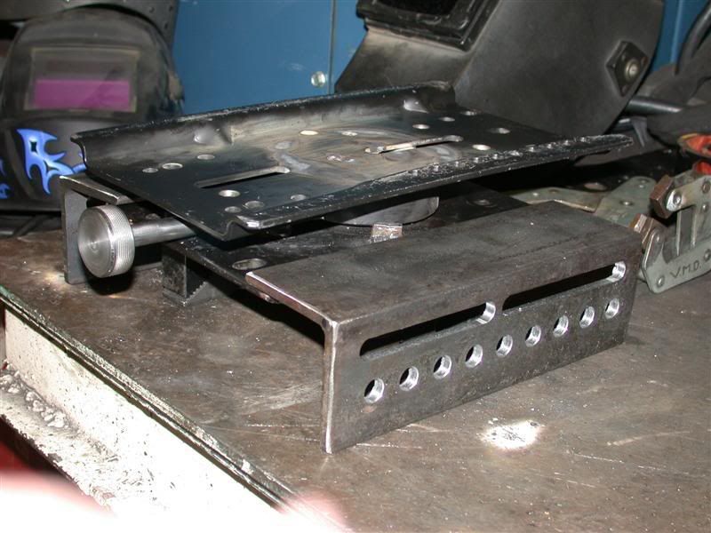

The Deger plate is upside down in those other photos, of course. When the bearings are in it, it will sit on top of the bottom plate like this. Here it is locked forward.
The bottom plate will sit anywhere from 1/2" to 1-1/2" above the hydraulic box, depending which row I use.
Here it is in the unlocked position, where it can swivel from side to side like I was talking about doing.
Now the seat will do everything I want, being able to pivot side to side, lock in a forward position, scoot front and back and also up and down. Lots of adjustments built into this arrangement. I think it would be good for fat or skinny guys, tall or short. I will paint the parts after I weld the side brackets on and after I press the bearings back together at camp. It should be cool....the seat that is. I just read it was 104° in Three Rivers yesterday.

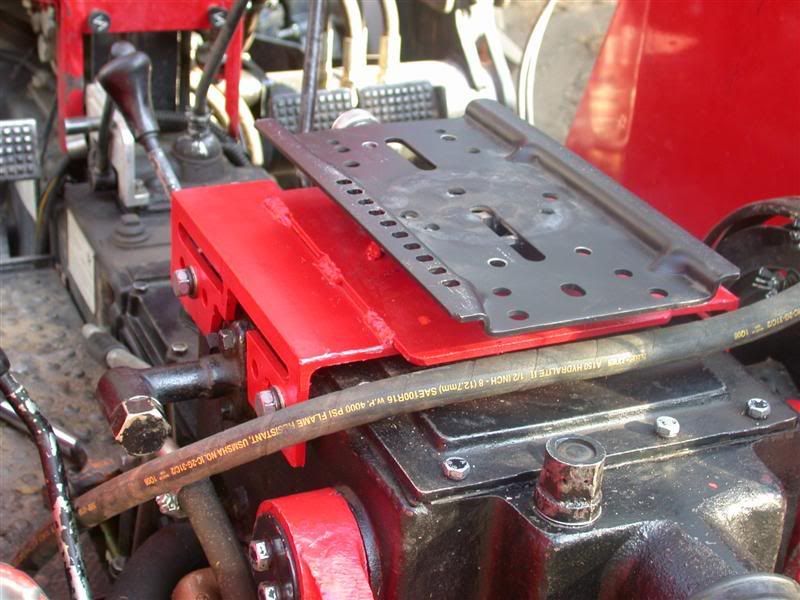

I only had one day at camp to put the seat on and change over my OEM suction strainer to a new spin-on one from Norhtern so I had to hustle.
First thing was to fit the side brackets to the hydraulic box. I had to make some cut-outs for it to fit. Then bolt them on and put the base on top of that so I could tack weld the the two together. Then I took it all off to finish welding and paint it. The base is what came off Ken's seat.
This is what the base and side brackets look like now.
Next was to assemble and grease the ball bearings for the pivot feature. I bolted the top and bottom together with the big retainer washer I made so it would not come apart. The retainer has enough clearance to allow pivoting.
then I put that assembly on the tractor.

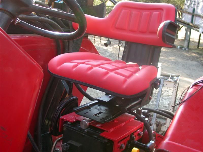

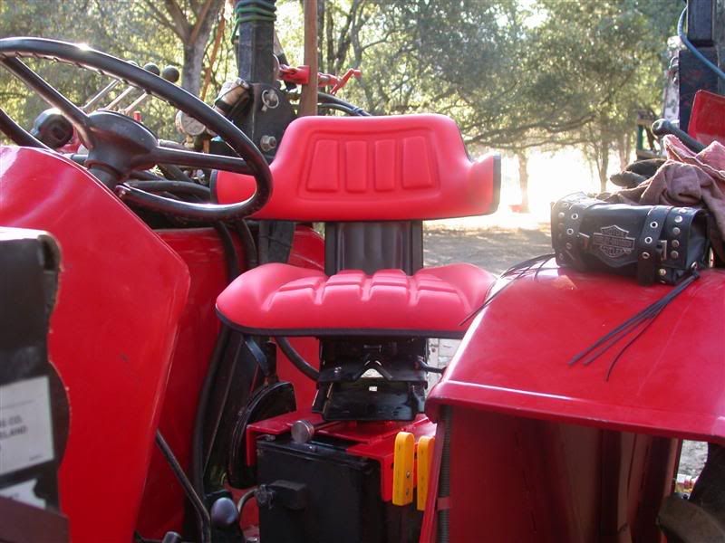

The top is what goes into the slots on the seat, which is the sliding back and forth adjustment. In fitting the seat, I wanted to make sure there is enough room in either direction. It is now done and on the tractor. The view is great, the seat is comfortable and I am happy.
Thanks for looking.

I'm glad you found this thread informative and sort of a product review. For the price, it sure is worth it me.
I will make one suggestion, and might do the same to mine. I found the this seat lets you sit "deeper" into it. So it feels like the front of the seat is up against the underside of your knees or thighs more, or that you are slightly tilted back more... at least from my old seat. You might want to shim up the rear a little higher than the front for that reason. I have to put a few more hours on it to be sure though, and can adjust the side brackets to to that. But when you get yours, be sure to check for that. I'm pretty sure you won't be disappointed because it's very comfy.

BTW, I was worried about the arm rests too, but because the seat swivels they are ok. So they get out of the way for entry and exit.
