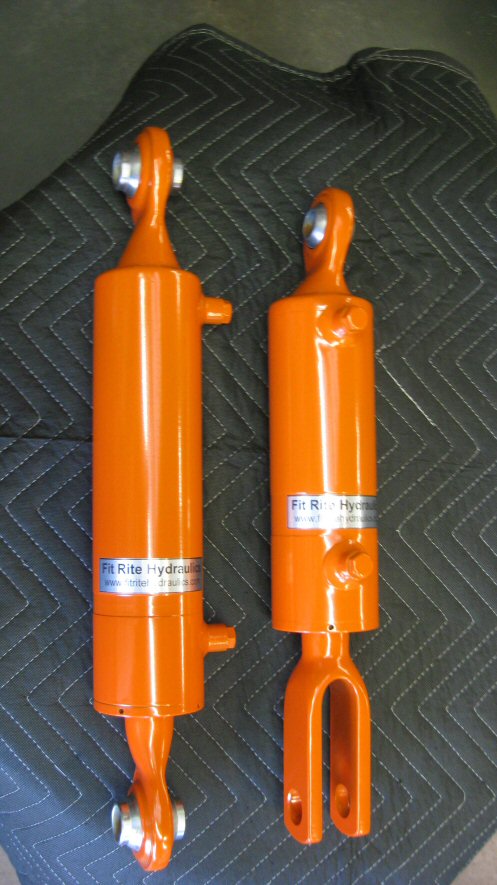

New guy here! Supposed to get a new RX7320PC delivered this week. Been waiting quite a while for something bigger with a loader! Coming from an 8N and a WD so this will be quite a change. I'm assuming it will pull an 8 foot box blade just fine? But should I go with a 7 foot just to stay closer to width of tractor? Not many hills here so I don't expect to set the tires wider or anything. I have a small pond to get rid of and turn into a horse riding arena for my wife. After that it would be used for maintenance of arena, general pasture gulley maintenance, driveway maintenance (infrequent), or just as ballast for loader. No real woods to go through with it. We'll probably pick up an arena specific implement at some point. Probably going with 7 foot, but wanted to check in. Thanks in advance!

I would not go with an 8 footer. Either an 84" or 88" unit as heavy as you can afford. Do you plan on getting hydraulic actuated rippers?
If you plan on doing a lot of grading, I highly recommend a top & tilt set as pictured for the 3pt hitch. It sure makes adjustments easy and can be made while moving vs having to stop the tractor, get off and manually make them each time. That gets old real quick.

I agree with Brian on size. Yes, your RX would handle an 8 ft BB just fine, but that is a very wide BB that would significantly affect your maneuverability, as compared to a 7 footer. Especially if you'll be using it for ballast during all your loader work, but also when just doing routine grading and maintenance. I think you'd be much happier with a medium to heavy duty 7 footer, 750 lbs or heavier.
Have you ordered rear remotes with your RX? I think you're really going to want two sets, so you can have top 'n tilt cylinders with whatever BB you end up with.

I was thinking the 7 foot was the way to go, for sure now. Ordered it with all three remotes, and planning on the top and tilt. Looking at a box blade that's in the upper 800 lb range, so that's good. No hydraulic rippers, saving that for a future welding/hydraulic project on whatever I end up with. Supposed to get it Thursday or Friday, but we'll see how the weather and roads are.

Boxblade wise, a hydraulic toplink is very cool to use. I wouldn't bother with a hydraulic side link because unless it has a provision for pivoting where it connects to the lower three-point, when used it will torque itself and eventually the weld will fail at the hydraulic ram. Also, in my experience, a hydraulic side link just isn't that useful unless you need to ditch stuff. Your mileage may vary.
