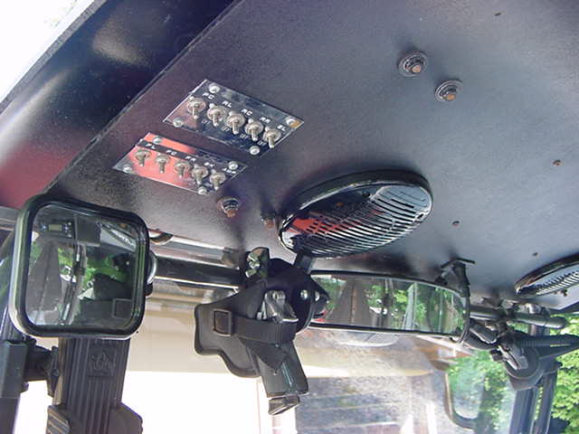

OK Fred,
Here's the first pic.
It's the grey bar below the ceiling that has the pistol, mirrors and such attached.

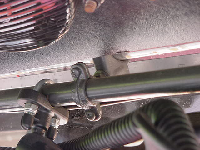

   / New RTV - Thanks For All The Advice #32
Here's the next pic.
It shows how it's mounted.
2" muffler clamp tied around the front ROPS.
A 3/4" clamp then screws onto the lower remaining threads of the muffler clamp. The steel pipe is a 4' piece of gas line pipe. Steel caps on either end. Paint it and voila! It's not as purdy as OEM stuff if you look at it real close but for the $15 invested, it was the best thing I could come up with. I got everything from Lowe's or HD.

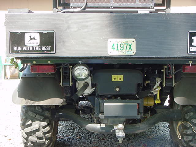

   / New RTV - Thanks For All The Advice #33
Andrew,
Took a couple pics for you as well.
This one shows the back light (just above the muffler) that I installed using the pigtail from the spreader.

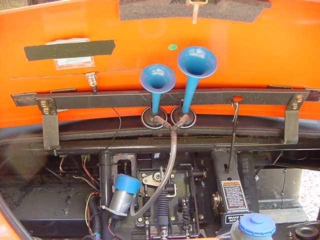

   / New RTV - Thanks For All The Advice #34
And for anyone that doesn't like the OEM horn (mine sounded pretty bad), see attached.

   / New RTV - Thanks For All The Advice #37
</font><font color="blue" class="small">( Here's the next pic.
A 3/4" clamp then screws onto the lower remaining threads of the muffler clamp. The steel pipe is a 4' piece of gas line pipe. Steel caps on either end. Paint it and voila! It's not as purdy as OEM stuff if you look at it real close but for the $15 invested, it was the best thing I could come up with. I got everything from Lowe's or HD. )</font>
Brian,
Is this the right pic? I think this is for your gun boot?

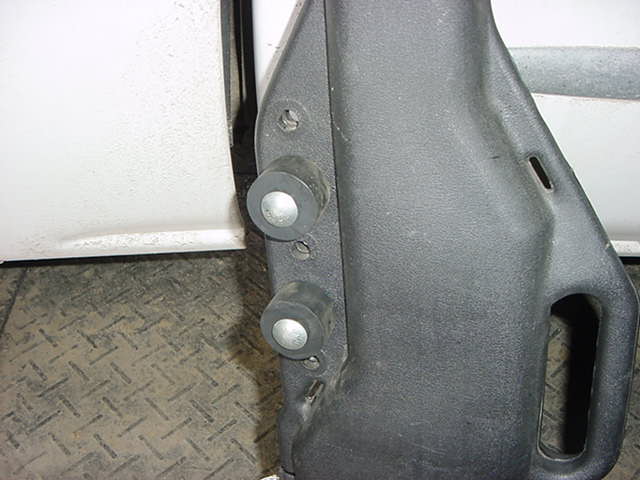

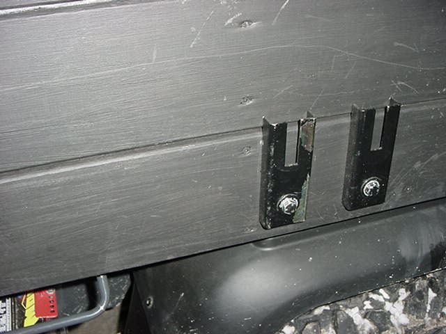

And you thought I jerry-rigged that pipe... Here's the mount I built on the side of the box for the gun mount. It's actually some heavy-duty hardware that was used to attach some large computer equipment to a pallet. Pardon the paint pealing but that coated steel they used doesn't accept paint very well.
   / New RTV - Thanks For All The Advice #40
Here's the Kolpin gun boot. The large carriage bolts fit perfectly into the grooves in the previous picture. Since the grooves are a bit long, I can change the pitch of the case.
