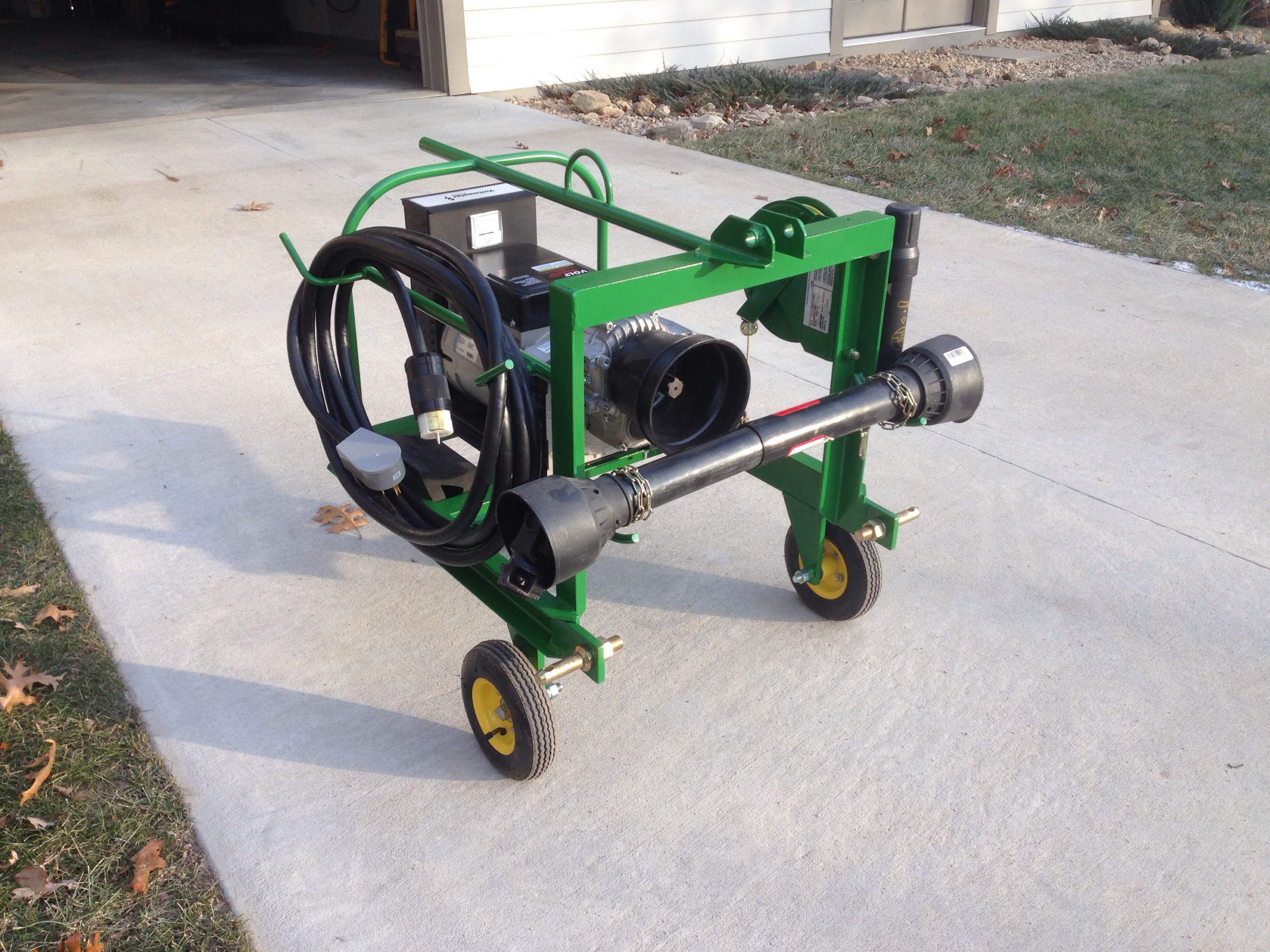

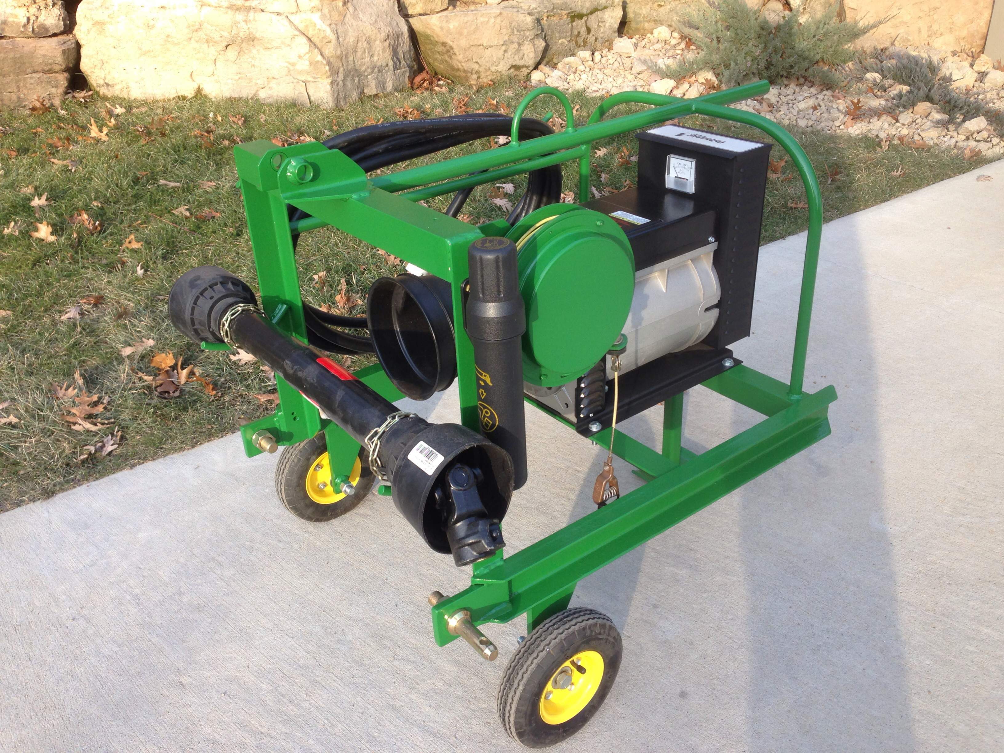

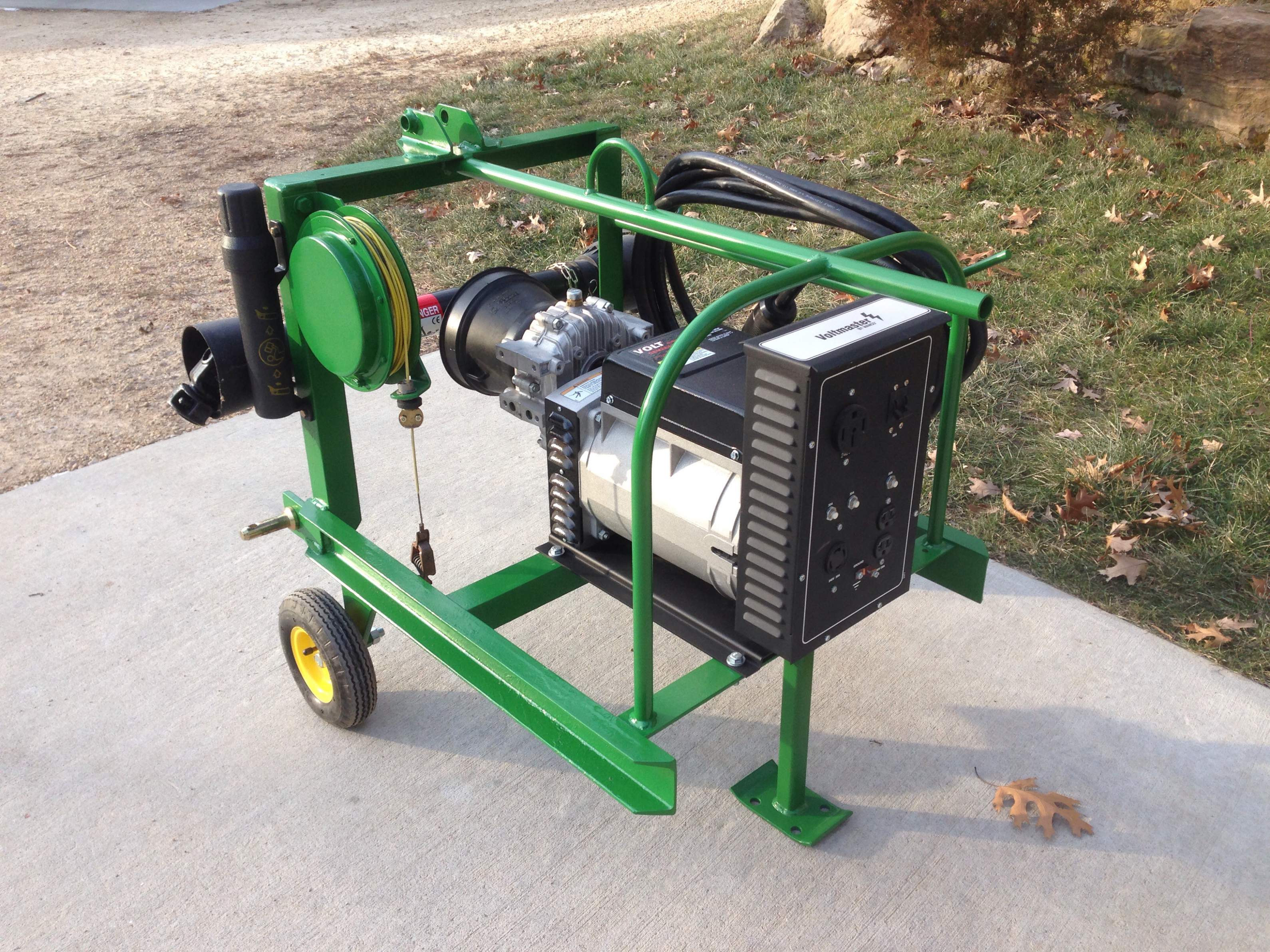

I bought the Genny last year and made most of the carrier last year but waited a year to paint it. I have finally learned to not be to quick to paint because I often want to modify things after I try them out. Genny is Voltmaster 12k. image.jpgimage.jpgimage.jpgimage.jpg

Nice setup. How many KW?
   / New PTO generator and 3pt carrier #3
Did the gearbox come with the generator, or was it sourced independently?
12 KW and yes the gear box came with the Genny.

nice job on the unit, I like your wheels to move it around when not on the tractor, and your PTO shaft storage,
I just wire brush off the burnt areas (welded areas) where the modifications took place and repaint, I like things looking some what professional when there "completed" there is usually a few weeks in there that testing is taking place, tho,
the thing is unless one spends mega dollars for paint it all looks weathered in a year or so any way, and I prefer weather faded paint over a rust bucket, look,

WOW.. IM jealous.. Im sorta, kinda want a PTO generator.. Primarily to run the well pump or water heater, i have dual EU2000 Hondas for the smaller stuff..
What make/brand is it? Where did you get it?
   / New PTO generator and 3pt carrier #9
Nice setup. I especially like the foot on your third leg. Bolt plate off a leaf spring pack, isn't it? I've recycled several for just that purpose. :D
You are correct sir.
I believe I got the Genny from Electricgeneratorsdirect.com. I needed a bit of power since I heat and cool with a 5 ton ground source heat pump. The 12 KW will run the heat pump and just about anything else I want, including the electric stove.
