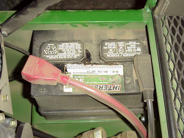

OK. The verdict is in. I finally had a chance to mow today and the temperature around the battery hit almost 225 degrees after one hour! And that’s with an ambient air temp of about 75 degrees. By the time I grabbed my camera, the temp had already dropped to about 212 degrees on the thermometer. The thermometer, as you can see in the attached pic, basically measures the air temperature around the battery, and therefore falls fast when the engine is idling. I have no idea what the actual battery temperature was but can guess it will get really high if bathed in 225 degree air for several hours.
I leave this thermometer in all the time now and will continue to measure as the summer gets hot. One thing’s for sure…I think 225 degrees is too hot for a battery.

I'm not doubting you that it is HOT in there, however, isn't that type of thermometer supposed to be vertical only? I used a metal cased meat thermometer in mine, and as I reported earlier, it didn't hit anything near that in about the same air temperature.
You definately have a heating problem there. Water boils at 212, and I don't know how potent your acid is, but I'll bet you were right in your thinking that the sucker just boiled to death after several hours of cooking back there.
I'd call Power Trac and ask them for help. That is too hot!

MR, regarding the question of the thermometer needing to be vertical…I don’t think that’s required. I think this thermometer works by having a sealed enclosure under a known pressure. As the temperature increases, the liquid (used to be mercury…think it’s alcohol these days) expands at a know rate based on the initial internal pressure. If true, I think it may even work upside-down.
Schultz, I agree that a big component of the heat problem is radiant heat. I think I may be able to solve both the air and radiant issues with some type of shield. I sure wish I knew how to use a smoke wrench as this would be a perfect project. I’ll have to think about what I can come up with to address the problem.
